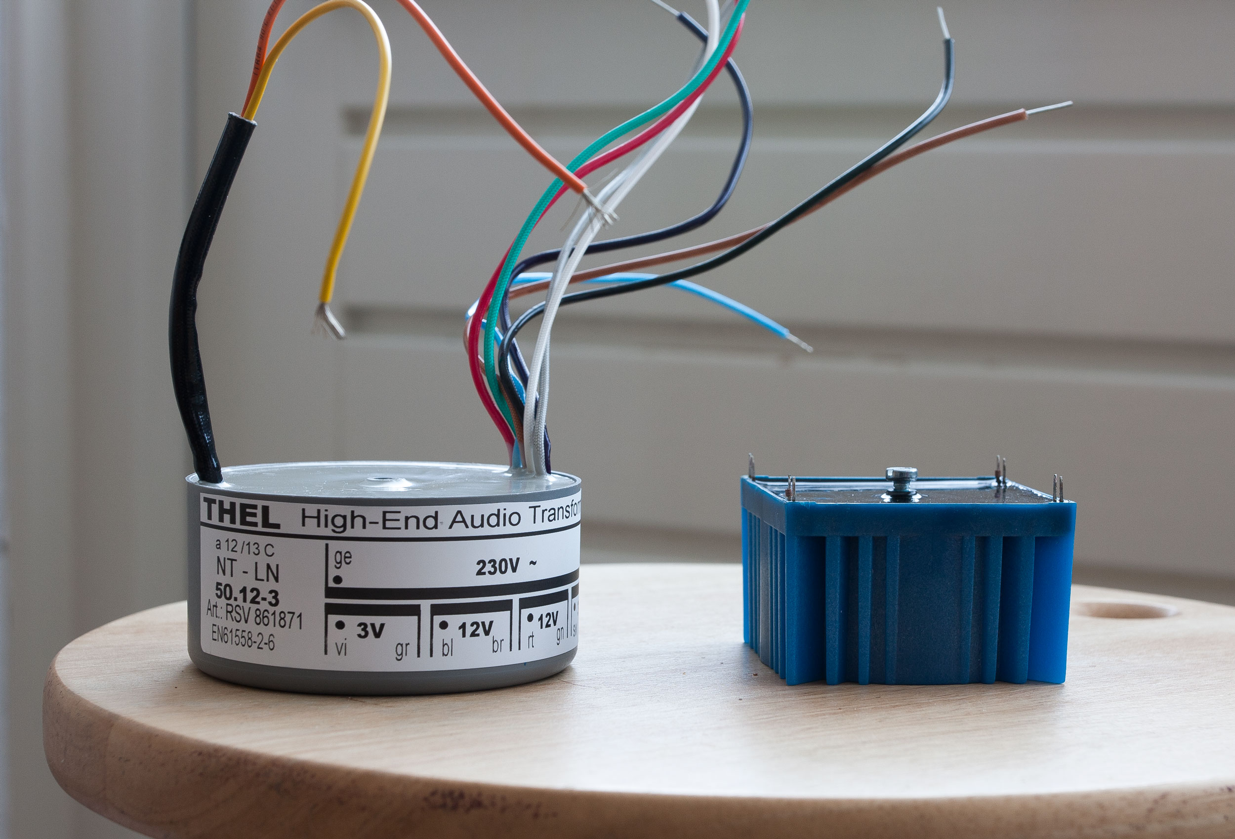

psu/transformer
I have used a transformer from Thel (germany)
12V + 3V for the 15V and 12V -3V for the 9V
Have to listen for some time, but first impression is promising.

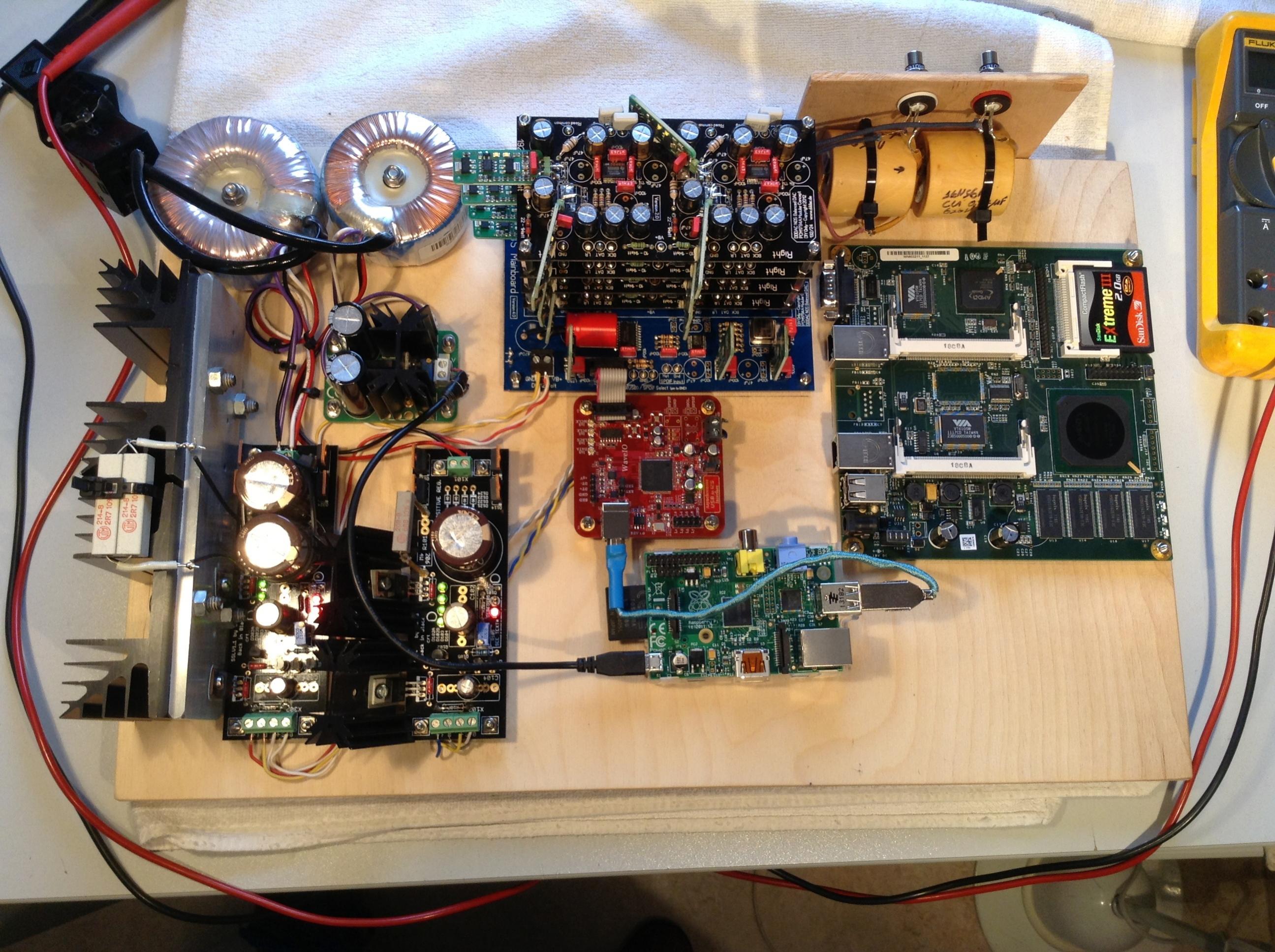

So today I soldered in the new blue board with Tent shunt regs.
I also added single ended capacitor output (parallel to the direct balanced output that I use on my amps) so I can use the dac during the next listening session at Klaus his Goto system.
The S/P diff is not connected yet, I also need to modify my cd player for sp-diff out.
The Salas shunt reg also needed some modification because the current draw is higher. The dac runs at 1,16amps now, this is the limit for the Salas reg.
On the pictures you can also see the Raspberry Pi and Alix that I use for streaming. I2S out on the Pi is something I will connect later on.
I will refrain from noting listening results, first the board needs some time to run in. First impressions however are very good, better than the old board without shunts? Yes I think so 🙄
