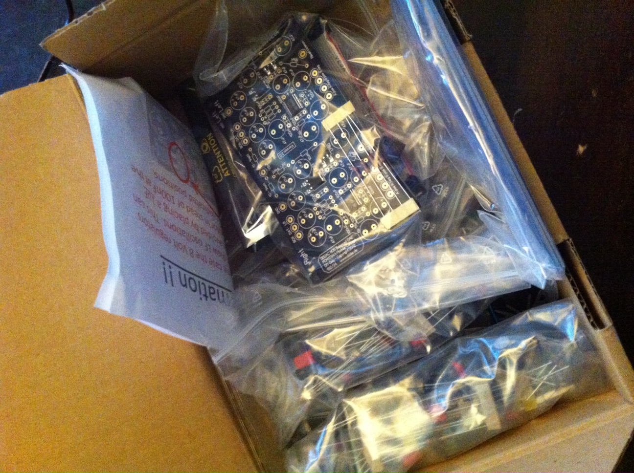

Let's D-D-Do it! Today two dac boards, two power supplies and a WaveIO arrived. Spdif board will come soon also! 😀
