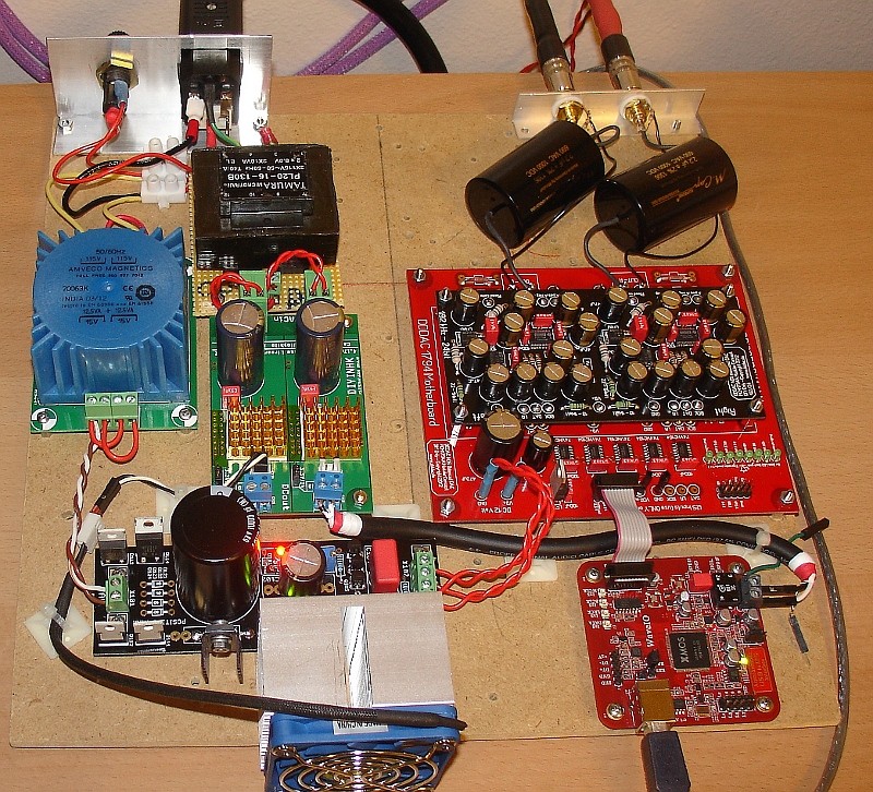

My particle board dac...
I've been listening for several days and it sounds very good. I'm still trying to figure out how to wire the Lundahl 1684 to listen with that for a while. When I setup the transformers I'll rearrange the setup to avoid running the power to the wavio perpendicular to the dac power cable and the i2s ribbon cable...

See pdf
5 is + output motherboard
2 is - output motherboard
7 is ground cinchplug
6 is hot cinchplug
On the cinch chassis plug from ground to hot you can place a resistor (rload) of 10k or more depending on the input impedance of the pre-amp.
only connect the POS and NEG dac output to the primary, regardless if you do serial or parallel. I would the latter by the way...
so NOT connect the COMMON from the DAC to any thing.... just leave it open
the secondary from the transformer goes to hot cinch and GND.
two connections input, two connections output...

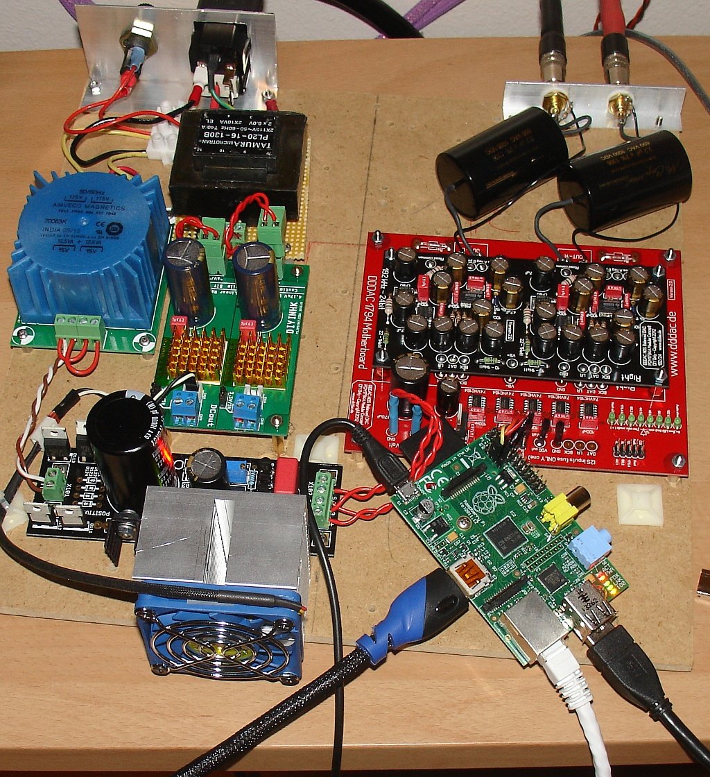

has anyone used the DDDAC in through the I2S, bypassing the USB input?
If possible I want to try it direct from either a RPi or BBB.
I believe that you can access the I2S directly from the BBB and I know of at least one application that's looking at controlling audio out of the I2S, just wondering if it's possible to do it with the DDDAC.

I'm trying that next! It should work ok I hope, will let you know soon... the pi I had was older and didn't have the header where i2s is supplied from. Just got a new one this weekend. There's community work on getting the i2s to work on the beaglebone black (which apparently already has the code for i2s written and tested, search this site for the "buffalo appliance" or for volumio or for rune) and on the udoo board.has anyone used the DDDAC in through the I2S, bypassing the USB input?

I have used the dac with a raspberry pi through the wave IO. Using the wave IO has the advantage that it isolates the, dirty, computer ground from the dac.
I would be interested in trying it directly, just to be sure of the advantage of the wave IO in between. Or maybe I will be surprised and discover that direct is better?.

pi with i2s
I got it produce sound, but it doesn't sound too good. There's some artifacts and noise in the playback.
Not knowing enough about how to do it I used Volumio 1.1, turned the i2s driver on and added snd_soc_hifiberry_dac and snd_soc_rpi_dac to /etc/modules (as suggested by a contributor to volumio.org).
I'll read some more in the next few days and see if I can find anything that can help.
I will also hook up an es9023 dac to it and see if that one plays ok. The person who made the suggestion above in volumio.org was using an es9023 dac and did not complain of noisy or distorted sound. If it plays ok it will rule out any bad connection or external noise possibilities. I'll also fix the rpi to the base and straigthen the wires so the they are not crossing/touching each other.
