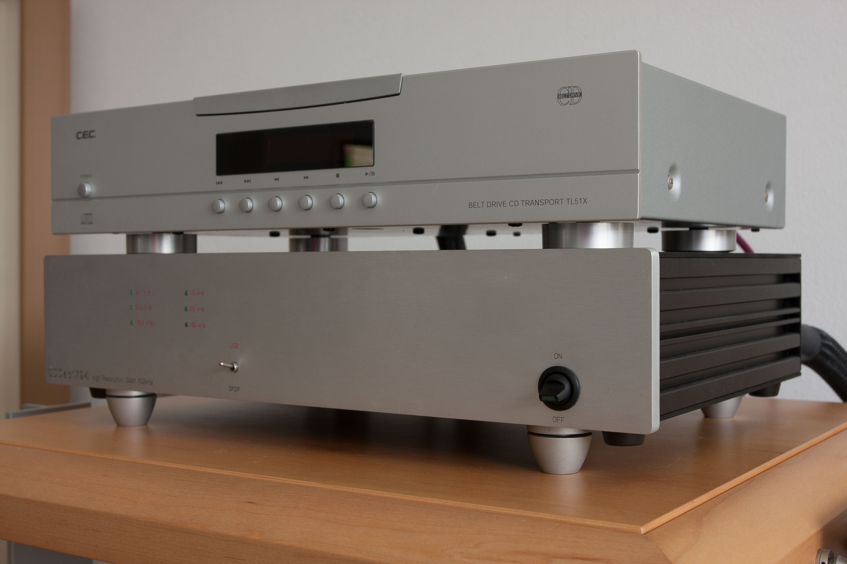

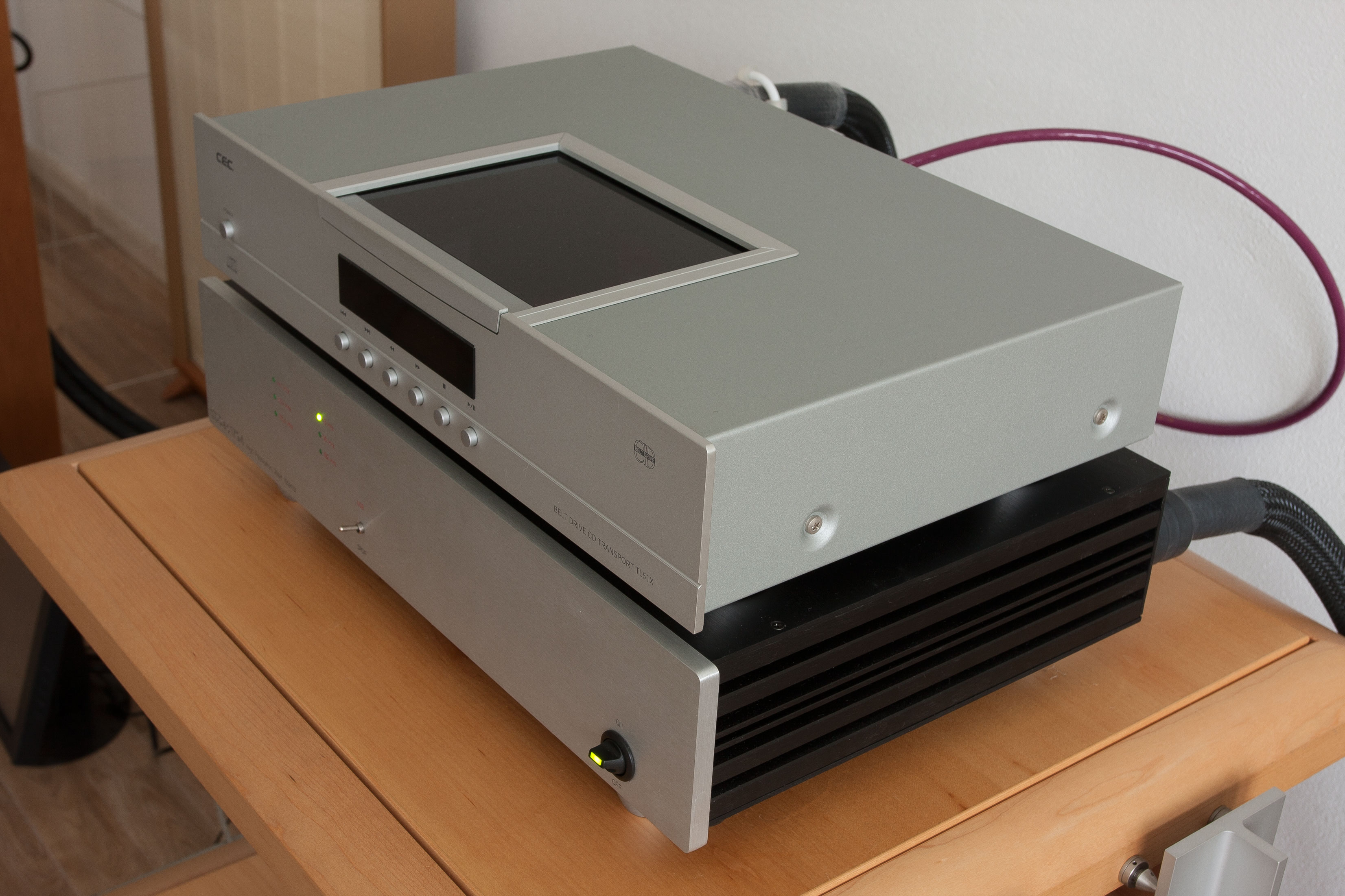

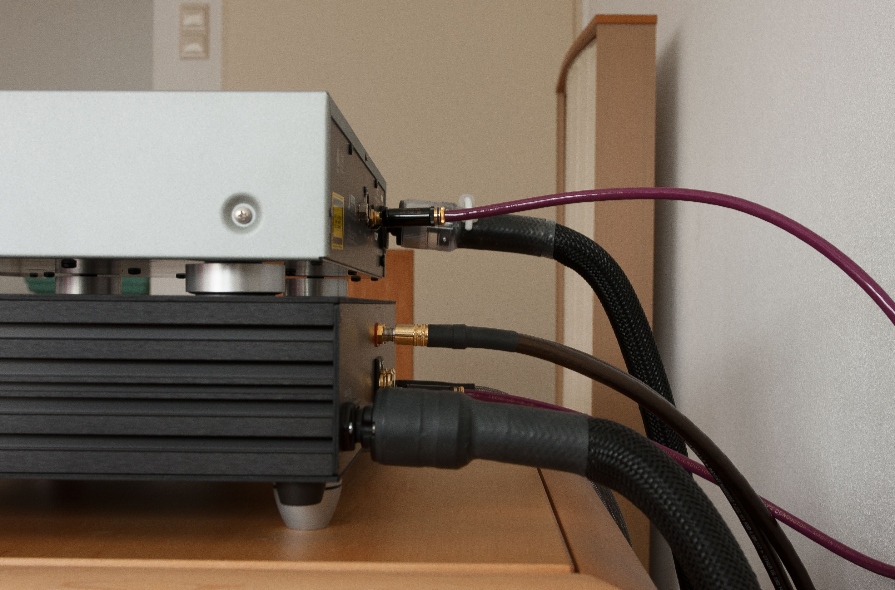

My 4 stack with Sowters has been running for a few months now and I can confirm that it does improve with settling time, stunning sound quality 🙂

How do you judge the possebility to place another 4 board stack beside the existing one and connecting them on top with longer solid leads?
To avoid interferences, it has been said in a post before that the DACs boards should be stacked alltogether. But you can turn them horizontaly instead of vertically to avoid a too high stack : when they are stacked (alltogether vertically) just turn the group 90° to place them horizontally in the chassis.
Doede seems to approve this suggestion a few pages before....
That's possible but then I will end up with longer wiring from the dacs to the motherboard. I am just wondering if it makes any difference.
Another option would be to just stack another dac chip on top of the other ones, just like the 1543 dac, and keep the 4 boards.
You need to take the extra current into consideration for the shunt regulators and maybe some other components need to be adjusted.
