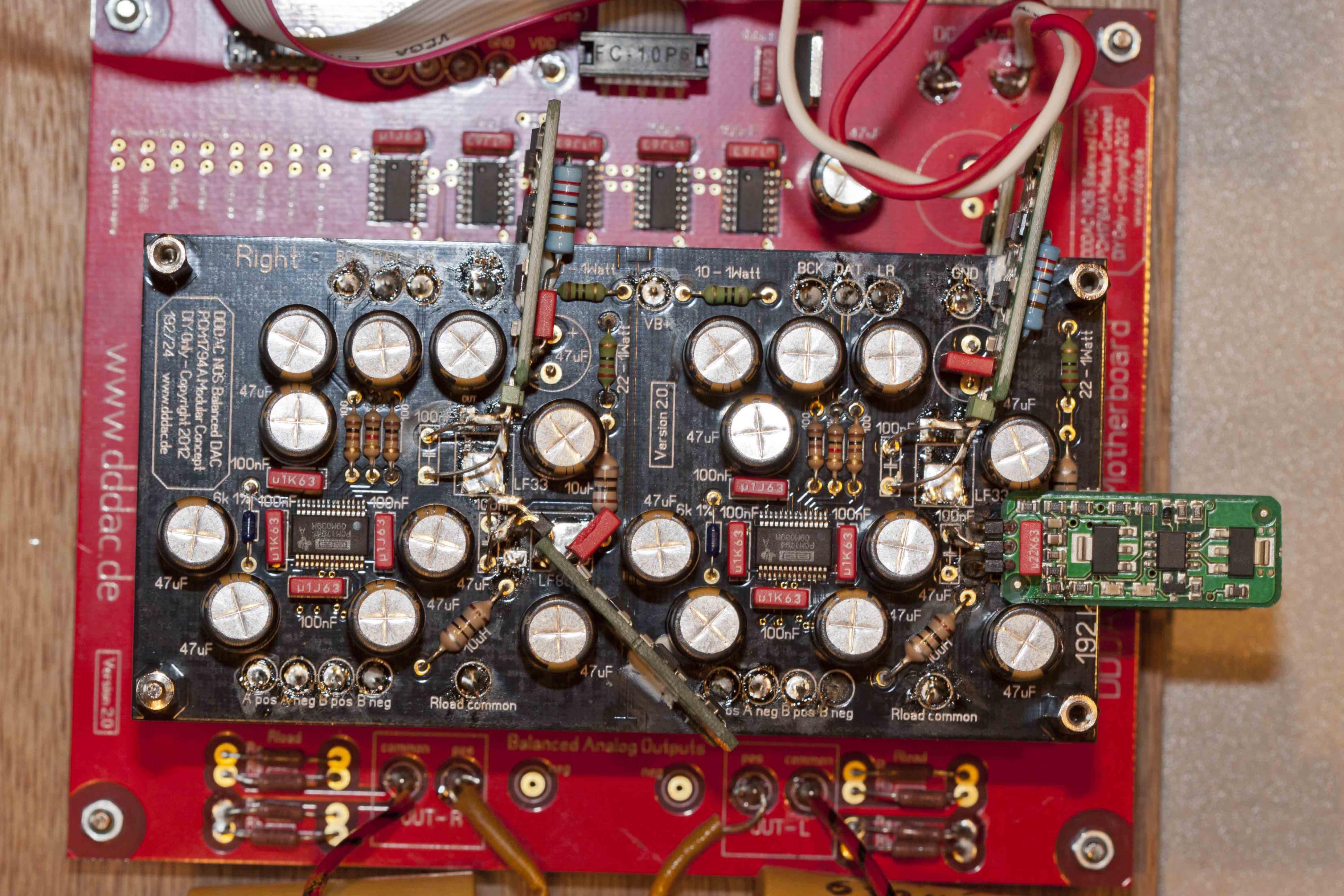

As I understand, the LF80 and LF33 are the 8.0v and 3.3v standard regulators. I would imagine the new shunt regulators are to replace these. The 3 legs of the shunt reg will be input voltage, output voltage and gnd and will be the same layout as for a standard 3 leg 7805 reg. If you look at the standard surface mounted LF regulators, you'll see that they have 2 legs presumably for voltage in and out, then the body tag at the other end is also connected to gnd. Removal of the wima caps on the board is only because there are also caps doing the same job on the shunt reg.

I used the soldering points of the pink capacitors because they are easier to solder than the SMD soldering connections of the standard regulators.
And also because these caps need to be omitted when using the shunts, also the electrolytics downstream of the regulators need to be removed. Otherwise it will deminish the effect of the shunt regulators.
You need to remove the regulators from the board, they are the black IC's with code LF80 and LF33 That come soldered on the board.

It looks like the Tent shunt lab shunt regs go into the holes of the pink caps and the third leg of the shunt reg is soldered to the place where the original regulator was, are you able to confirm as I'm struggling a wee bit , thanks

If you've removed the original RF reg, you will have 3 solder points. One large one which is gnd, then V-in and V-out.
Set your multimeter to continuity (where it beeps when there's a connection) and do some probing to work out what's what.
Hold 1 probe onto the large gnd from the original reg, then probe the 2 holes from the pink cap. This will tell you which cap hole is gnd. Then put probe 1 into the other cap hole and probe the 2other points from the original reg. The one that beeps is the V-out, the other is V-in.
Once you've worked out what's what, join the V-in to the V-in of your shunt reg, then join the gnd to either of the gnd points you've identified and join the V-out to either the original regs V-out point or the V+ of the pink cap.

So the Vin of the shunt will be soldered to the pad of the original regulator. Than Vout and ground can be soldered on the spot of the wima caps.
It is also possible to use all the pads from the original regulator but that will make a weak soldering connection so I will not advise to do so.

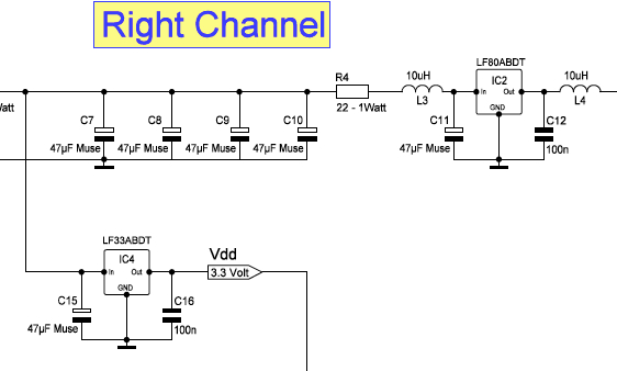

Supersurfer, you mentioned before about removing electrolytic caps if the shunt regs are being used. I've looked at your pictures which seem to show 1 of the 47uf caps removed per channel from the space where there are 4 of them together. Is this one removed just for easier fitting of the shunt regs or is this the one you mentioned to remove to make the shunt reg perform better?

That one is sacrificed to make space for the shunts. There are some caps around the dac chips that need to be removed, They are still in place on the pictures. Just follow the schematics and remove all caps between regulator and dac chip. The local wimas can stay.

The caps slow down the shunts because they interact the regulation by loading and unloading their energy.
Best is to put the shunts directly on the power input of the dac chips without anything in between.

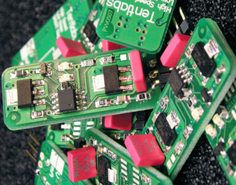

As you can see on the picture, Guido Tent also make use of a Wima cap, close to the 3 pins of his shunt regulator.
Perhaps this is a cap on the output of the shunt regulator,if so then you don't need an extra cap between shunt reg. and dac.
