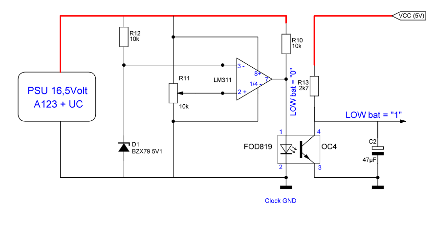

Maybe you can use a simple voltage check comparator LM311 to do it automatically ? I built something like that for my clock project with 5 A123.

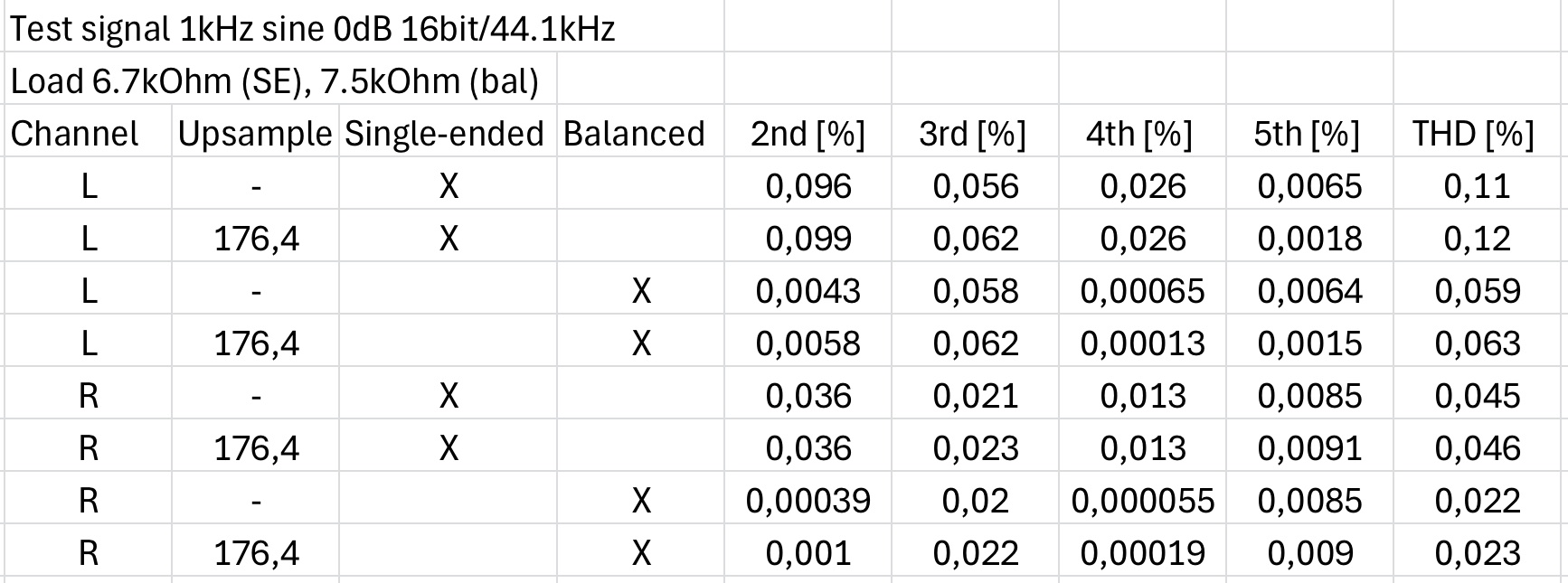

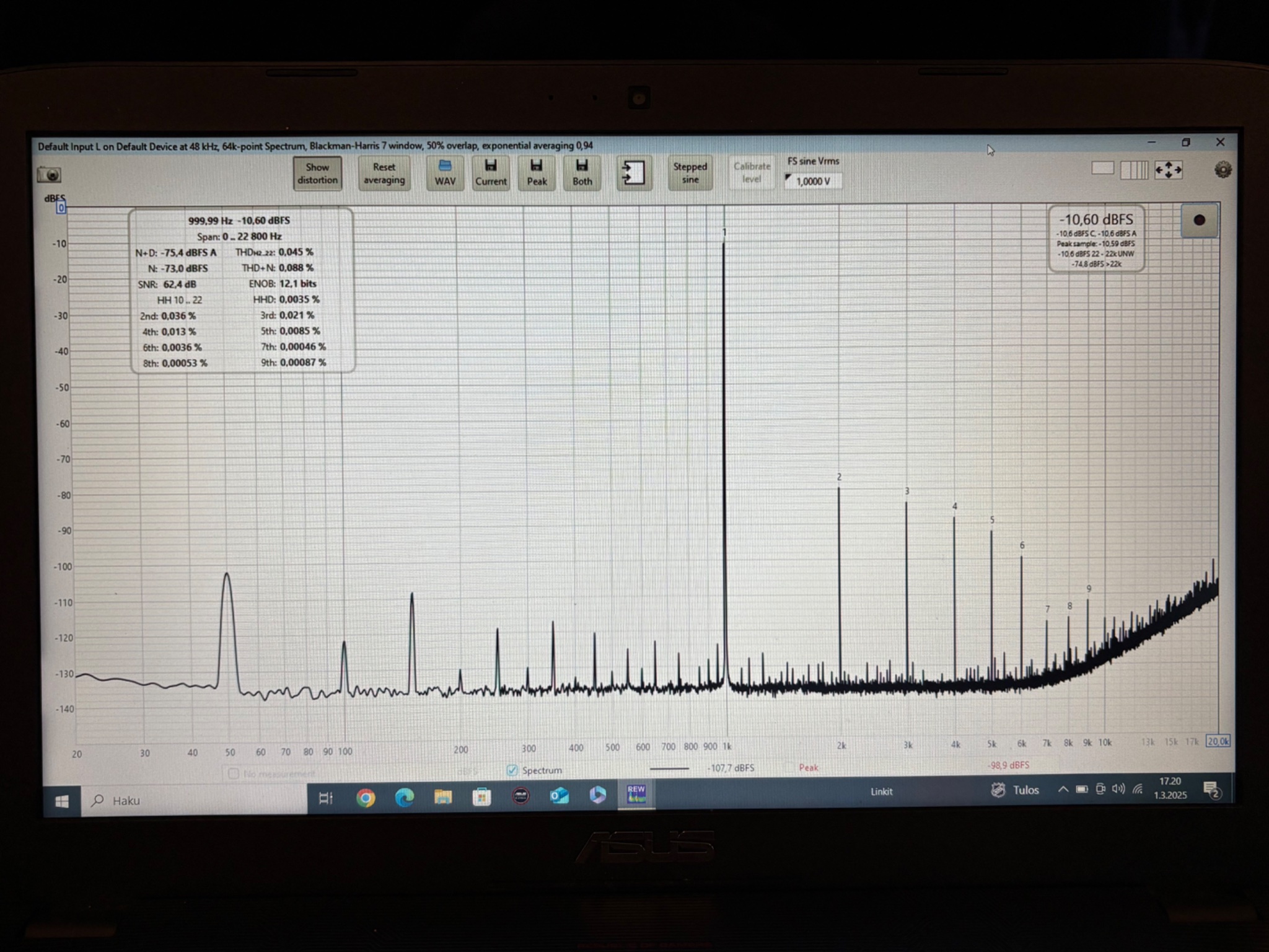

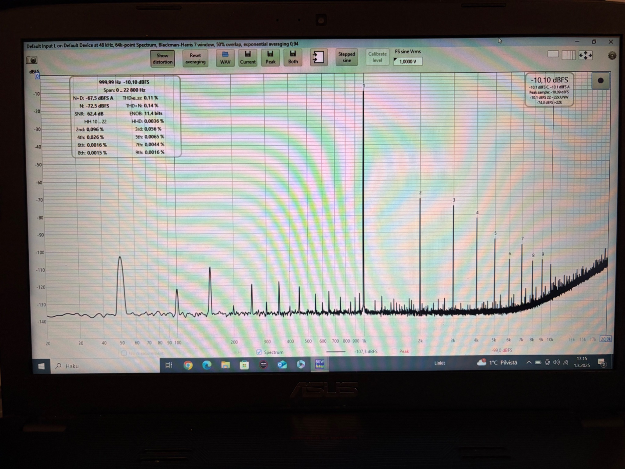

Hi Doede, I did some distortion measurements for my battery powered DDDAC using my laptop PC, REW software, Focusrite Scarlet 2i2 soundcard and a simple attenuator. I think the results are quite expectable for a NOS DAC with passive IV. Please see the attached table and also pictures of the FFT for SE measurement of the left and right channels without upsampling.
The right channel seems to be giving me much lower distortion figures and also the output is half a decibel lower than left channel. Maybe I can adjust these using the current source trimmers on the DAC boards?
Nice work Morde, the results are as expected. The small differences are part of two possible variances between left and right. First may be a small difference in the "8-Volt" output of the PCM1794. With 0dB you are very close to the possible internal headroom. And small differences between the bias current (yes, the trimmers) and differences in the value of the load resistors. Those 3 three are all pretty small but might add up in two different directions. Just for fun and curiosity, what are the DC bias voltages against the common pint of the 4 POS/NEG outputs? Also, for fun and science you could repeat the test (forget upsampling) with a -3dB, -6dB and -12 dB signal, which are more representing normal music. you will hardly ever listen to Instruments or voices with exact 0dB level ;-)

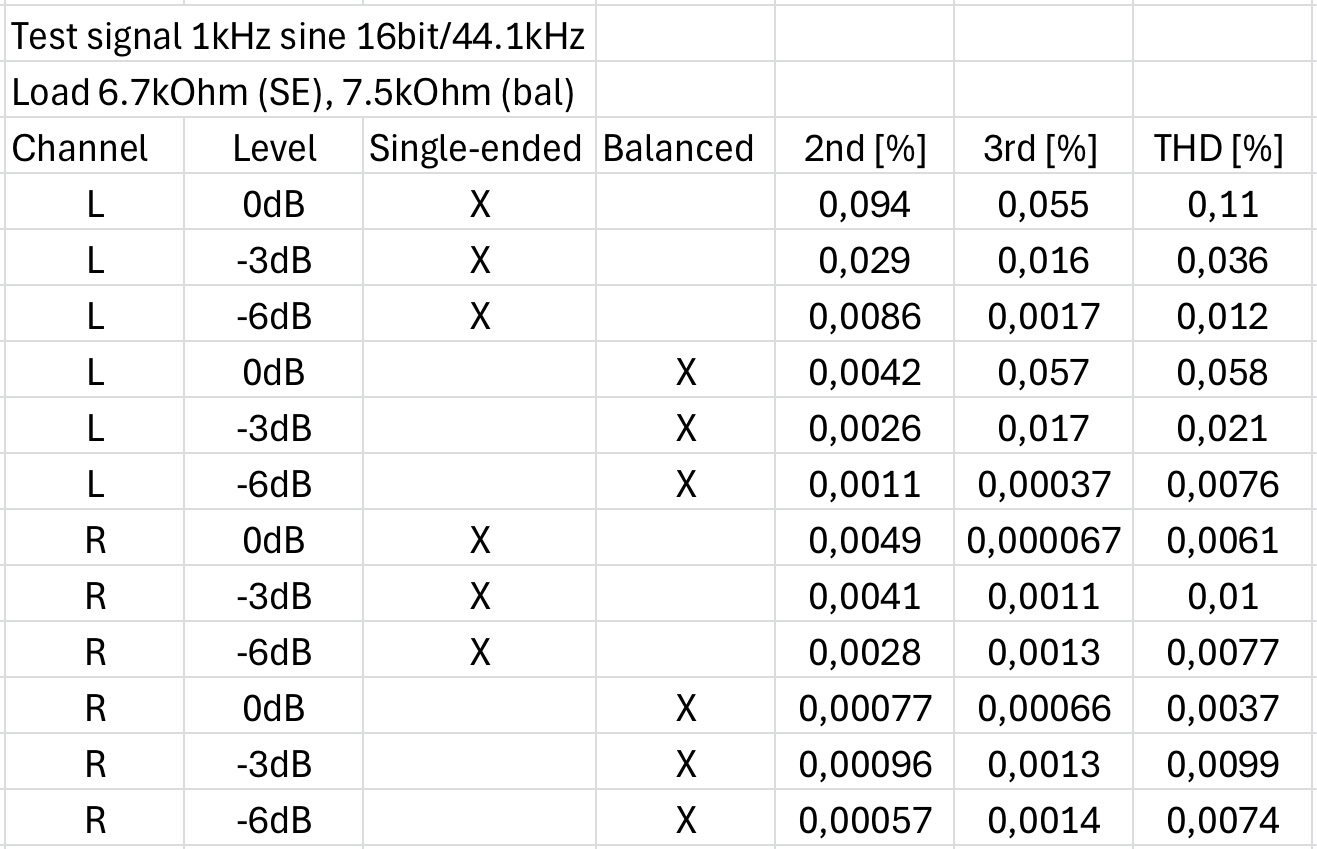

So here’s some more distortion measurements with 0dB, -3dB and -6dB signal levels. Left channel corresponds very well with the earlier measurements but the right channel gives ridiculously low figures. I can’t explain it, I did everything precisely the same as with left channel.
My soundcard is capable of measuring distortion to approx. -110dB level, so with -10dB fundamental the accuracy is about -100dB (0.001%).
The DC offset measurements against the common pin:
L+ 2.83V
L- 2.76V
R+ 2.01V
R- 2.06V
Quite big difference there, maybe I need to adjust?
O wait, there is Something Very wrong. The R channel should also have 2.8 something volt. Is this a 4 deck? That would suggest that one deck R channel is not working correctly, hence the 3/4 value. May be it is the adjustment, but you said they were all at 40mV ? Check if 8 volt is present at all decks and 40mV is real there… 100% sure the Rload are the right value? Any possibility of poor solderjoints so a part is not working correctly ?
Ha, that’s it. Something funny with the R channel bias circuit when I measured it with a DMM. At first the reading was 31mV but after I poked it a little the value jumped up to 41.4mV, while the left is 41.6mV. Now the DC offsets are for the R channel
R+ 2.77V
R- 2.77V
So, a bad connection somewhere or the trimmer is bad. Thanks for pointing this out for me!
