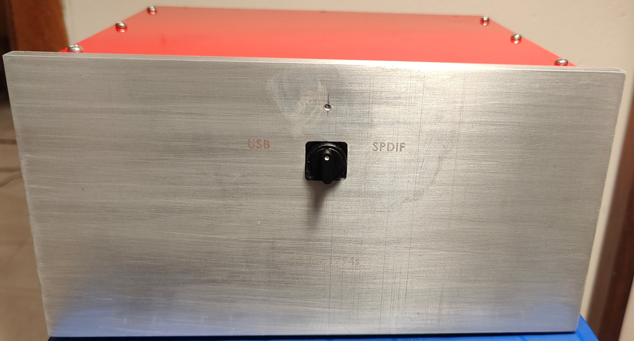

Happy to report it's up and running in full. Couldn't source a WM8804G, but discovered that a cheap raspi spdif HAT used it. So bought that board, and transplanted. Using a Sigma 11 regulator. Haven't done the spdif in, but optical in works fine (which is what I need primarily). USB works fine too.

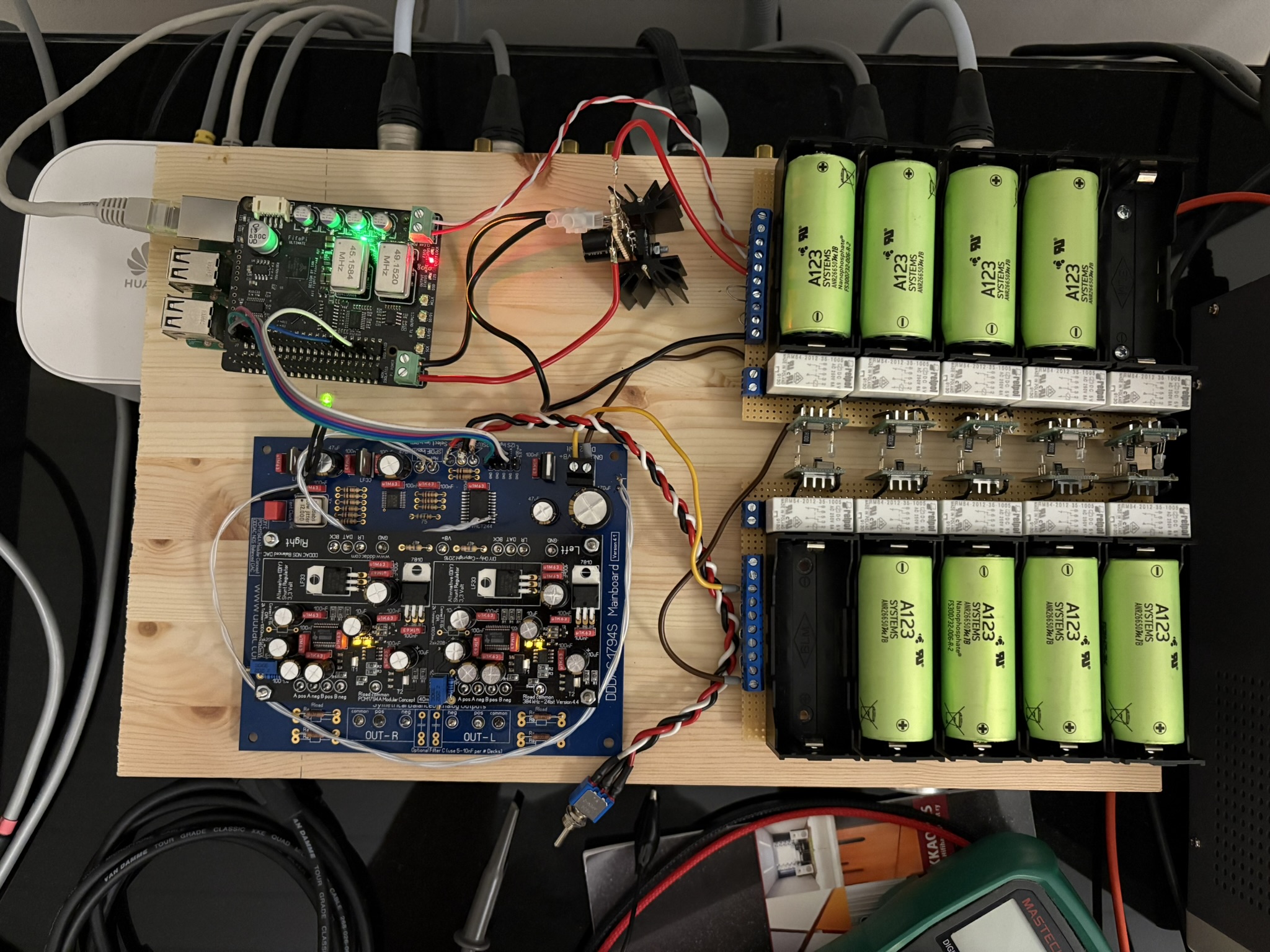

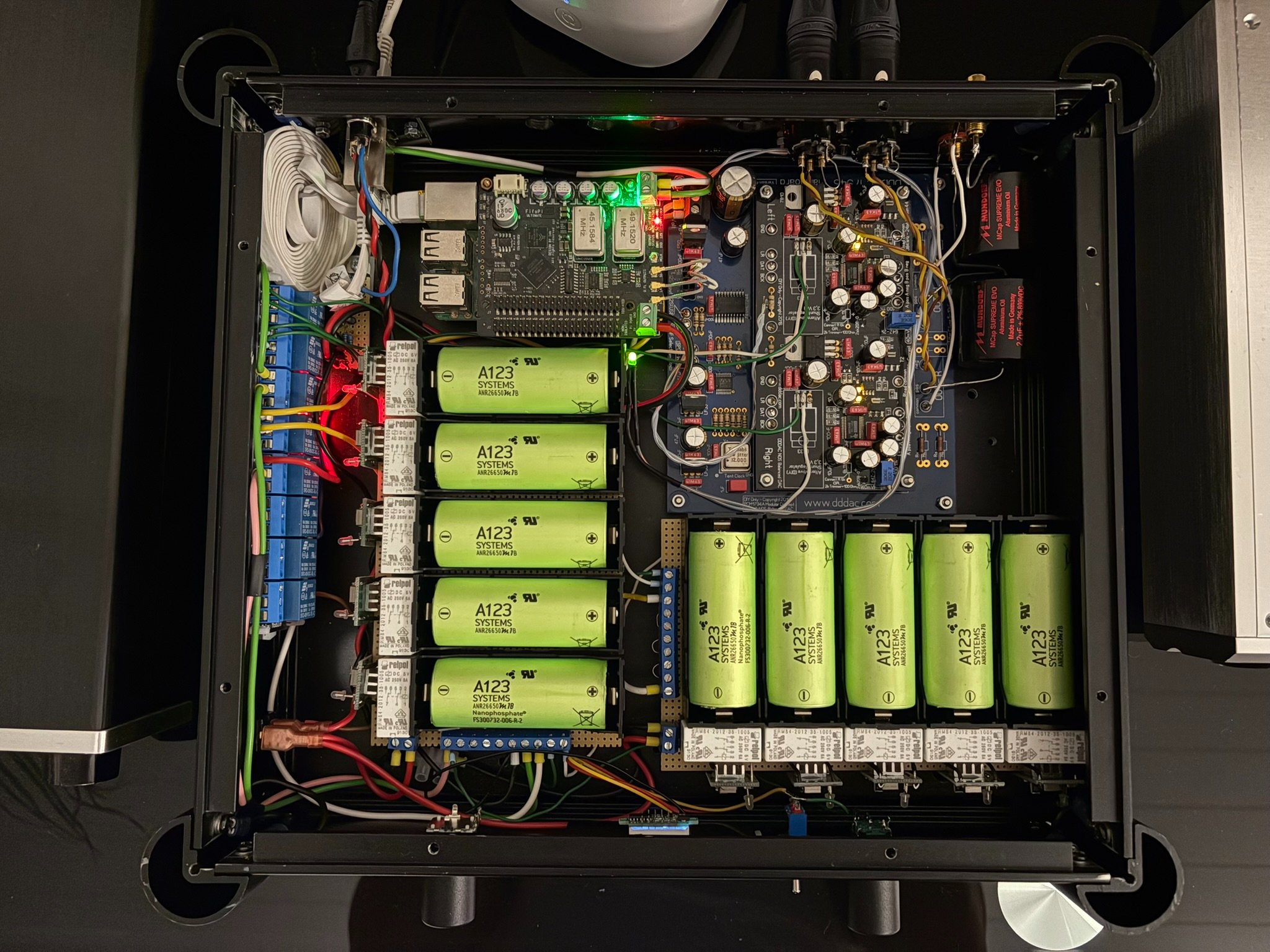

A battery powered DDDAC/RPi player... 🙂
I had some A123 Systems 26650 LiFePo cells lying around as well as well as a DDDAC board that I had not used for a few years. So I decided to put them to use. I had earlier made two charging PCBs using some charging chips (from e-bay) and aux relays, so that part was ready to use. Next I did a proto board setup and evertyhing seemed to work very well and I really liked the sound too! Very organic and natural to my ears.
In this setup I had three batteries in series giving ~10V for the RPi via a simple LM317 5V regulator. Also there is 3V feed for the Ian Canada reclocking board and four batteries in series feeding the DDDAC pcb. Later on I added separate 3V battery supplies for the DDDAC's PCM1794 and removed the regulators on the pcb.

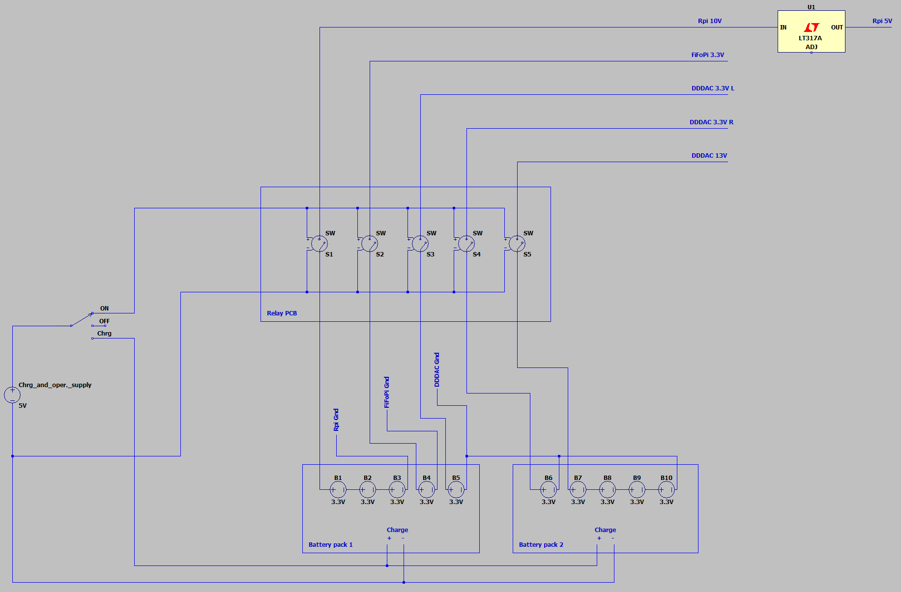

Since I liked the sound very much after the proto phase I decided to continue and put it in a box. Since I wanted to keep the expences low I sacrified my DIY pre amp's case for this. For switching the battery supplies on/off I used a ready made aux relay pcb. The design of the power supply circuitry is described below:
The basic idea is to have a ON-OFF-ON switch to control the external 5V operation/charging supply whether to turn the player on or to put in battery charging mode.

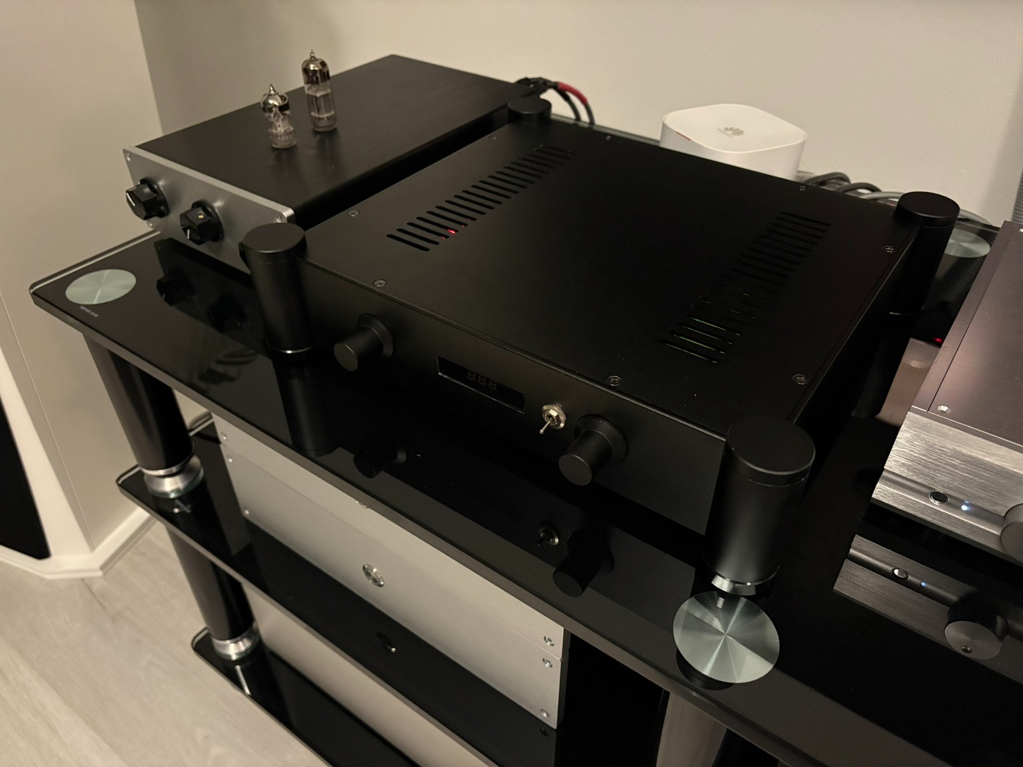

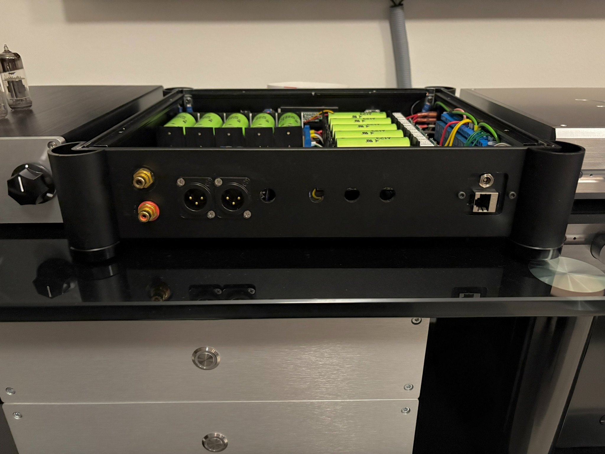

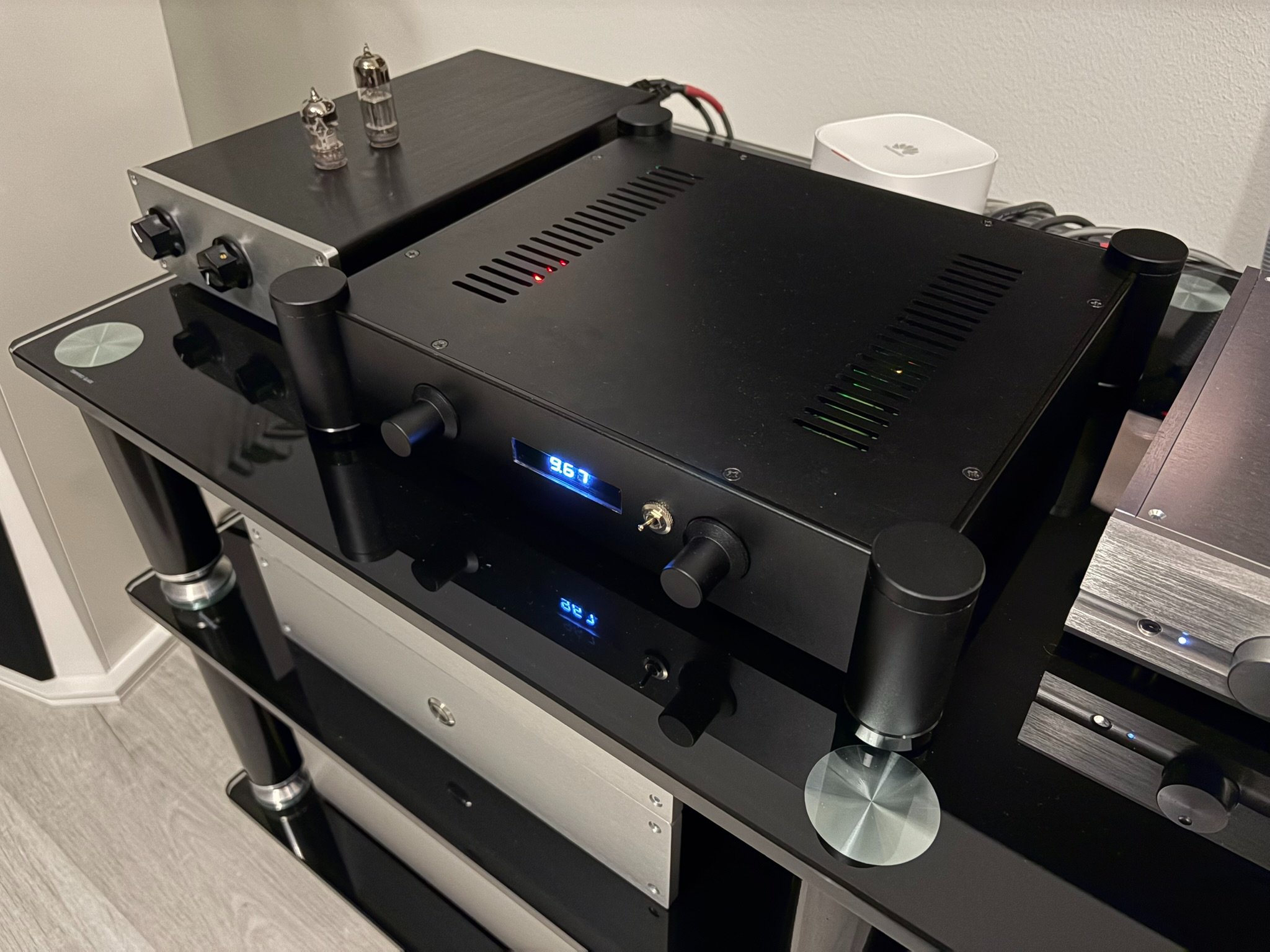

I also attached some pictures of the final "product". There are both RCA and balanced XLR outputs available and also a LCD display showing the voltage of the most power hungry RPi feed. The LCD can be switched on/off from the little switch on front panel. Playing time is about 5-6 hours. The RPi is using Ropieee software and I'm using it as a Roon end-point device, so all the controls are via iPad/iPhone.

Thanks for this detailed and wel documented report! Really appreciated. You have been making a very clever use of the batteries.
Also, nice chassis you built up. great Job 😎
I have only one question left: you feed the DDDAC "13V" with 4x A123, what is the minimum total voltage before you charge again? My recommendation was always to keep the DC at 12.5 V DC. 12 is alo fine but a bit on the edge for the 7810-regulator headroom, hence I suggest putting 12.5 at the DC input. More is no real problem, as long as it not beyond 15 Volt or so; otherwise, the 7810 might get a bit hot. well two questions: til what end voltage do you charge? 😉
