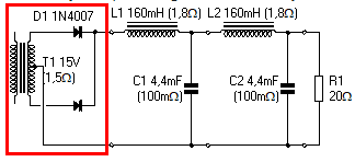

Hello,
The circuit that Michl proposed is easy.
It raised some questions but i dont know the answers.
Why not use 4 diodes?
Now there are two " secondary parts" which theoretically can never be identical.
Why not use sbyv28 at 50 dollar cents each.
I would go for a bigger ( ll2733)input choke with adjusted airgap followed by ll1694 or even a simple RC network. I expect better results with more mH for the input choke which also reduces the minimum current needed to waste by means of the bleeder.

You can also use 4 diodes with a different transformer, no problem. If you exchange the first section (marked red) you will not change the main principle of the circuit. The choke section which does the main work will be the same. The diode in the schematic is just the standard one which is taken by PSU Designer by default. I also use a fast recovery diode in my setup. It is less than one 1€, like you said,Hello,

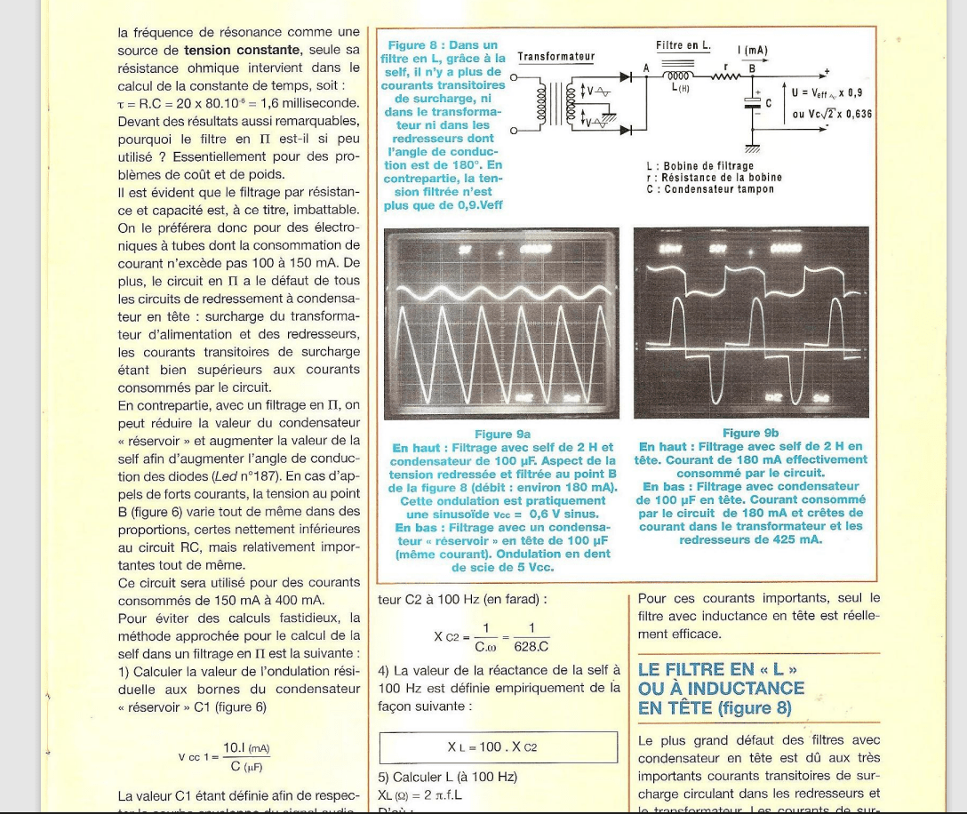

Maybe i posted this one before but still could be interesting to members.
Article from a famous french engineer where you can see differences between choke and capacitor input when used to supply a 180 ma current.
On the left top choke input bottom cap input. On the right the current demand with choke input around 180 mA as requested by the load. With cap input switching between 180 and 425 mA. These peaks also occur in the transformer, diodes and the wires taking care of the connections. And this is only 180 mA most heater current are much higher.
So one more reason to use a decent choke input

Hello,
Take a look at the scope image on the left.
Both " traces" are measured at the first cap. The one above is with a Two Henry choke input. The one underneath without the choke.
With choke a nice wave with 0,6 volt ripple.
Without choke a terrible sawtooth 5 volts.
Image right with choke nice steady current draw similar to the one presented by the load.
Without choke current bouncing between 180 and 425 mA.
Transformer, diodes and caps will not like that and this happening all of the time.
Greetings Eduard
