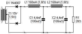

Like mbrennwa suggested, I use a CLCL supply. 1 x 15V / 16V transformer, 2 x Lundhal LL1694, 2 x 4700uF Caps and one bleeding resistor (high watt) will give you about 10 V for a 4 deck DDDAC (I have removed the 10V LDOs from the DAC boards). You can go the non-risk route and use a higher V transformer to get 12V and remain the LDO on the DAC boards.
I really like the non LDO version better from sound perspective. So feeding the tent shunts directly. Note, this is for the current version of DAC boards. And there is a little risk. If you give too much V this may burn your DAC board / tent shunt area on the board.
From the transformer and CLCL filter I still cannot get DC voltage only a filtered ACLike mbrennwa suggested, I use a CLCL supply. 1 x 15V / 16V transformer, 2 x Lundhal LL1694, 2 x 4700uF Caps and one bleeding resistor (high watt) will give you about 10 V for a 4 deck DDDAC (I have removed the 10V LDOs from the DAC boards). You can go the non-risk route and use a higher V transformer to get 12V and remain the LDO on the DAC boards.
I depends how you define DC
. I forgot to mention in the part list a rectifier which makes "DC" out of your AC in the first step of this chain. At the end you are getting a very clean "DC" voltage with a very low ripple out of such CLCL. I can send you a schematic in some hours. You can use PSU Designer II to simulate such PSU.
Google schematic for a linear power supply. Transformer then bridge rectifier and you have DC. Then a filter either CRC or CLC will get you ripple free DC. CLCLC will be really good. A regulator will then set the voltage. It can all be done point to point on a board. There are software tools to model the circuit to get the desired power and ripple. It is a skill that will save a lot of money in diy. As a novice, I found Duncan's amp a useful resource to learn about simple power supplies. https://www.duncanamps.com/software.html PSU Designer tool let's you play around model basic linear supplies traditionally used for tube amps.From the transformer and CLCL filter I still cannot get DC voltage only a filtered ACI am really curious too about the schematic.

The supply designed by the people from audio creative does have a clc circuit inside and some active kind of regulator .
If you read that some people removed the 7810 regulator that is positioned at the input of the Tent shunt and report an improvement i am not sure that introducing another active before the 7810 would be better.
Of course an LCL is totally different from an LC( plus a rc) circuit as output stage.
The choke in the audio creative is rather small. I bett the LL2771 wont fit inside that enclosure.
Of course the choke they use won't be as expensive ( 194€)as the Lundahl and won't weigh 5 kilogrammes but probably less than 0,5 kilogrammes. If they use the Lundahl their supply will be double the price if not more.
Of course a choke has infinite lifetime so in the end it will be cheap.
Greetings Eduard

In fact, you can also upgrade the existing DDDAC Power supply...
use a bigger transformer - say 50 or 100VA.
at the place of the fuse (choose yourself if you keep a fuse or just leave it out) connect a Choke - this will give you a CLC
you might want to add a resistor of 0,47 - 1 Ohm - experiment yourself.
Very good results have been reported by using a Hammond 159ZC and even increasing the second capacitor to 10.000 or 22.000 uF
I tried this myself with excellent results!
On my blog site this comment was given at the post of my power standard supply (see here: Link to DDDAC BLOG PSU Post )
it is a relatively easy tweak and also easy to do A-B comparison (I used an Aliexpress remote controlled A-B Relais board to switch between Choke/ NO Choke)
