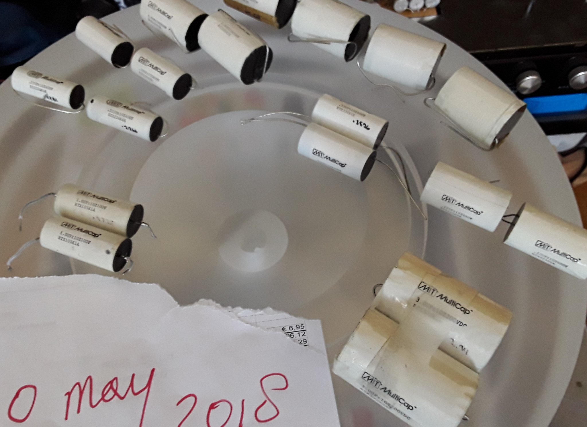

A pity that Brexit made sending something to the UK a bit complicated otherwise i would have offered you to try a pair of Russian K75-10 output capacitors. I never used them in my DDDAC because i am using 4 boards with Sowter but all the other spots i use them they give a nice improvement.
They wont give you more detail but i like the way they sound.
I tried lots of the so called audiophile caps as you can see in the attachment!
Maybe there is someone in the UK that has a pair for you. Postage to the UK will be a few Euro but i am afraid that there will be additional cost for you.
Greetings, Eduard

you are right, they do sound nice and smooth. I tried them also in speaker filters. Only be careful to not have a lot of them in the whole audio chain, thing can get muddy
