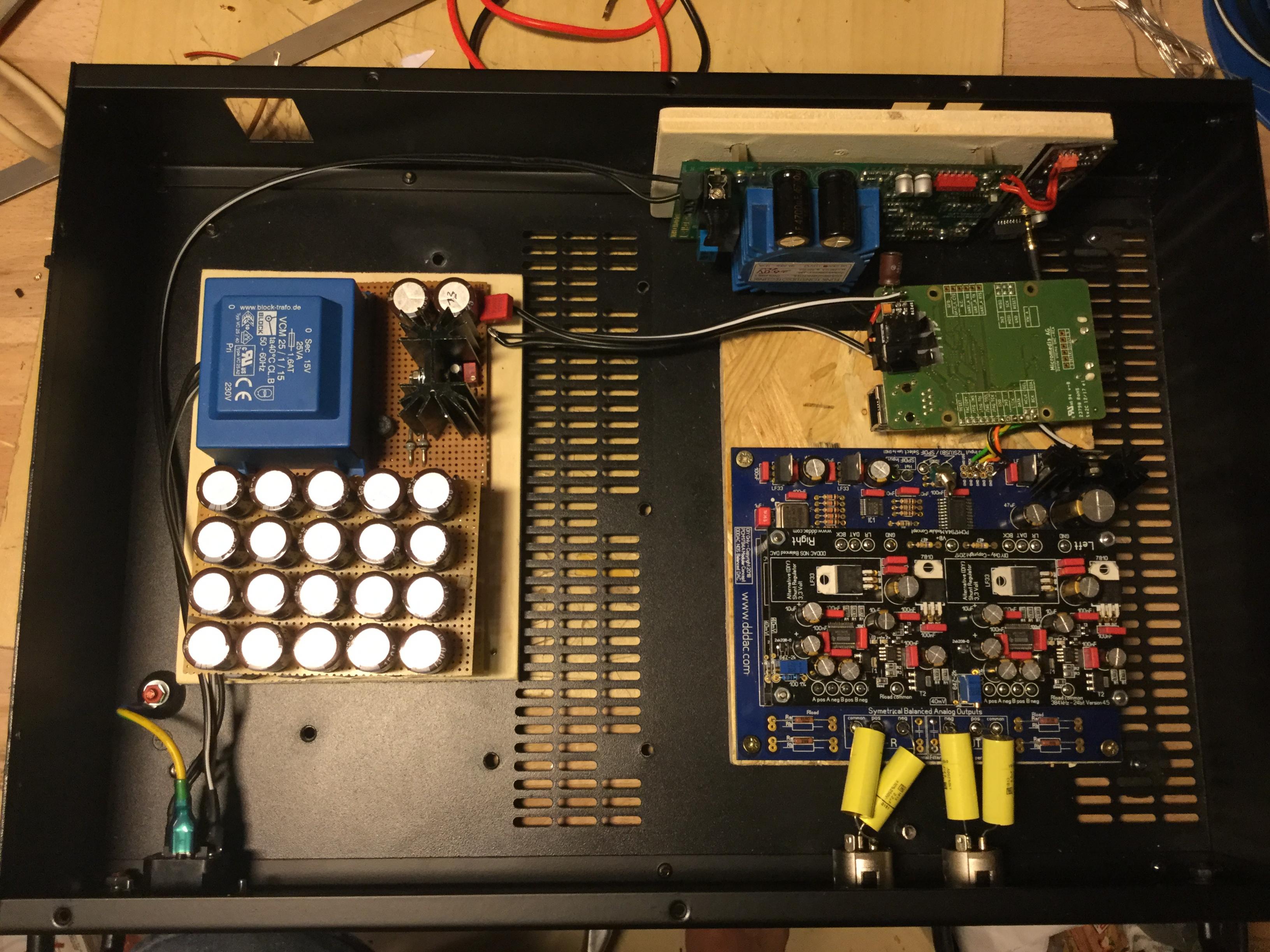

After reading through this hundreds of pages, let me say thank you for these many ideas I got during reading.
As I just finished my rebuild, I‘d like to show you my setup: 2 Boards, DANTE supplies the i2s, regulated by Bellesons for 12V and 3.3V for the DANTE module.
Hope you like it, I love the sound!

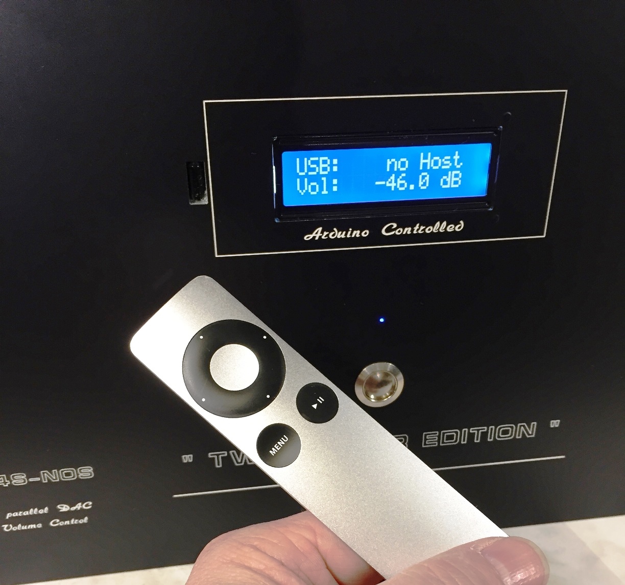

I can confirm that - As you all (maybe) know I use the specially designed for DDDAC Sowter transformers with 18 secondary taps instead of the normal 2 wire output. This is basically my "pre" amplifier - I made an Arduino controlled volume control with 18 small signal relais selecting the volume taps. (with an Apple remote control 😛 )

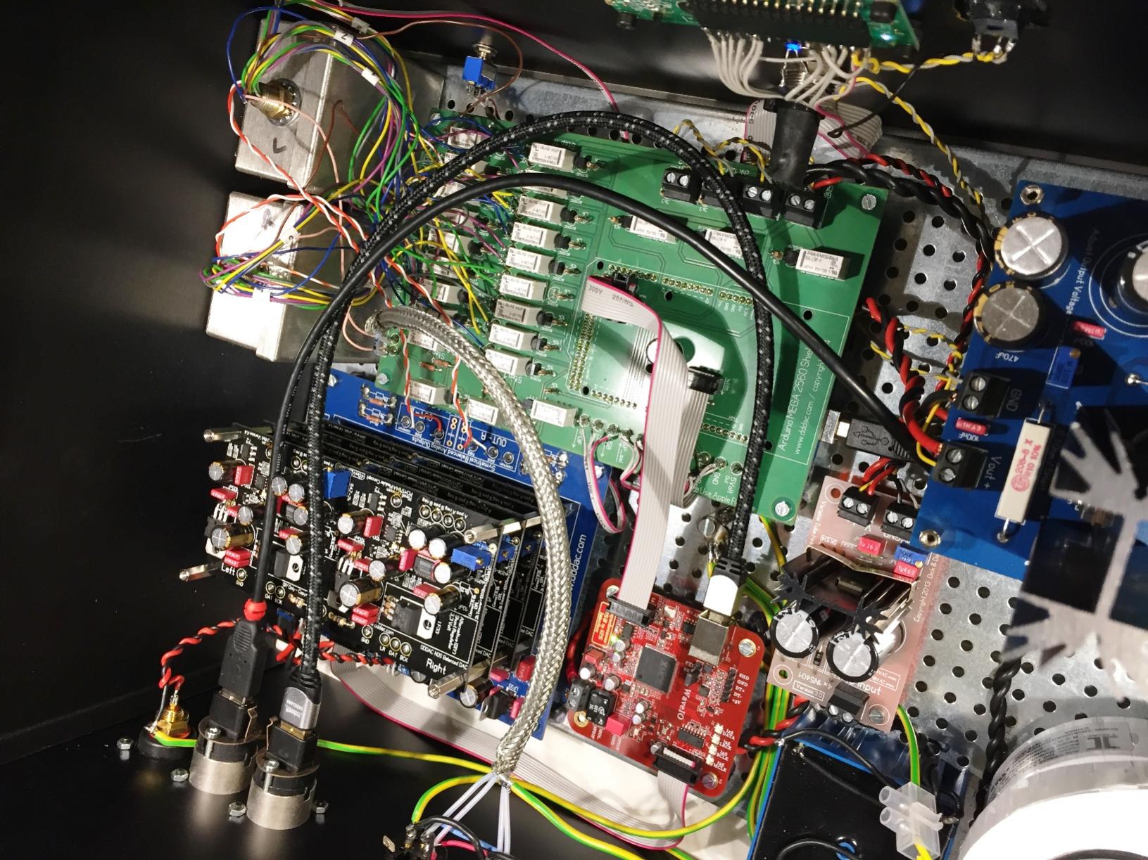

here are two pictures - It is the green PCB. The Arduino board is piggy backed on it, but it is at the other side of the pcb, so you cannot see it here 😱

With this transformer I have 3,8V RMS eff. at the DAC output at the 0dB tap ….
What's the cable (flat ribbon) between the WaveIO and your volume control?
Apart from that I can confirm that the Sowter TVCs are superb with the DDDAC. I use the standard Sowter 9335 transformers in both my DDDAC builds.
That is where normally the status LEDs are connected.
I read this status in the arduino and show it in via a lookup table in software normal text on the LCD display
