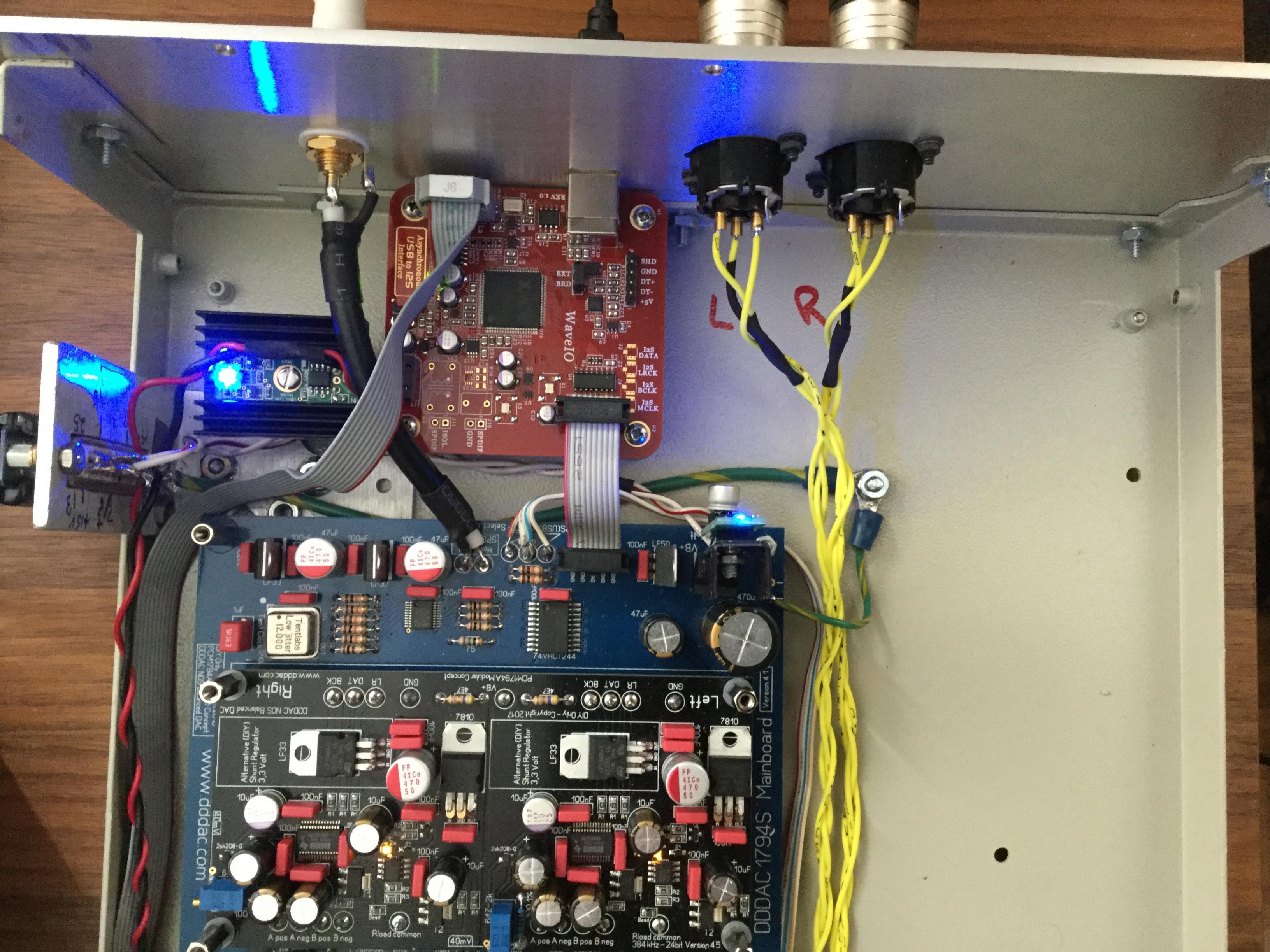

Hey there. Today, I tried connecting Kali in between the waveio and the dddac motherboard but go no output. The Kali is not properly engaged I believe.
Before I even get into the troubleshooting mode, tell me does this configuration even work with the older Red DDDAC motherboard?

Thanks guys. A quick update. I followed Juancho's post #6891 and advanced to get the Kali engaged (now the Lock light and the appropriate sampling frequencies light up properly). However, there is a crackling sound coming predominantly from the left channel. It is bad and unacceptable. I got this previously as well when I was using the Kali with Rpi+Allo Isolator combo, however, I was able to eliminate the same after experimentation with ground wires connected in several different manners.

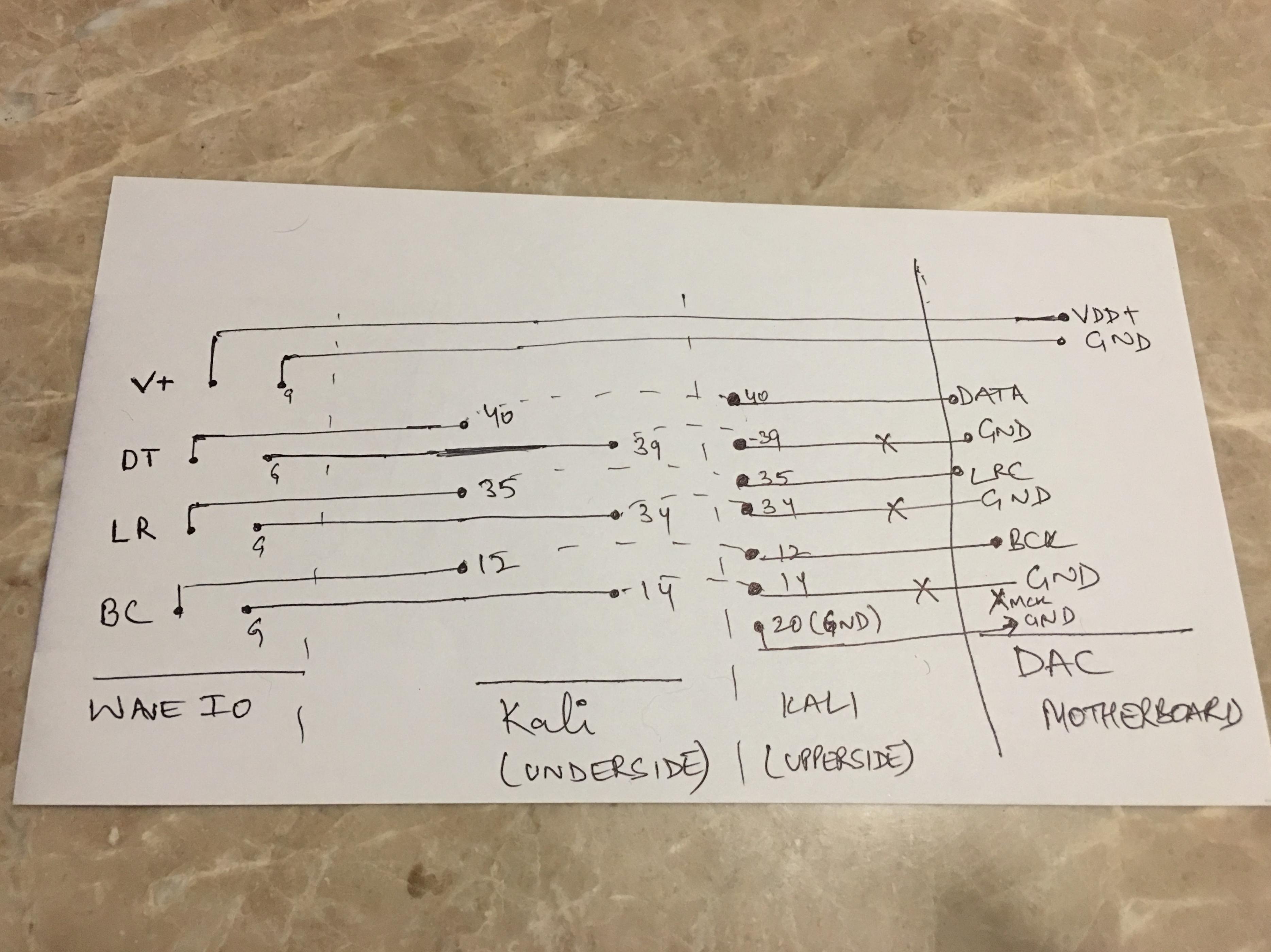

Here is an update: IT WORKS!!! Haha, pardon the caps but I was a bit excited to make it work after numerous tries. So many flimsy i2s wires were running all over the place in that box made me go nuts. However, in the end it worked out.
How I made it work: A lot of hit and trial basically. The issue was with how I was connecting the ground wires. WaveIO's DT, LR, BC and their grounds to be connected with Kali's inputs and WaveIO's V+ and corresponding ground were engaged with V and ground on the Red motherboard's inputs.

If I understand you correctly you are saying that you connected Waves earth's to Kali's earth's then Kali's earth's to the mainboard?
Do correct me if that's wrong. A sketch of the circuit would be helpful
David
Thanks. It's a little different so I'll give be it a tryHere you go guys.... pretty much the same thing that you helped me with.
Warning: i am quite bad at these diagrams, so if there is any confusions, let me know.
David

Take a look at the GND connection:
AC plug --> chassis --> Wave IO PSU --> Wave IO board --> Kali --> DDDAC --> DDDAC PSU --> chassis --> AC plug
That looks like a big fat ground loop to me in the digital signal chain. I don't know, but I don't think this is good.

Most wall warts don't have a safety earth GND, so I guess the Kali PSU does not have its own GND. The Kali has two GND connections (one to the Wave IO and one to the DDDAC) to the chassis / AC plug GND.
I think this is being over complicated. There is a signal ground at the AC plug inlet. That is where the independent ground connections of the two separate power supplies of wave io and dddac go and meet. Think that circuit is complete.
Now, the Kali is connected to one of its ground to the wave io as well as with the dddac. The wall supply should have a safety ground.
I would say go ahead and try the integration in the way it worked for me. Pick the brains of electronic experts in parallel to check if grounding is a concern. If yes, then let's work towards it. But at least see if you get audio in this way.
