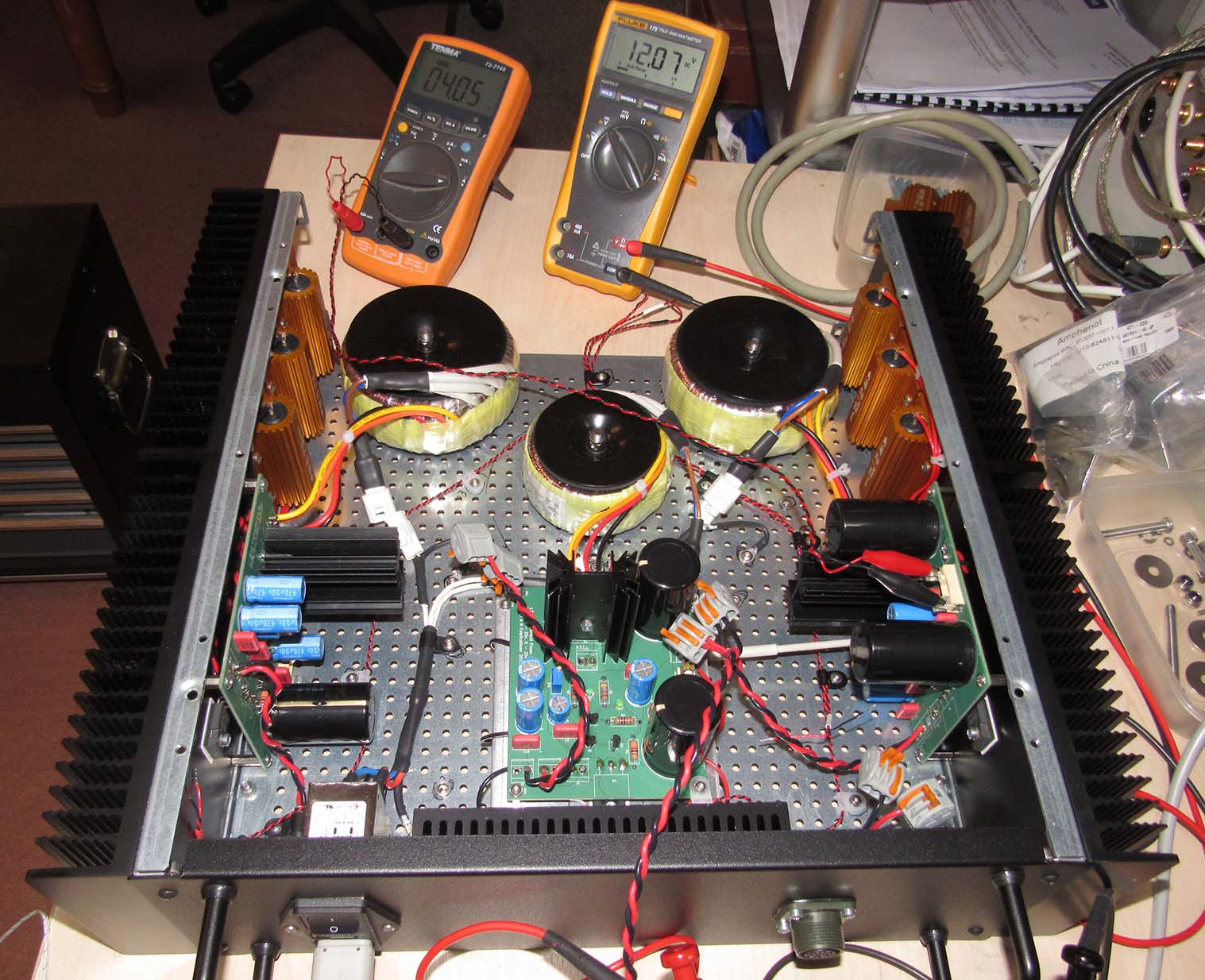

I don't see a connection of the chassis to safety earth. This would be a safety issue. Fix this first.
Where is the green wire from the transformer going? Is this a shield for the transformer? If yes, I'd connect the green wire to the chassis of the DDDAC.
The chassis is connected to safety earth through the socket connector, it's 3 wires in on the trafo. Probably a bit hard to see.I don't see a connection of the chassis to safety earth. This would be a safety issue. Fix this first.
I wasn't sure how to connect the output since I use unbalanced. I did read through a lot of posts and thought it should be like this since I got 2,7v dc between pos and common.
Connecting the output RCA connectors properly to common instead of negative out will likely fix your hum problem. Let us know how it goes.
Thank you all for the input!
It got a lot better, got rid of the 50hz! But now it sounds like a more quiet 100hz. Probably half the volume of the 50hz or even lower, easy to hear 2-3 meters from the speakers. Also some high frequency but that could be fixed with caps?
Attached a photo from Spectroid, might help?
this looks a dropping voltage at rectifier frequency - so why not check the 8 Volt at the dac chip.
Oscilloscope: Is it flat? do you have an AC signal addition on top? (I expect a kind of square wave)
or with your FFT analyzer: just look at the spectrum of the 8 Volt...
let us know
Thanks for the input!
After some fiddling with the oscilloscope I figured out that it definitely was a problem caused by the power supply. Adding some caps before the dac really did well!
Now there is still some high frequency noise around 12khz, please see attached photo.
Good to hear the remote diagnostics worked 🙂
now all is fine, enjoy the music !!

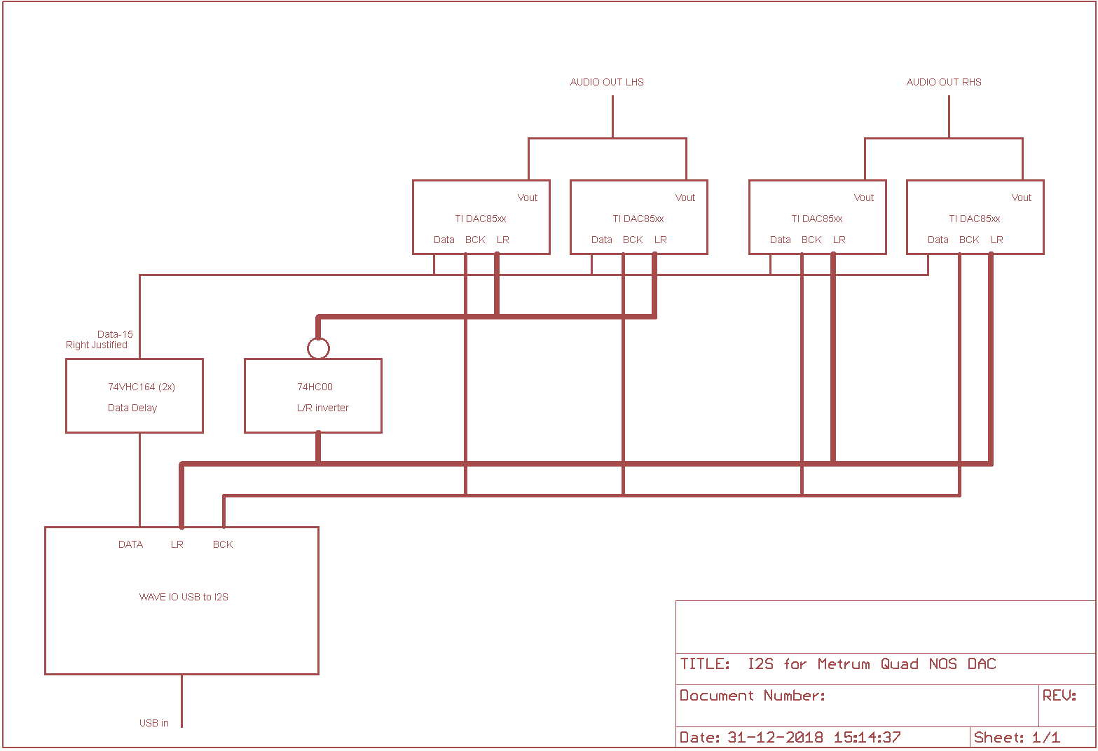

I2S for Metrum Quad NOS DAC using DDDac ideas
Hi Gents,
The DDDac project gave me a lot of inspiration and understanding of Digital Audio. Many thanks to Doede...
Currently I'm using two good old Metrum Quad DAC's and one of them was extreme sensitive for switching impulses of light bulbs, solder irons etc. via the SPDIF input with muting of the audio signal as result. It drove me mad so I made the discission to try I2S as these signals have a higher level.
I bought a Wave IO from Lucien and made some conversion as in the DDDac.
The Metrum is using Texas Instruments 16-bit DAC chips in NOS mode so in my understanding I have to convert 32bit I2C from the Wave IO to 16 bit right justified data. I took 2x 74VHC164 to delay 15+(1) bits. After some reverse enginering of the Metrum I noticed that the L/R clock was inverted for one channel and for me it was quite easy to re-use this circuit. Cutting traces in a multi layer PCB is impossible and lifting tiny IC pins isn't my hobby so I gave it a try. In the drawing you can see the block diagram. It's a bit quick and dirty. Excuse me for that.
Currently I'm listening to the modified Metrum and it sounds good to me. It's not sensitive for switching impulses anymore so I can enjoy the music.
There are still a few questions on my mind... I don't use a 24 bit buffer for the second channel. It's solved by inverting the L/R I think. Are there any timing issues doing it this way?
I'm not a "bit level" specialist.

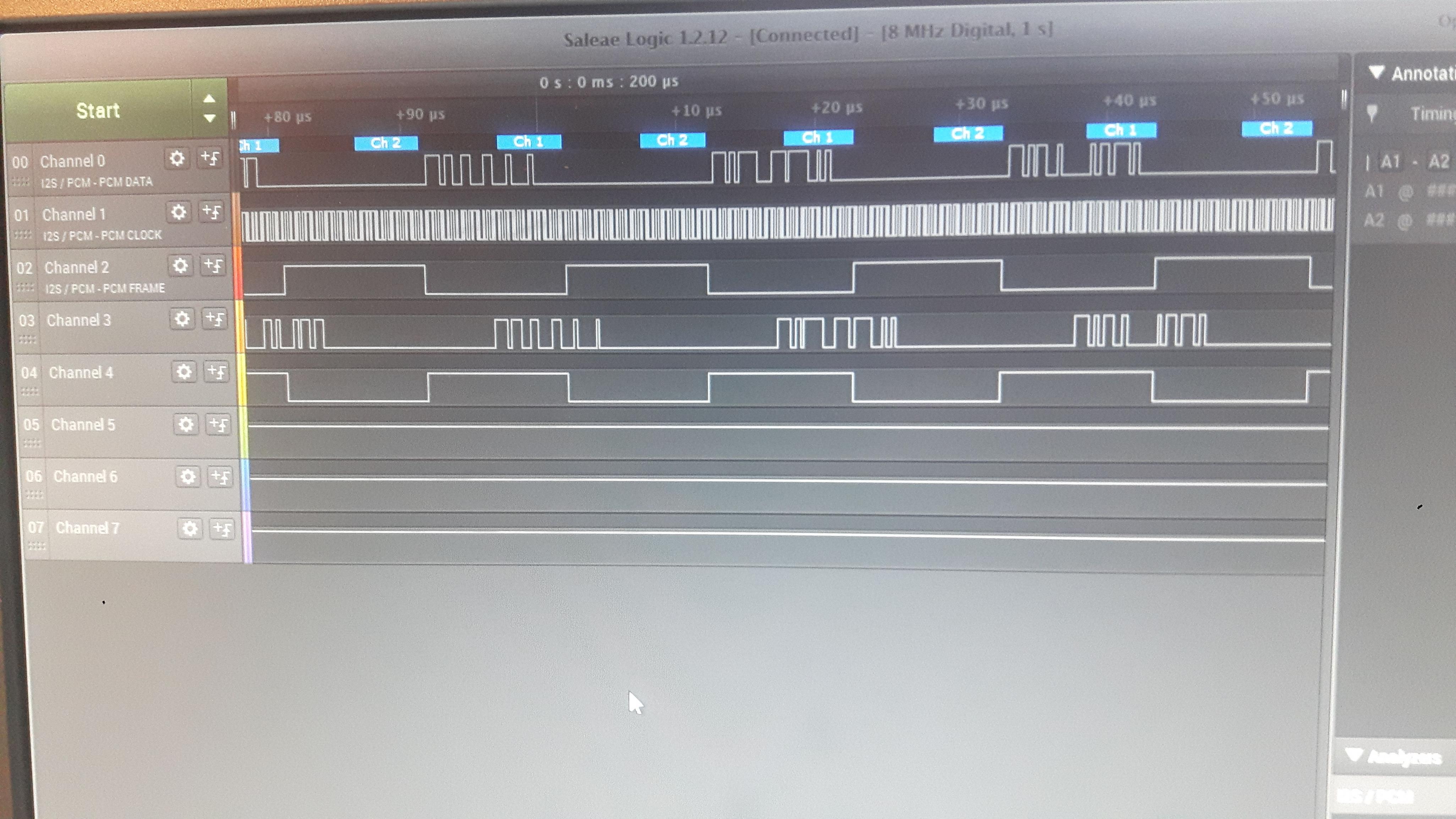

I also added a picture of my 10 euro data-analyzer. I did stream just one channel test tone via Spotify and when I count clock pulses it seems to fit. At channel 0 is the original 32bits data stream. At channel 1 the BCK. At ch.2 and 4 the L/R selection and at ch.3 the delayed 16bit RJ data stream.
Any suggestion?
Happy New Year...Johan
Any suggestion?
