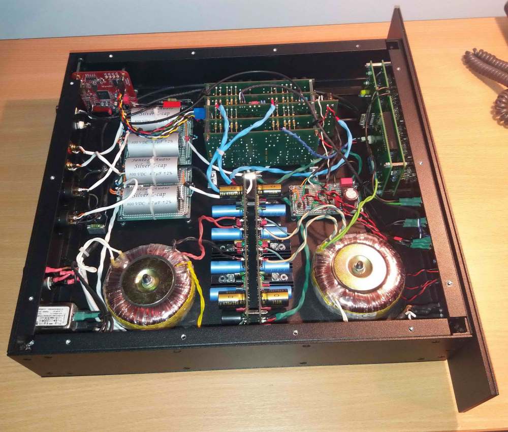

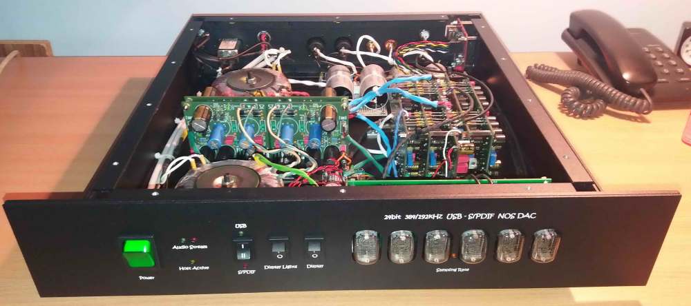

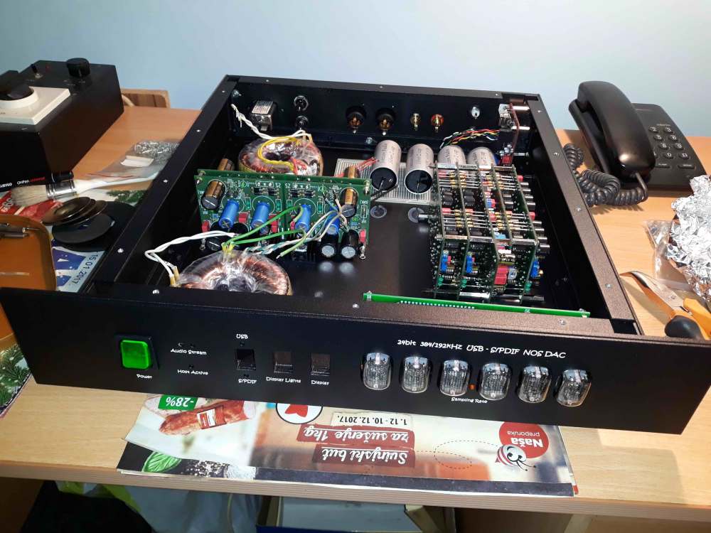

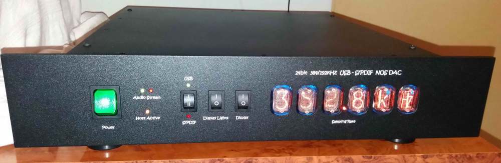

This is my version of dddac 1794 (4 boards) with Nixie frequency display made about 6 months ago. Motherboard and supply are modified so that everything fits horizontally and the height is just 65mm. I do not think anyone has a Nixie display on a DAC, maybe I'm wrong. It looks much more beautiful in nature than on photos. I will probably replace the front panel in the future for something nicer, this one is only plasticized and printed with an UV printer. I do not care much for the look and the sound is phenomenal. Done with a little help from my friends.
