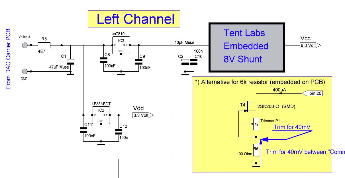

Hi there,
By comparing the schematics between 4.2 & 5.1, I can see there are many changes on DAC board.
1. What is the purpose of adding a UA7810 between LF33 and a shunt regulator? Can I regulate the voltage directly from 12V to 8V without UA7810?
2. Why the decoupling caps changed from 47u+100n to 10u+100n in version 5.1?
3. If I don't use Tent lab shunt, any alternatives?
