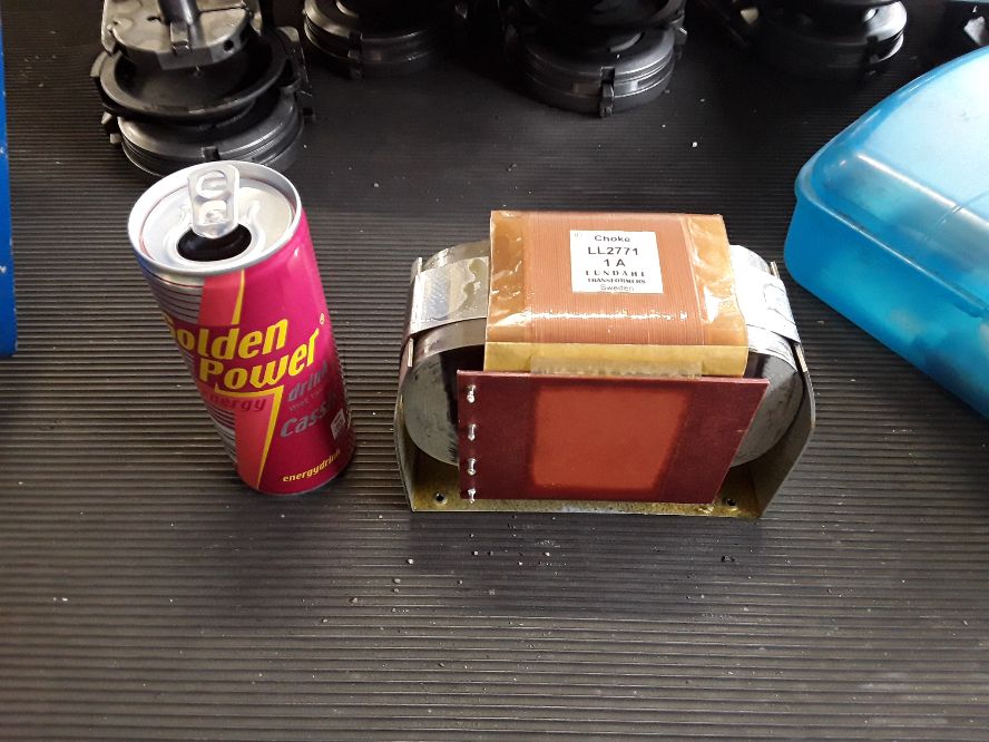

My friend will buy my 500va R core to use in his hiraga power amp and i will get another transformer and a MUCH bigger choke from Sweden. If i remember well you have a 4 board dddac just like me. My new transfomer has 8 6,3 windings so can create the right input by putting in series the 6,3 and the ones not in series can be put in parallel depending upon how much voltage i will loose in the choke. I did do some test with chokes already in stock but 3000mH is a lot more.

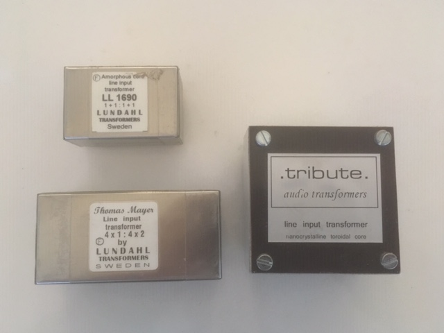

One of the first things on my list is to replace the output caps with transformers: I have several line transformers in my partsbin...
I have searched for info about how to choose the secondary load for the transformers without success... Transformers are 1:2
Can you provide some more details about your transformers?
If you DDDAC outputs have a slight DC imbalance between POS and NEG (they all have some imbalance), your trannies need to tolerate this without saturating the core.
I'd suspect that a 1:2 step up might give you too much gain. I'd try them "backwards" first, giving a rather low gain. But since most audio chains have too much gain anyway, that might be fine.
Thanks, see pics, The tribute is 1:1+1

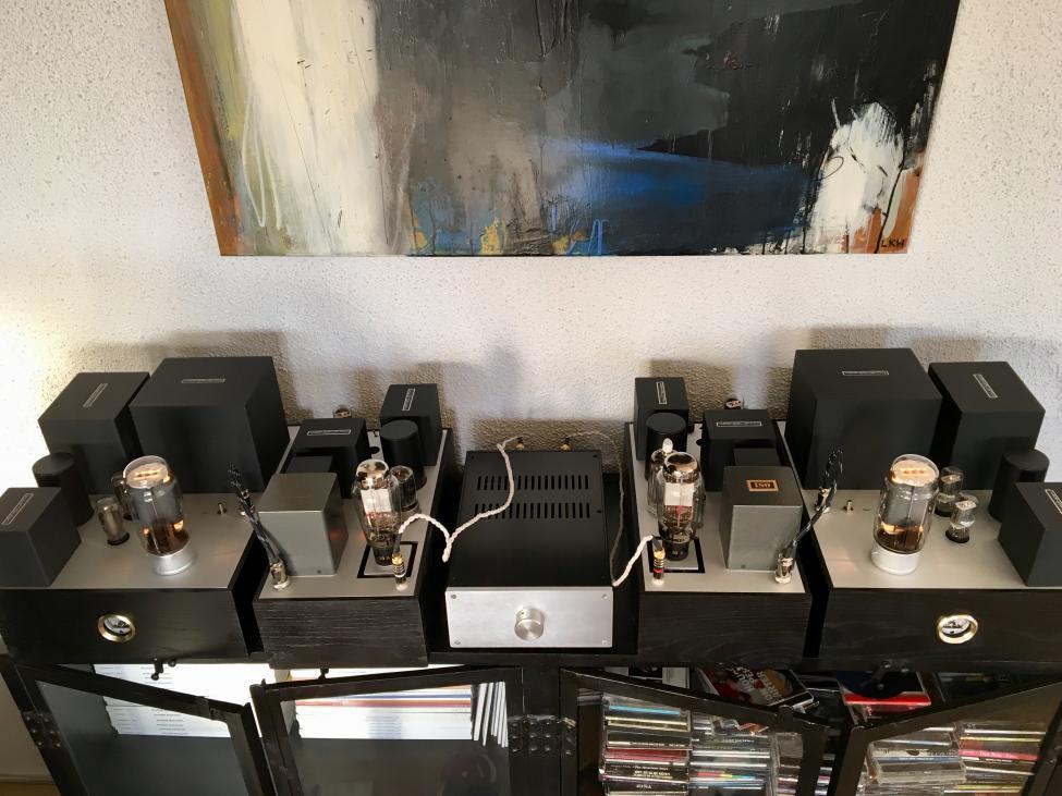

The amplifiers on the second picture are gm70's of my own design and making, input sensitivity is about 3.2 vpk for full output, hence the step up...
Ok, I'd just pop those in and see what you get. Also, I'd recommend to minimize the DC imbalance by tweaking the load resistors.
Buuuut... on your photo, the box in the middle seems to be some kind of volume control / attenuator. Why don't you use a TVC (transformer volume control)? This would work as a transformer output for the DAC and a "lossless" volume control at the same time. Much better than the conventional pot, which "burns" most of the signal in the resistors. The Sowter 9335 is a great option and works well with the DDDAC. I use it in both my DDDACs, and so do others.

I bet it is, in the right application. The label says "toroidal", so it will be rather unhappy with a bit of DC. You are pushing your luck with thisone in the DDDAC.
however as link between the dac and the amplifier the proposed Sowter is interesting
Yes. Doede tested this transformer in a DDDAC using his Audio Precision analyzer, and it came out very well. No worries with the residual DC.
Actually I went to Lundahl as well with my expectations of bandwidth, maximum output voltage and the fact there must be room for some residual DC current, and the answer was they could not do it. Sowter could and the transformer is pretty high spec, so worth the Money. Of course other transformers will work as well, but most likely will not meet the expectations of high bandwidth in both ways and low distortion at high voltage Output. Do not forget, the Sowter does pimp up to 4,6 Volts rms
