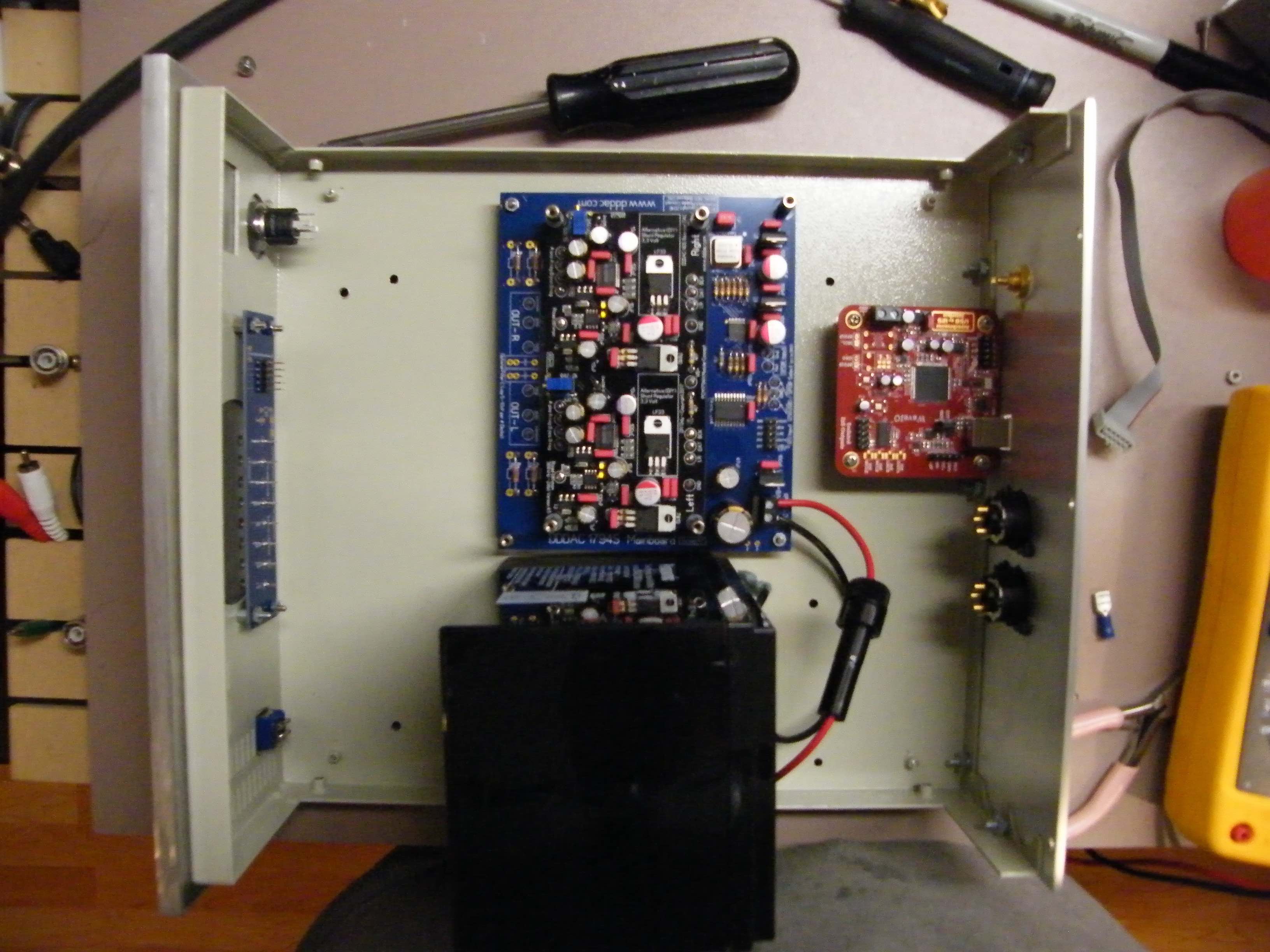

I got my 1 board DDDac soldered up and the basic testing indicates everything is normal. All regulators are working properly although I did not try to measure the +8 from the Tent shunts. The current sources easily adjusted to 40mv and the DC output across the load resistors is 2.65 volts. I am powering it from a 12v 12ah battery for this initial test. I'm currently leaning towards a separate power supply box docked to the main chassis. Next up will be to power up the waveI/O, connect it to the main board and wire up the XLR output jacks.
Got music from my DDDac. I'm powering the WaveI/o board from an external supply and the DAC with a 12v 12ah battery. I had some trouble getting the USB working but after adjusting some settings in the mac preferences and in pure music I got it working. One odd thing is that the LEDs don't seem to be working quite right. The host active and music streaming leds stay on all the time. The sample rate leds don't seem to agree with what is labelled on the led board but I am getting unique leds lighting for different rates. It may sort itself out after another power cycle.

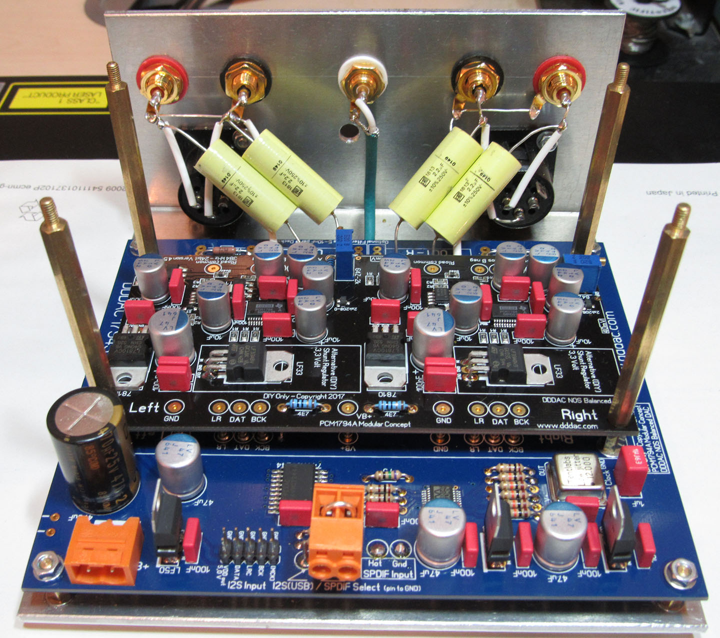

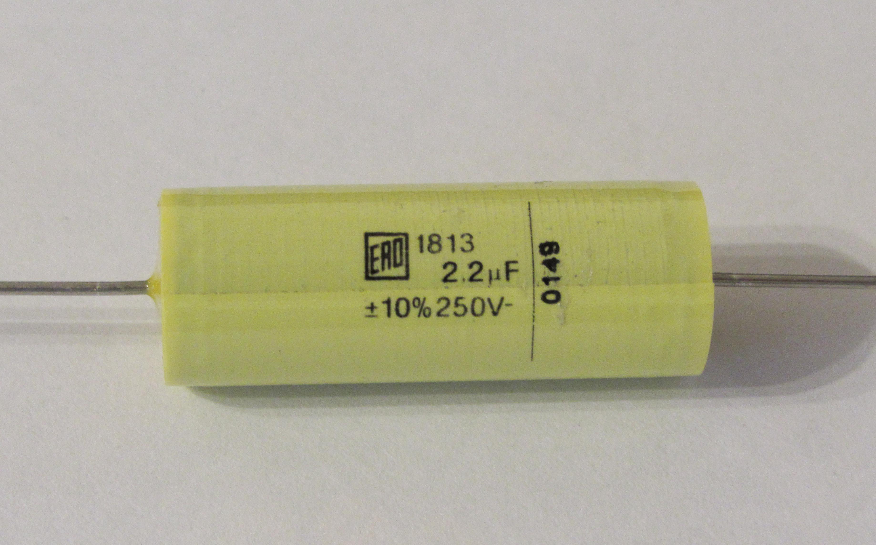

I have some output capacitor recommendations.
I have just built another DAC Board tester that has RCA and XLR outputs.
I was trying various capacitors that I had to hand, but I made an Ebay search for 2.2uf 250v
poly capacitors as I wanted the best quality without going to Mundorf or even Audionote ...
When they arrived, I was able to complete my tester and bought a Tent board as a benchmark reference.
I had it powered by my Farnell Dual 30v 2a power supply and sat back to listen.
The sound was stunningly good with the one Tent board and going through the poly capacitors in balanced mode. I was shocked and pleased at the same time, it was that good even comparing it with my fully tricked out 16 stacker with Sowter transformers.
So if you want stunning sound for a small outlay, here is the link to the capacitor vendor.
10x MKT-Capacitor ax. 2,2mF 250V DC ; 13x31,5mm ; MKT18135222551Q ; 2,2uF | eBay
I also used Aluminium Polymer Capacitors in place of the supplied electrolytic ones which also helped.
They are not silly money either but will give a lift to the already reference quality sound.
Here are the pictures below 🙂

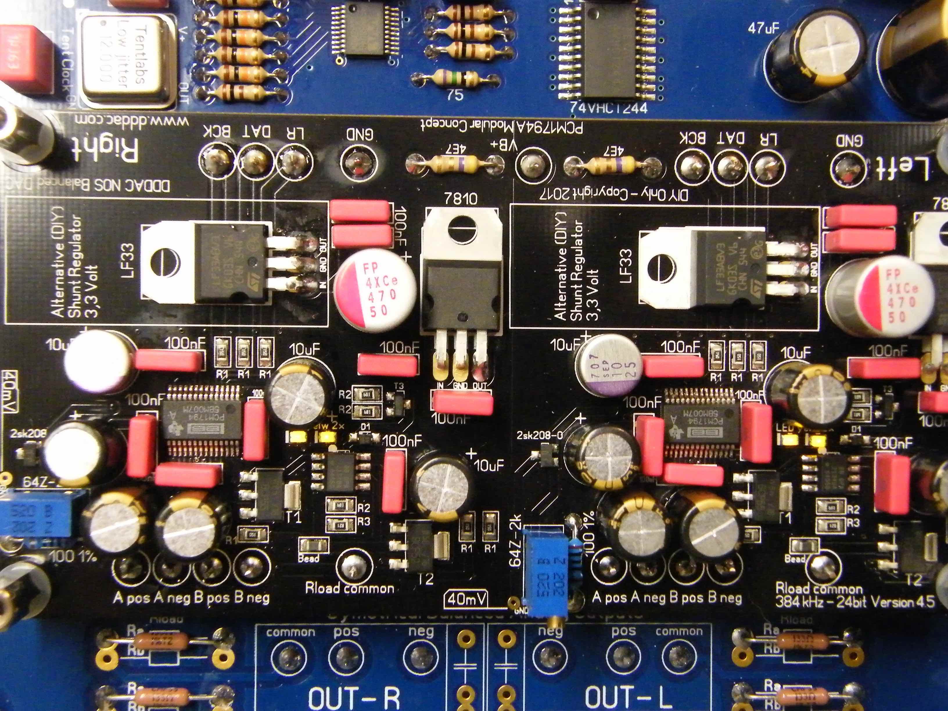

Just fired up a 3 tier DDDAC 1794
Distorted sound from both channels
I used load resistors supplied with kit 4 x 34 ohm.
They should be 44 ohm, could this be the cause of distorted sound ?
DDDAC - 12V looks ok clamp meter indicates around 550ma for above configuration.
Tried unit on SFDIF only.
No smoke leds on DAC boards light up
Found it difficult to adjust 2 of the pots for 40mv they were on different boards
Thanks in advance for advice
Johno

I think it is better to help you off line, that is easier. pls send an email to my mail at dddac -dot- com account with good pictures what you have done, plus measurement values of the 40mV and DC values of the POS and NEG terminals versus "Common" also let me know how it is all connected to the rest of your chain. from there we will take it, ok?
