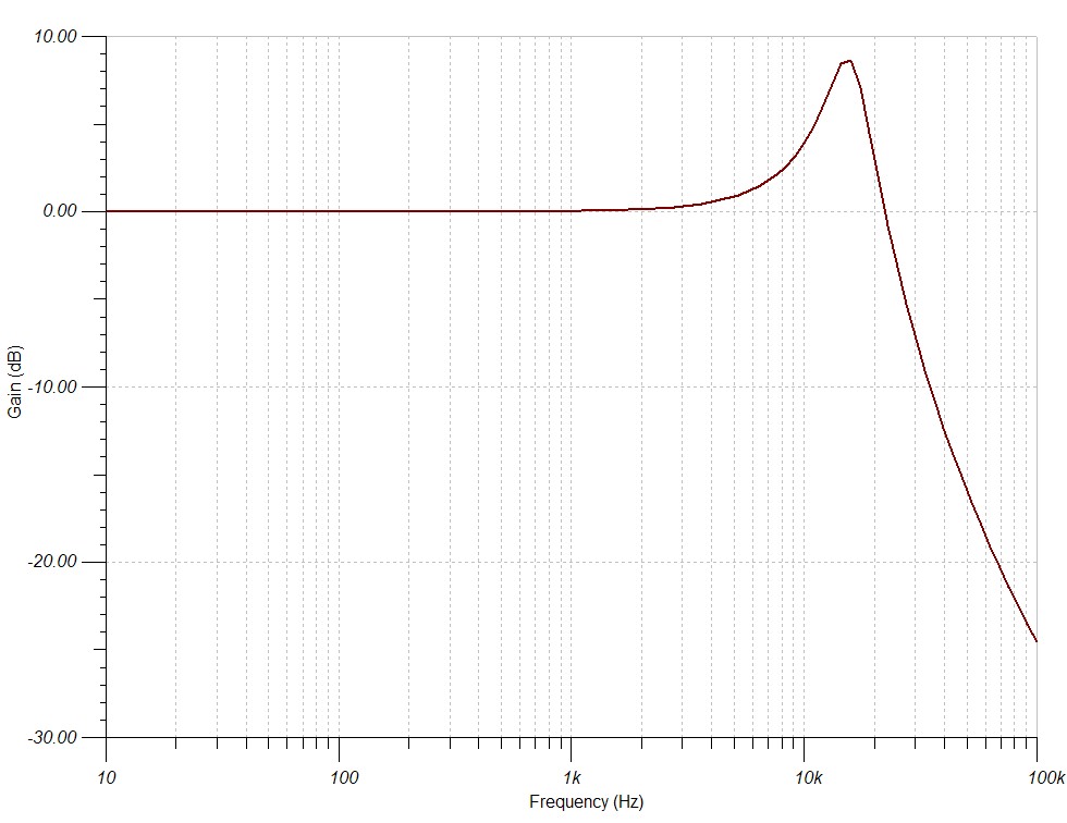

I am using the dddac and i have an LCR filtre designed for cd player output 20? 30 years ago by Jean Hiraga.
Of course digital audio at that time was rather poor.
I did ask Doede if i should remove the filter because his dddac is designed in a peculiar way. Probably he is enjoying holiday.
So anyone has an idea?
Greetings, Eduard

Without seeing a schematic of the filter it's impossible to say. I would remove it in order to get a good fix on the stock sound of the DAC. Depending on how the filter is designed it may cause problems with the output of the dddac. Keep in mind that if you are using a dc coupled preamp you need to use coupling capacitors on the outputs of the DAC unless you have the output transformer option.

This filter is designed to filter the '' negative side effects " caused by the AD converter. There is a coil in series and then a small cap in series with a resistor in parallel. I did send Doede the actual values but it might be illegal to put the actual values on the internet for all to see.
I did reread the dddac info. There is no digital filtering used so probably there will be no need for this lcr unit!!

Sounds like a straight forward LC filter with a loading resistor. Since this filter would pass dc to the preamp you would still need a series capacitor when using the filter, unless your preamp has ac coupled inputs. It is worth trying it to see if you like the sound. As long as the shunt resistor value is not too low it should not load down the outputs of the DAC.

The filter is between the Sowter output transformer and the input of the preamp.

I would be worried that the filter LC circuit might oscillate in combination with the transformer. Do you have a scope to check this?Ooh ooh,

With the transformers on the output the filter is more of an unknown. The transformer itself forms a 2nd order low pass filter that you tune using the load resistance on the transformer output. With the filter as a load who knows what the interaction will be. I would definitely try it without the filter.

I checked the Hiraga filter in combination with a 4-deck DAC and it does not look good. See Graph. I would recommend to not use filters like this. To be honest, most of the HF junk is filtered anyway by the Sowter Transformer.
Without transformers there is still the option to use the optional filter capacitors on the mainboard....
