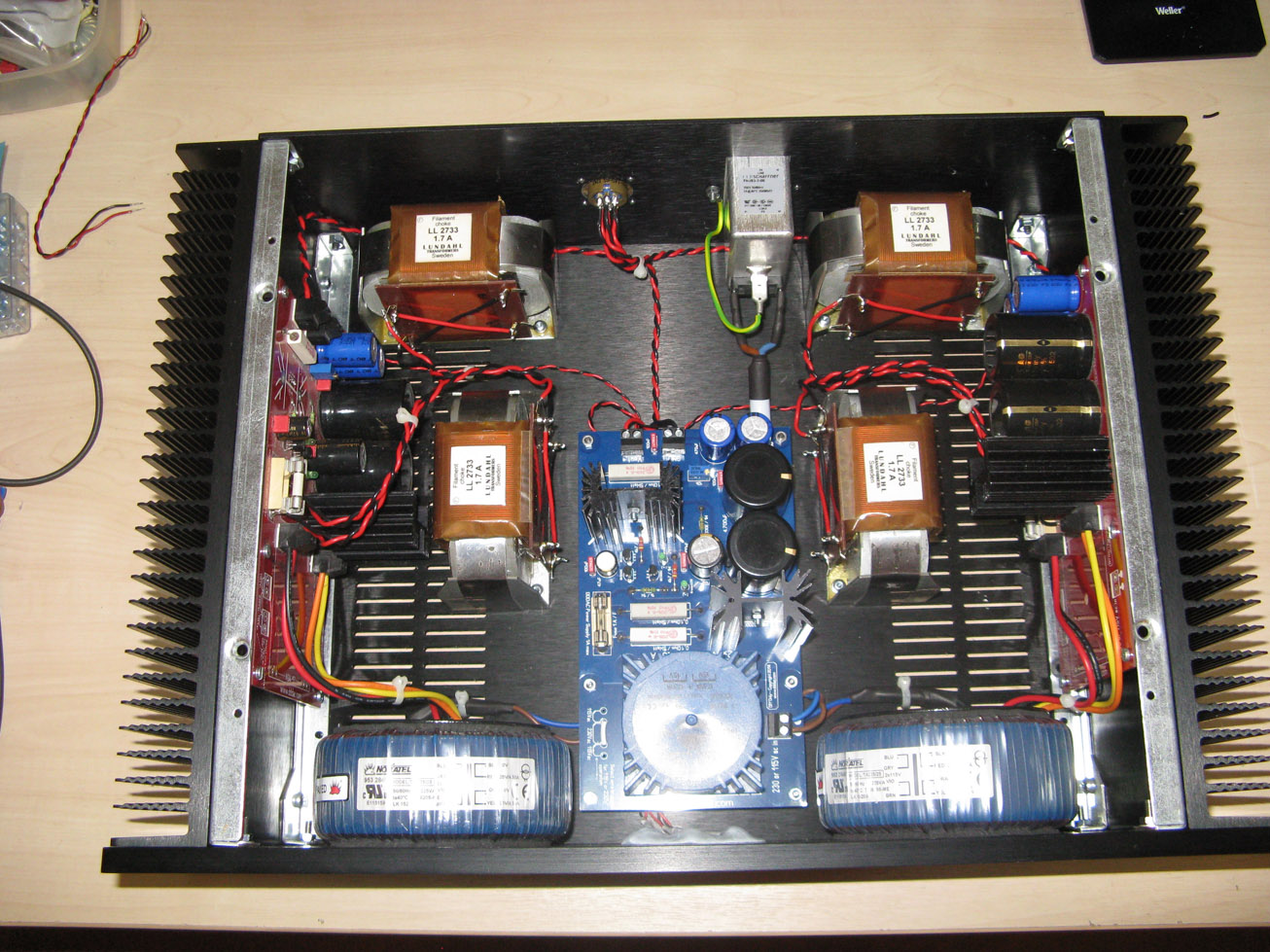

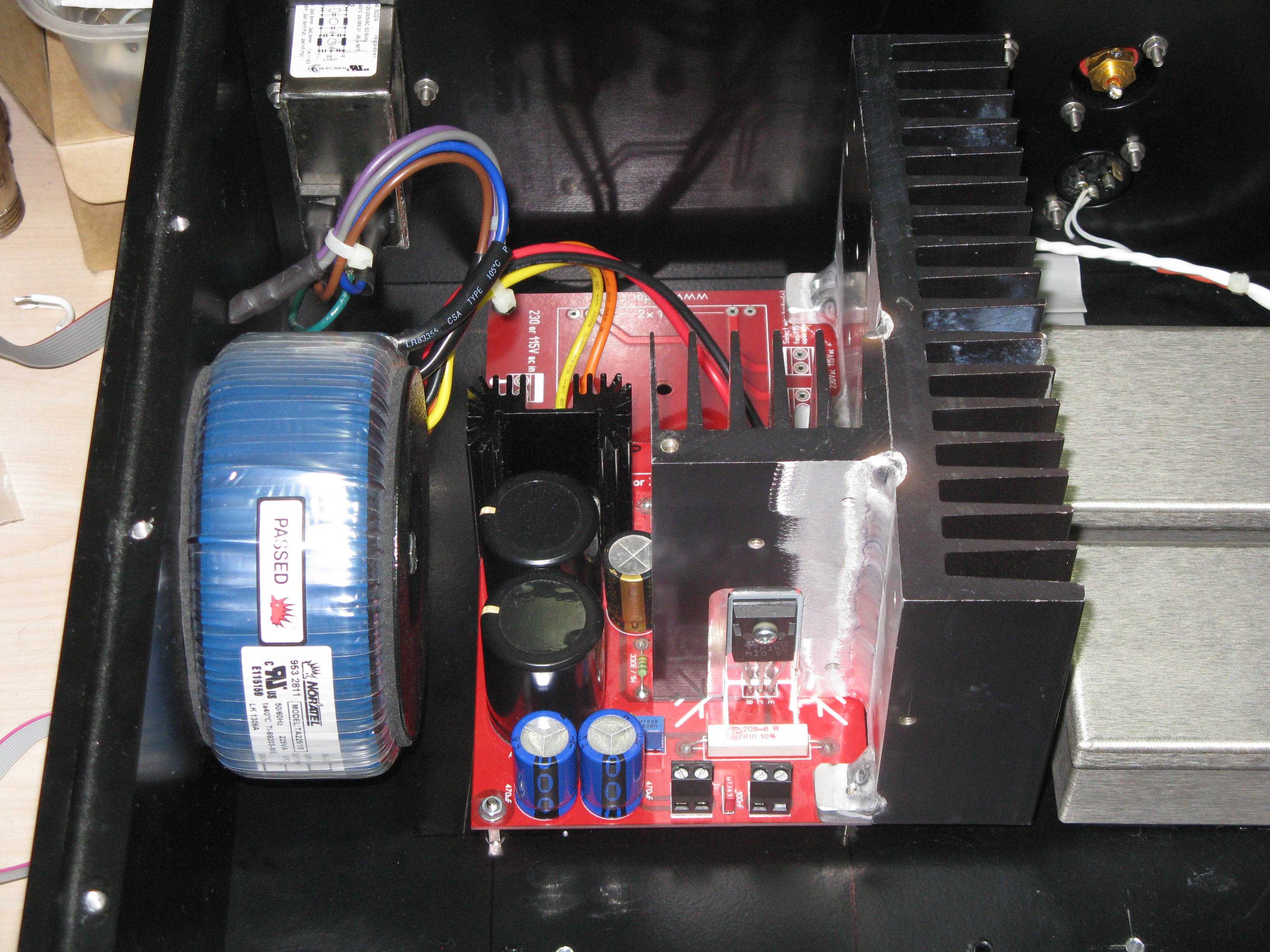

I have found the same result. I use the safety earth as intended i.e. the safety earth is only connected to the metal case or enclosure in one place.
There is no reason for the safety earth to be connected to any part other than the case.
See where I have connected the safety earth. I get no hum or any problem at all.

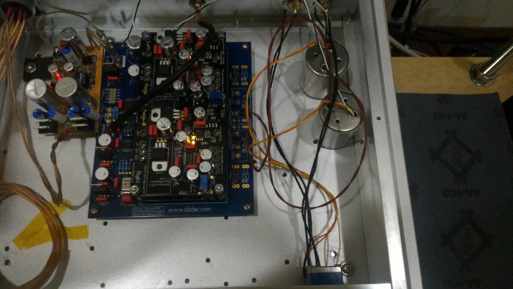

To get the most out of the transformer you should consider using it in balanced mode. That way you get twice the output. You would connect the primary side across the + and - outputs of the DAC, no cap required, and the secondary can then be connected to either a single ended or balanced circuit. Most of these transformers have shields and case grounds that need to be terminated as well as the signal connections. Review the transformer diagram to make sure you have the windings properly connected. You should be able to measure the dc resistance of the windings with an ohm meter.
P.S. I just had a look at the datasheet for the transformer. I would connect it like the Test Circuit 1 diagram at the bottom of the page using the 2 balanced DAC outputs from the tops of the 133 ohm resistors as the input to the transformer and then connecting your 10k output pot to the output side of the transformer. The shield and case connect as in the diagram. Case to chassis ground and shield to audio common.
If you still can't get any sound, disconnect the transformer completely and make sure the DAC is working in stock form. Perhaps there is another problem.

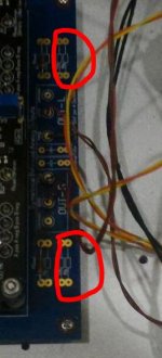

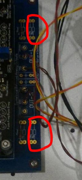

you need to put resistors here to make it work properly. With the transformer output you use both dacs (pos and neg) and one is not biased as you see.
with capacitor (SE) you have no problem as you only use one dac
also, volume pot should always be at the receiving side of things. the low output impedance (good for driving the interlink) is now thrown away.
the last point is audio tip, has nothing to with the noise. that is just adding the two Rload resistors
good luck !
doede
