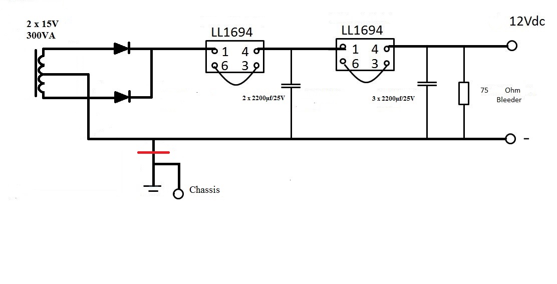

Grounding supply 12V
To make things clearer, here is my 12V power supply.
When I plug in without grounding the 0V (floating potential) I get without load with only the bleeder -->13.6 V
As soon as I refer to the ground the fuse of 1 A T disconnects.😕😕😕
Does anyone have an explanation
Thank you
Pierre
Thank you
Pierre
That looks a bit like the POS output of your PSU is connected to GND (by accident). Connecting the NEG output to GND would short the output, thus killing the fuse. Try to measure the resistance of the POS output to GND and see what you get.
