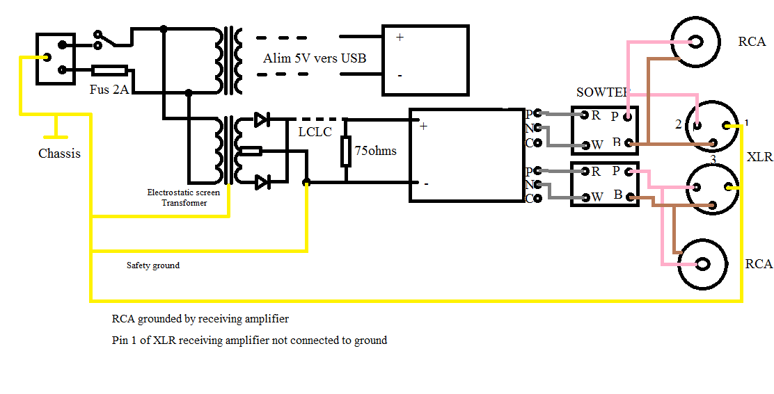

Here the schematic of my wires in particular the earth and the safery groundAs the pictures do not show a complete wired situation, I like to ask you to make a schematic drawing and post a picture of it.
Are you sure the usb board is not connected to anything except it's PSU? ;-)Here the schematic of my wires in particular the earth and the safery ground
Effectively I did not include the 2 flat cables to the motherboard and the LEDs on the front panel.

I believe the connection between the USB board and the DDDAC mainboard has a "GND" connection (I guess that's "digital zero"), which is probably connected to the NEG output of the 5V PSU. I am writing this out of memory, so you better check if this is correct.
You wrote in an earlier post that you connected the NEG output of the 5V PSU to chassis / safety earth (I believe). This connection is not shown in your drawing. Did you change that in your build?
Also, pin 3 of the XLR outputs are connected to chassis / safety earth via the rings of the RCA connectors, which are connected to the chassis. So pin 3 and pin 1 of the XLRs are connected to each other, which seems wrong to me. I have never tried to combine balanced (XLR) and unbalanced (RCA) outputs in the same unit, so I don't really know what's the best way to do this. Do you really need both?
Regarding your problem with the fuse blowing, I don't really know what's going on. I still suspect some kind of (hidden) wiring error.
Did you measure the resistances of the POS and NEG outputs of your 12V and 5V power supplies to chassis/safety-earth (as suggested earlier)?
Does the fuse also blow if you remove the connections of the PSUs to the DDDAC and the WaveIO board?

I just checked the USB connector of a commercial, CE-approved DAC with USB input (not the DDDAC). The chassis is properly connected to safety earth, but there is indeed no connection to the metal part of the USB connector. I don't know for sure, but it seems it might indeed be okay to have the USB input floating the chassis/safety-earth... mea culpa!
After the intervention of Doede I removed the connection to the chassisYou wrote in an earlier post that you connected the NEG output of the 5V PSU to chassis / safety earth (I believe). This connection is not shown in your drawing. Did you change that in your build?
according to your drawing you have connected the pin 1 and 3 of the xlr connectors together! (through your rca connectors!) ... i am not sure if this is something you want with your nice output transformers ;-)
I only use the RCA outputs and not the XLR. I await the response of Doede.according to your drawing you have connected the pin 1 and 3 of the xlr connectors together! (through your rca connectors!) ... i am not sure if this is something you want with your nice output transformers ;-)
I have been really thinking about your sketch and I tried a few things my self in my hobby room and I was not able to reproduce any problem. The sketch you posted is in fact ok. it should work. That is the technical side of things. What I do my self (for reasons) is to put the safety ground wire (green/yellow) from the power line to the chassis, the transformer screen and pin 1 from the XLR and using cables with the screen connected to pin 1 at ONLY the source side. The hot and cold, pin 2 and 3 are coming from the Output of the sowter transformer. The cinch outputs are floating versus the chassis, so the shielding comes from the signal (or chassis) ground from the receiving amplifier.
Ergo no clue why the fuse blows... but feel free to ignore it and let the 5V unit float with the USB Board
and.... even when you do not use XLR, it would make sense to at least wire them correctly, won't you agree?
Thanks for your answerI have been really thinking about your sketch and I tried a few things my self in my hobby room and I was not able to reproduce any problem. The sketch you posted is in fact ok. it should work. That is the technical side of things. What I do my self (for reasons) is to put the safety ground wire (green/yellow) from the power line to the chassis, the transformer screen and pin 1 from the XLR and using cables with the screen connected to pin 1 at ONLY the source side. The hot and cold, pin 2 and 3 are coming from the Output of the sowter transformer. The cinch outputs are floating versus the chassis, so the shielding comes from the signal (or chassis) ground from the receiving amplifier.
I will rectify my connections and keep you informed

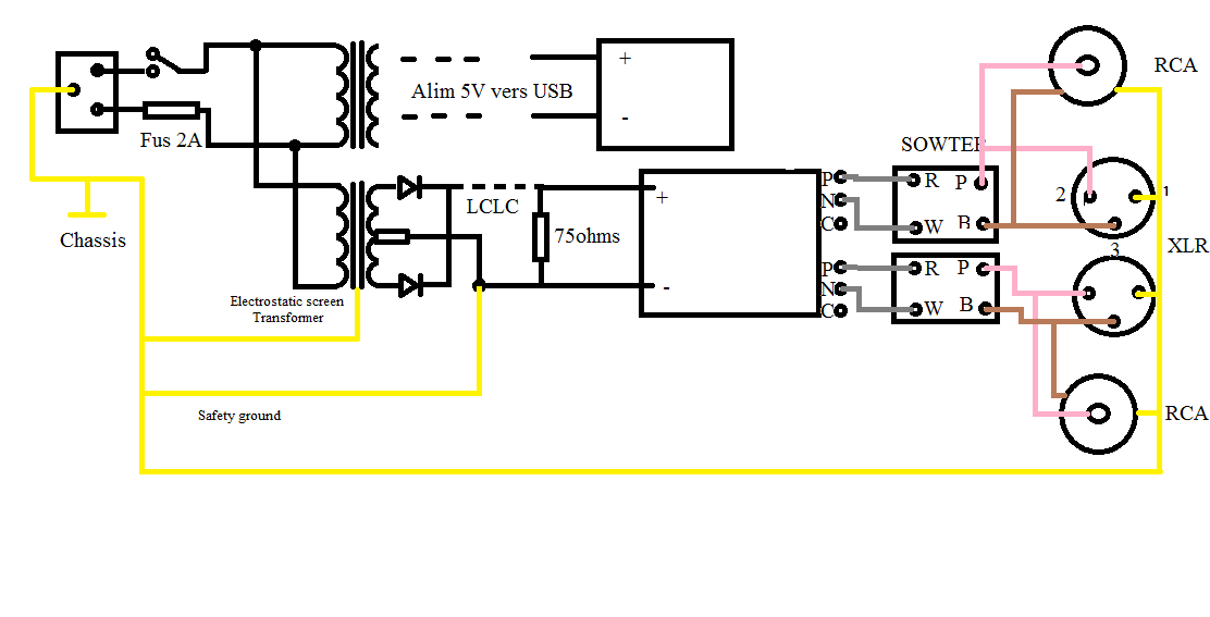

My schema will be the following
Small complementary question.
Even if I do not use the XLR plug should I connect on the pin1 the center plug (orange) of the sowter transformer?😕
