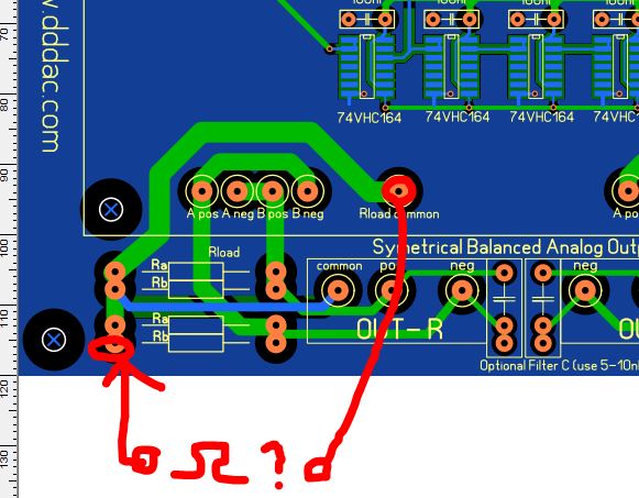

well these voltages are definitively wrong. it should be ~2,7 - 2,8V. before anything else this must be fixed. So first check: you did not install the 6.1 k resistor, right? only the current source? now did you trim all boards at 40mV? did you install the Rloads correctly and correct value? also check carefully if you have 8 Volt supply voltage at the DAC chips. Also post a nice high res image of the top dac board to check, also from the main board where the POS and NEG pins are
Hi Doede, the 6.1k resistor isn't on the board (although do I need to put a wire jumper in place instead?) Both channels of each deck are trimmed to 40mv. Rloads consist of 4 x 68r for each channel (I think this is correct for 4 decks)? Due to the size, I has to put 2 resistors on top and 2 underneath.
Just one question, how do I check the voltage at the DAC chips?
Thanks!

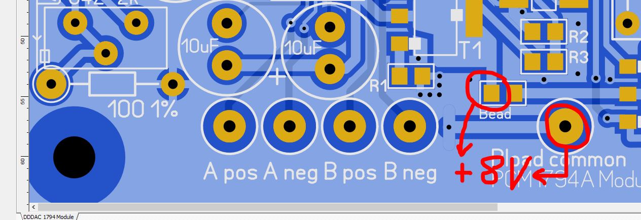

yes Rload is ok. For 8 Volt measuring see attached image.

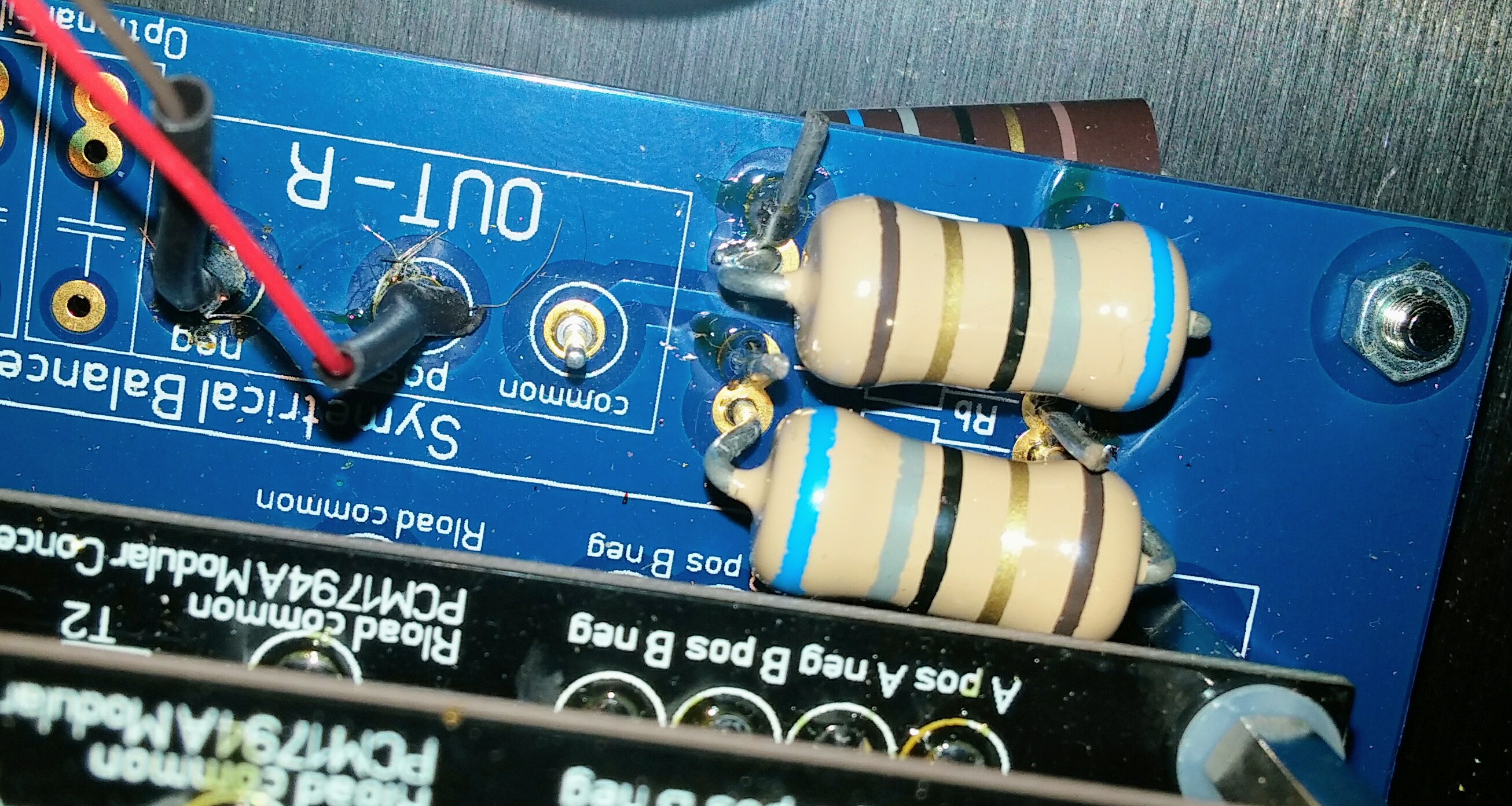

To be brutally honest, your soldering is a mess. I see wires touching the ground plane on many places. You really need to tidy this up before anything else... also where wires are going through the boards
As the voltage is clearly too high, there is still something not ok, or broken. Can you also measure the resistance value from the combined Rloads, just to be sure? must be 34 Ohms. measure this on the top dac board between common and the 4 pins individually (Apos, Aneg, Bpos, Bneg), please post the the 8 values you get (left and right x 4) Of course not powered on

Yes, the soldering on the output isn't my finest work. I also need to clean the flux so will tidy all of that up. I think I struggled with the size of the audio note resistors too. Feel a little embarrassed 😱
Resistance readings :
LEFT
A neg = 34
B pos = 34
A pos = 1k7
B neg = 1k7
RIGHT
A neg = 66
B pos = 66
A pos = 34
B neg =34
Doesn't seem right at all!

This looks like bad soldering joints at the wires going through the dac boards.
I would re-solder this(do all ! not only the A&B ones-just to be sure other stuff is not influenced as well) and measure again till all points are 34 Ohm
may be one check to see if all common tracks are still ok:
measure from the pins of the resistor at the outside of the board ( this is common) and the top located common as well GND at the input of the mainboard
please post these 4 values (left and right x 2 (top common & GND at input of board)
oh.... what about the 8 volt measurement?

I think you may have damaged the vias. This, together with the bad soldering (only on one side of the PCB) may have caused the issues...

OK, so I measure exactly 0.2ohm on each of the 4 measurements on the common tracks.
I will redo all the soldering and measure again.

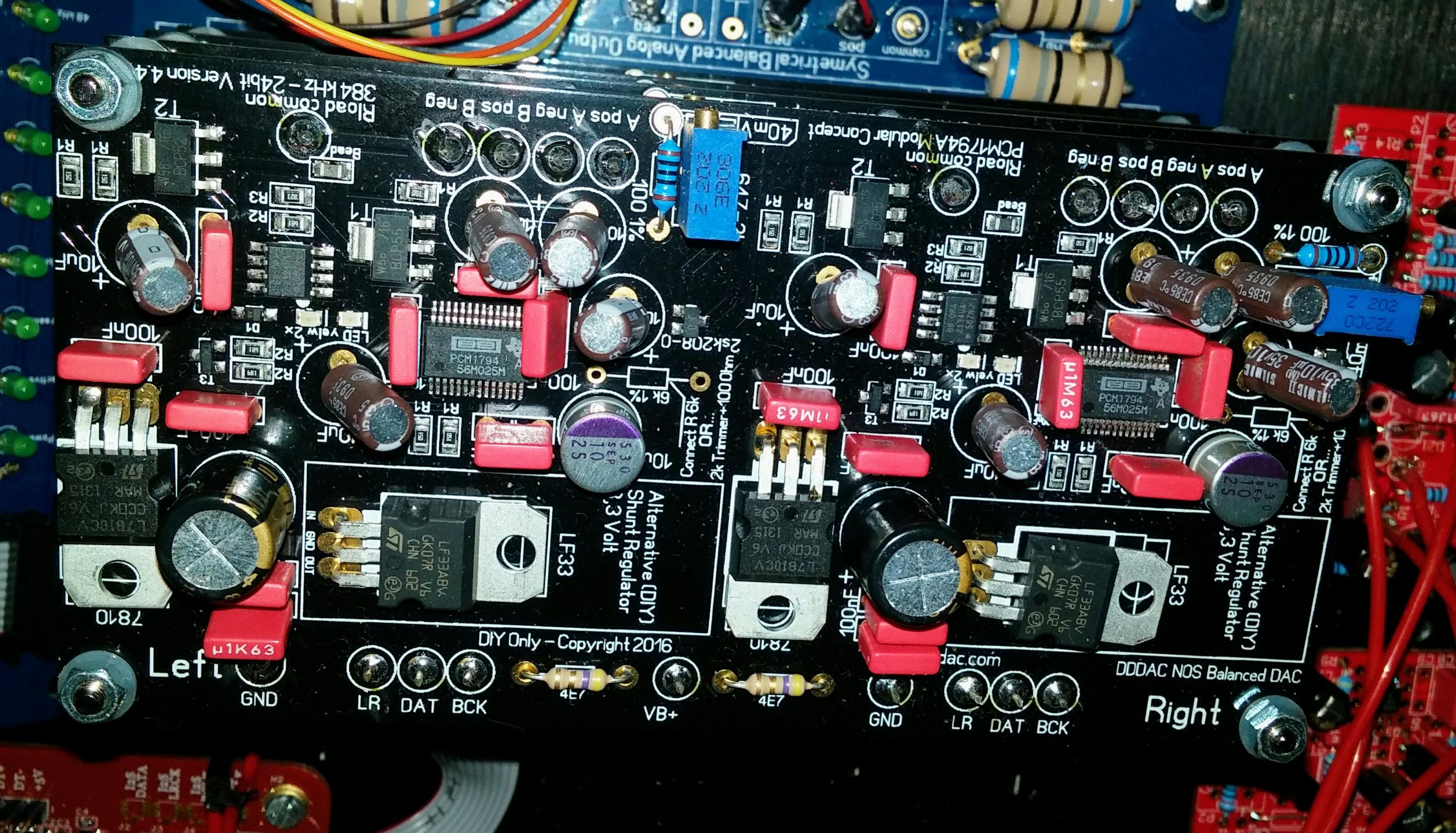

Voltage on the chip on right is 8.31v and left is 8.30v
Some very good measurements to report!....
All 8 DAC chips measure between 8.27v and 8.35v
After significant tidying up of the soldering (mainly around the IV resistors) I am getting between 33.4ohm and 33.6ohm across the board at each terminal.
Finally I am getting 2.8v pretty much bang on for positive and negative to common on both channels.
I haven't had chance to fire it up and check it is now making music but from those measurements I'm now confident!
THANK YOU, especially Doede, for all the help. It is appreciated more than I can express 🙂
