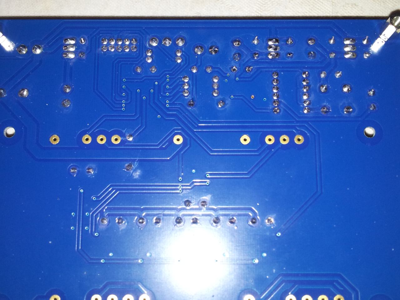

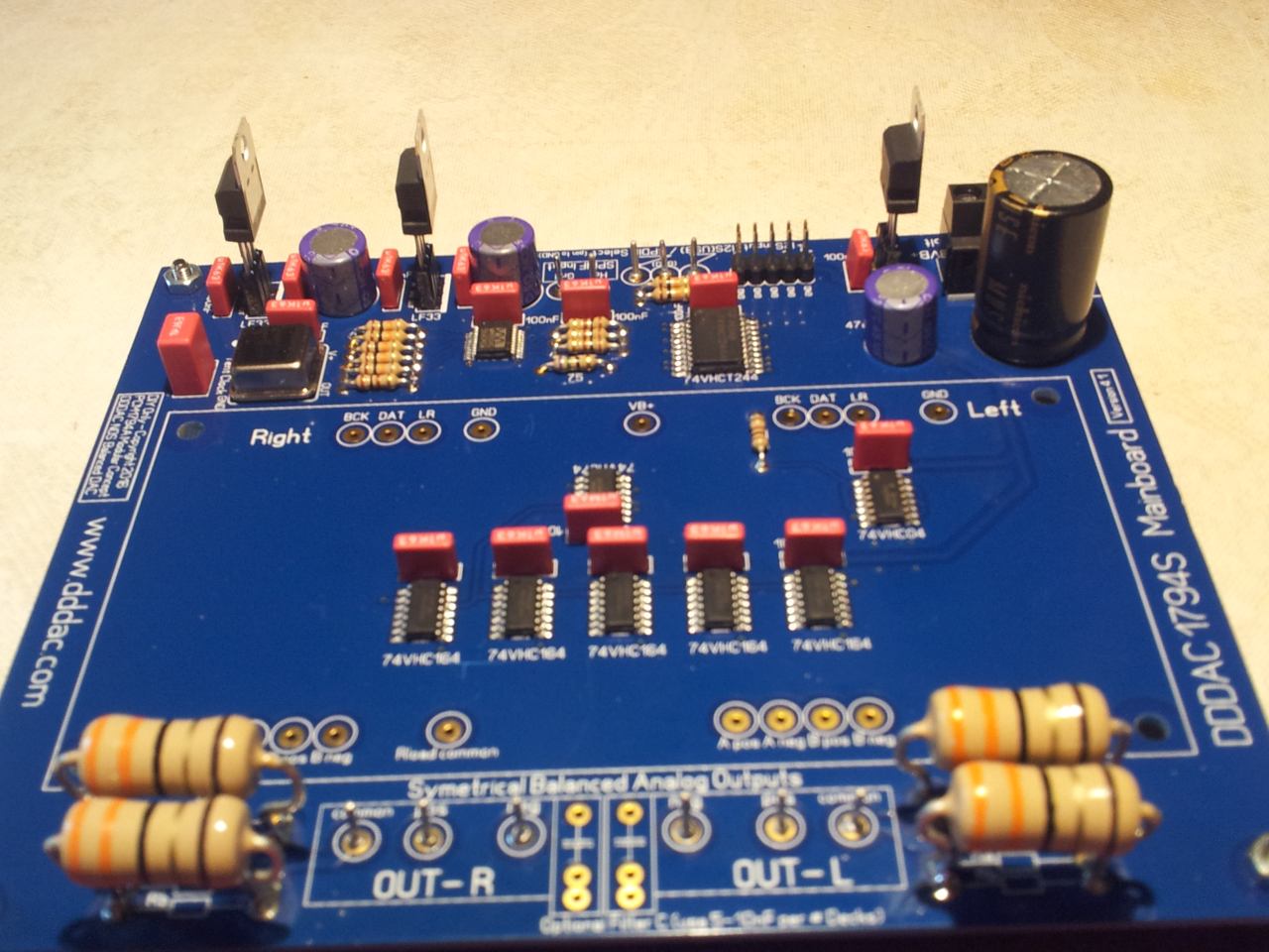

As you can see from the pictures I have no capacitor inversion or short circuit track.
The two capacitors of the power supply of the spdif receiver (C6 and C7) are practically in short circuit (resistance of a few ohms between + and -)
As this circuit only supplies the SPDIF receiver, I see only the solution of the defect of the WM 8804.
Does anyone see another possibility?😕😕
The main board is very nicely done so no component mis aligned. Have you tried some new capacitors, one could be shorting internally.
Of course bad news something is wrong. The conclusion that the chip is defective is a bit fast. many other things can have gone wrong. But if you are not experienced DIY in electronics, this can be tricky. Best way to work is on exclusion. So de-solder a few things and check if the short is still there. that way you can come quickly to Conclusiones. If you get stuck feel free to send the board to me for a quick check.
Hello Doede,
I have de soldered this morning C6 and C7 . They are not shorting internally ???
If you still agree, give me please by MP your address that I can send to you my motherboard for a quick check.
Thanks🙂
Pierre

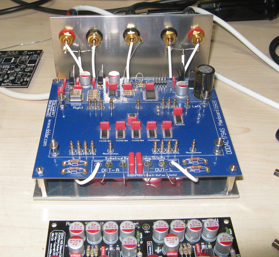

I have built a Dac board tester using a spare main board.
I used some very nice spring loaded PCB contacts made by Millmax.
I power the main board with a Lab power supply, so I only need to bolt the Dac board to my tester bringing the voltage up slowly before doing voltage tests, set the 40MV current source, and have a quick listen to make sure all is OK.
I need to know all my Dac boards are working properly because I am going for a 16 stack Tent powered board.

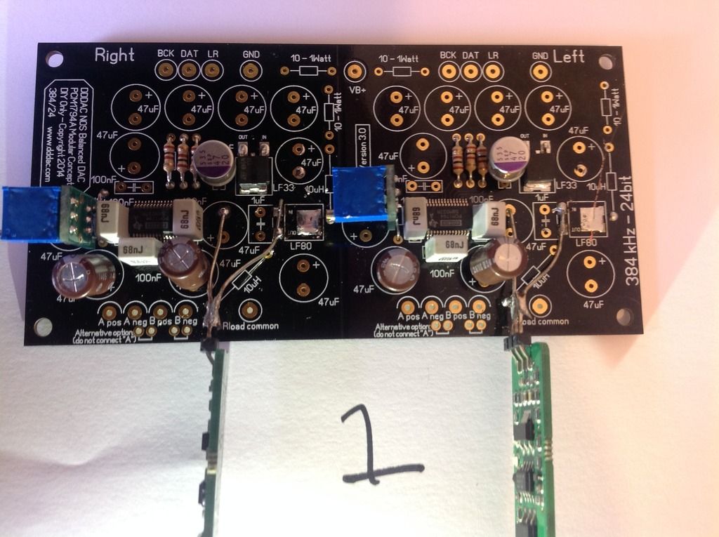

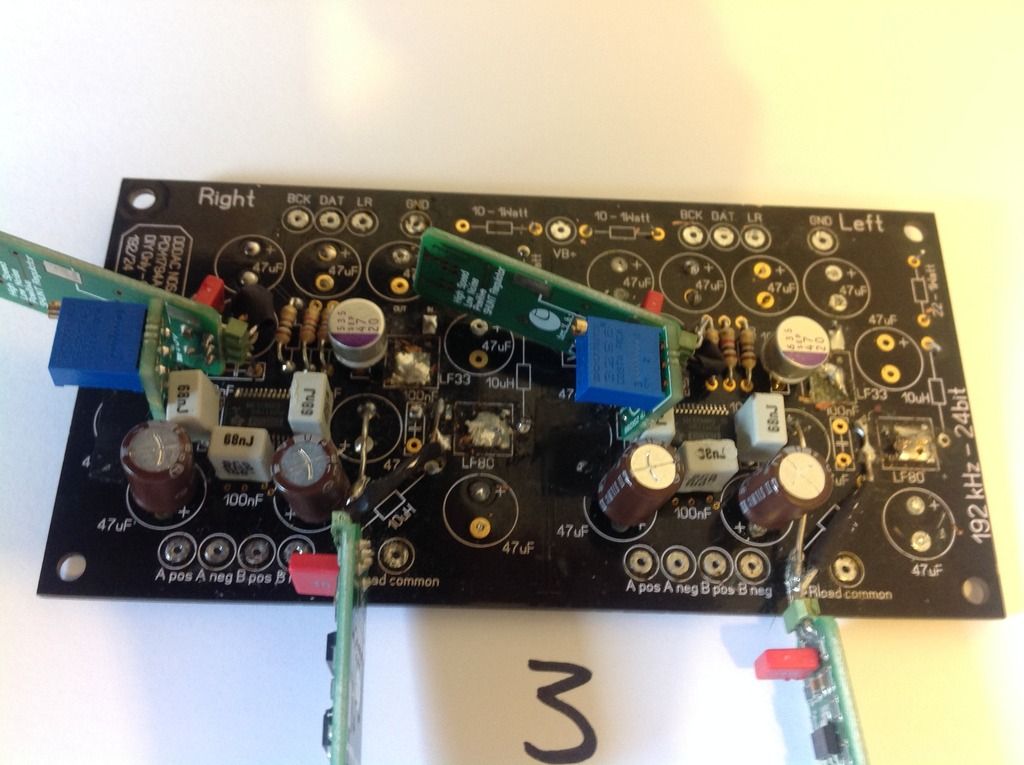

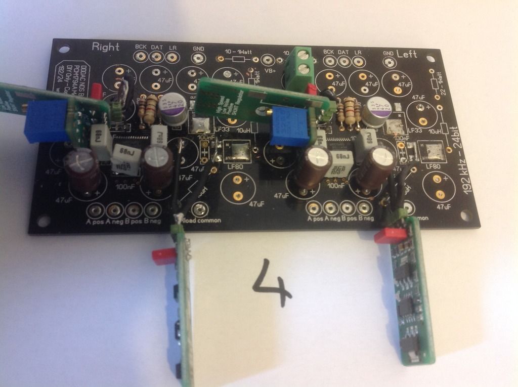

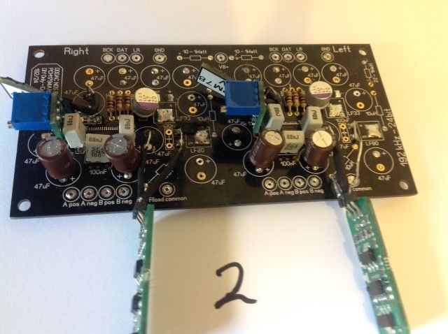

Hi there all.
I am posting as I am in need of some help. A couple of years ago I built my DDDAC. it was a two board DAC with an unregulated PSU and all sounded great. I decided to strip it down and turn it into a four board DAC with all the upgrades.
However I spent most of last year in hospital in an isolation room and I did most of the work to my DAC in my room, yes thats right, I brought most of my tools, heat gun and soldering station and was beavering away to help pass the weeks and months (thanks to Enrico for your help), but when I was in hospital I did make some ordering mistakes and this is where I need your help please.
The help I need is in regards to the different boards I am wanting to link together and to know if this is possible.
Board three and four are exactly the same.
However board two has Belleson shunts and not shunt regulators.
And you can see that board one has Tent Shunt regs on the analogue side and not the digital.
So the main question is can I use these boards as they are?
Thanks for your help.
They should work fine together. Assume they are function blocks that require unregulated power supply and I2S at the input with current out at their output. I presume you can test individual decks first to ensure their output is within the same DC range, once loaded with resistors.
Hi James,
Long time I don't have news from you... I hope you are fine and well recoved.
Regarding you boards what extreme_boki suggest you is correct, you should test the boards one by one before soldering the 4 boards together... the only diubt I have is regarding the board 1: you removed all the caps as is the correct conf for the shunt regulators but you are still using the original regulator from Doede. I would suggest to reinstall the caps as per Doede design. My it's just a suggestion, I never tried before...
Take care,
Enrico
