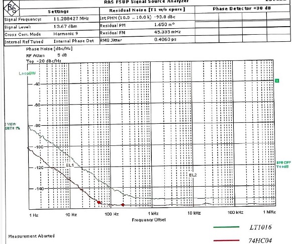

Hi Hans,
It looks the same and also different 😉 You are using one massive clock unit! I use a completely tweaked 4 stage dac board with unregulated choke power supply. If you filter my name in this thread you can see the mods I have done.
A bit off topic but is this board been jitter measured/compaired to the clocks on the cronos-hermes?
Hi Stefan,
I cannot save the pains for You to read through Andreas thread, but as far as I understand...
Andrea is trying to compare different well known oscillator circuits: clapp, driscoll, butler and pierce. Goal is to find the one that has lowest jitter, assuming that it will sound best. For testing equipment is not widely available and expensive, he will let them be tested, when finished.
Clock-jitter is an equivalent to phase noise. Clocks of equal frequency can be compared by their behaviour at 10Hz, 100 Hz, 1 kHz and so on. There are phase noise to jitter calculators.
Post #5 - clapp in a similar circuit than Andreas'
http://www.diyaudio.com/forums/digi...ow-phase-noise-jitter-crystal-oscillator.html
Post #34 - crystek cchd-957
http://www.diyaudio.com/forums/digi...-phase-noise-jitter-crystal-oscillator-4.html
Post #1279 - driscoll with an unselected cheap crystal
http://www.diyaudio.com/forums/digi...hase-noise-jitter-crystal-oscillator-128.html
Post #1280 - Listening Session
- end of being off topic. If You want, continue by pm...
Hans
