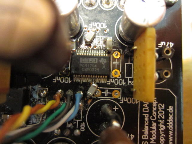

The silver 99.99% wire for joining the dac boards is 0.8 Diameter.

That's right, Screenshot shows Drill Hole 1mm so 0.8 would be suitable.

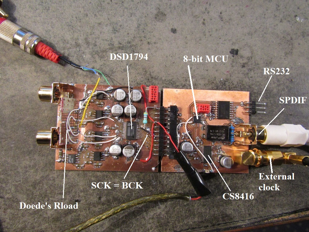

I started with the 1794 standard TI application notes but along the way I found out about Doede's novel design and I'm certainly curious to try it out.
I used a DSD1794 because it has programmable volume control capability which unfortunately doesn't work anymore when no digital filter is selected but, icing on the cake, the SPDIF receiver CS8416 can be set to output audio data as right-justified so I just had to:
- change the CS8416 and DSD1794 setup by software (I2C)
- cut the tracks going to the I/V active stage and add a small pcb as per Doede's Rload
- connect SCK to BCK
and it works (SPDIF sampling rate is 88200, external clock is 22.5792Mhz).
I'll probably end up building 2 DACs: the standard one and the one along Doede's design and then do a listening compare.

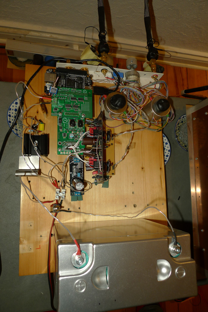

yes , those are sowter 9335 attenuators (occ wired) and i am very pleased with them even with just single dac deck. i measured the 9335 with square wave 1k and did not see any significant resonance up to 100khz !!
according to brian sowter these transformers can handle up to 50 uA. the dcr of 9335 is about 700 ohms so even with 10mv dc offset the current would be in a very safe side (=14 ua). in my case i measure an offset of just 0.3mv (!!) at the dac output.

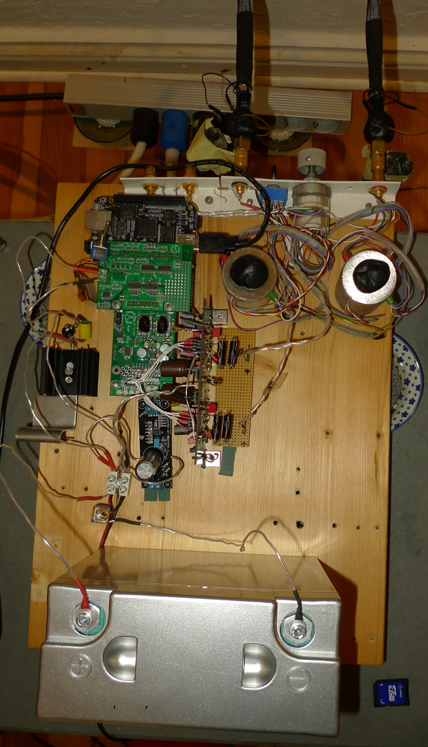

the music is streamed using bbb-hermes-cronus directly to the dac without the main broad as suggested earlier by jürgen. the whole chain (incl. a 4tb hard drive) is supplied by a single 12v, 20ah lifepo4 battery which lasts for approx 15h of enjoying music ;-) .
please find attached some pics of the current set up.
