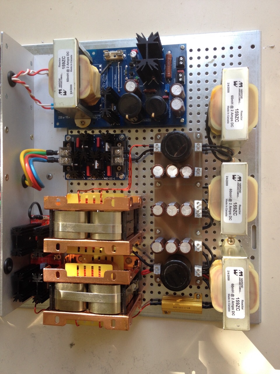

Many thanks! It is pain stacking progress as us two are all having day job and family commitments! I seriously am missing this DAC...! Have few others, off the shelves DACs, are simply not the same flavoursome! 🙁Keep the photographs coming Chanh, it looks fantastic
Here is the power-supplies at this point in time. Will make use of tomorrow (Saturday)for better progress.

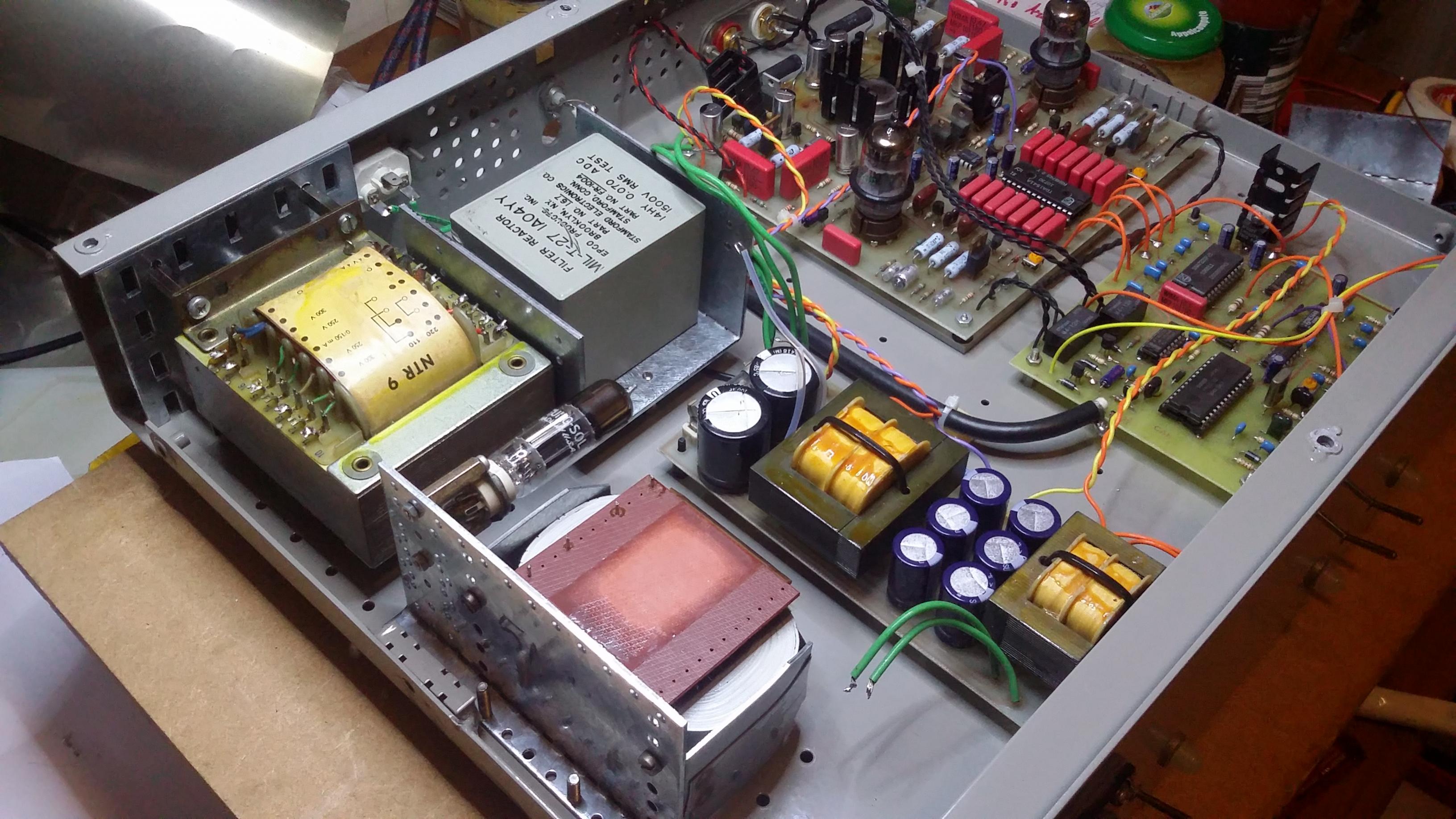

Hello Chanh,
Being in the metal business for 25 years i would advice you to use some kind of reinforcement otherwise while lifting it you could put to much stress on the circuit boards and cause miniscule cracks in the tracks which could be very hard to find. Something in the shape of a metal picture frame and having the same hole pattern like the circuit board and connect that underneath the perforated panel using the four bolts in the corners and one half way in between them.
The hammond chokes dont buzz when you use them with choke input? Because they are so cheap and small ( compared to Lundahl) i wanna try and use them in my present dac too for 2 lower voltages needed in my circuit.
The tube part will be powered by tube rectifier, common mode choke input (Lundahl), another choke further down the line, maybe some black gates too because i still have these in abundance from a deleted project.
Greetings, Eduard

Many thanks for your interests Guys! will post more photos in due course. From what I've seen today, I'm overly impressed. All credits to my good friend, who is extremely kind with diligence and attention to detail in assisting me with this works. It is beyond what I have hoped for from my personal's DIY perspective.
He is currently finalising both back and front panels' layout for the CNC process to kick start. A capacitor board will also be custom made to suit current Power-supplies layout. No messy wiring..! Going to be interesting..!
@Edward - many thanks for your tips in structural reinforcement! As Structural Engineer, that was my second nature! 😉 In regards to your query, these Hammond chokes are fantastic! Dead quiet (no hiss or whatsoever) as choke in put. Actually it performs better than my much costly copper chokes. The only disadvantage is they are 2A max. Therefore, I use them as second choke and using those 5A as choke input! The price I paid for each was US$28 each, so I cleaned them out! 😀
Hope to keep you guys posted soon.
Chanh

Hello Chanh,
The lundahl chokes are very good BUT they are to big to use them in all spots where i want to use a choke. SO i just use one for the tube stage in my dac. It is 64 Henry. I can use this value because the current including bleeding current is around 50 mA. 50mA also allows the use of a tube rectifier.
All the other voltages i need are below 20 volts and current below 200mA so choke input can be possible using the Hammond chokes because they offer a lot of choice and did find an addres in europe with lower prices than the ones in Canada.
One transformer is used to make +15 volt and -18 volts by using RC network to adjust output which is fed into solid state regulator. So i can do this too with choosing input chokes with different serie resistance and maybe a small rc network to do '' fine tuning ''
Of course have to get a small new power transformer. A so called split bobbin for 115 volts because the rest are 115 primary too. The original one is 2*14 volts with choke input it will end up 2*18 or even 2*24 volts. Will do some test with parts lying around before ordering.
Of course modifications have to be done step by step.
The transformer and the 2 chokes will take maximum 100$ so peanuts compared to the dddacc.
After that some resistor replacement in the actual circuit i guess well below 100$
Cap replacement? Have loads of them so no expenses here.
Hope the new boards will arrive soon so i will have something to compare lol.
greetings Eduard.
P.s Chanh you can use rubber gromets? to mount the circuit boards so that there will be no deformation of the board while the chassis is lifted.

Update on DDDAC's power supplies!
Hey guys!
After some spare hours during the weekend, my friend "Don" had came up with a PCB for the caps and he is getting closer to finalise the below deck compartment of raw unregulated power supplies for DAC and BBB.
Next up will be CNC for front and rear panels!
Hey guys!
