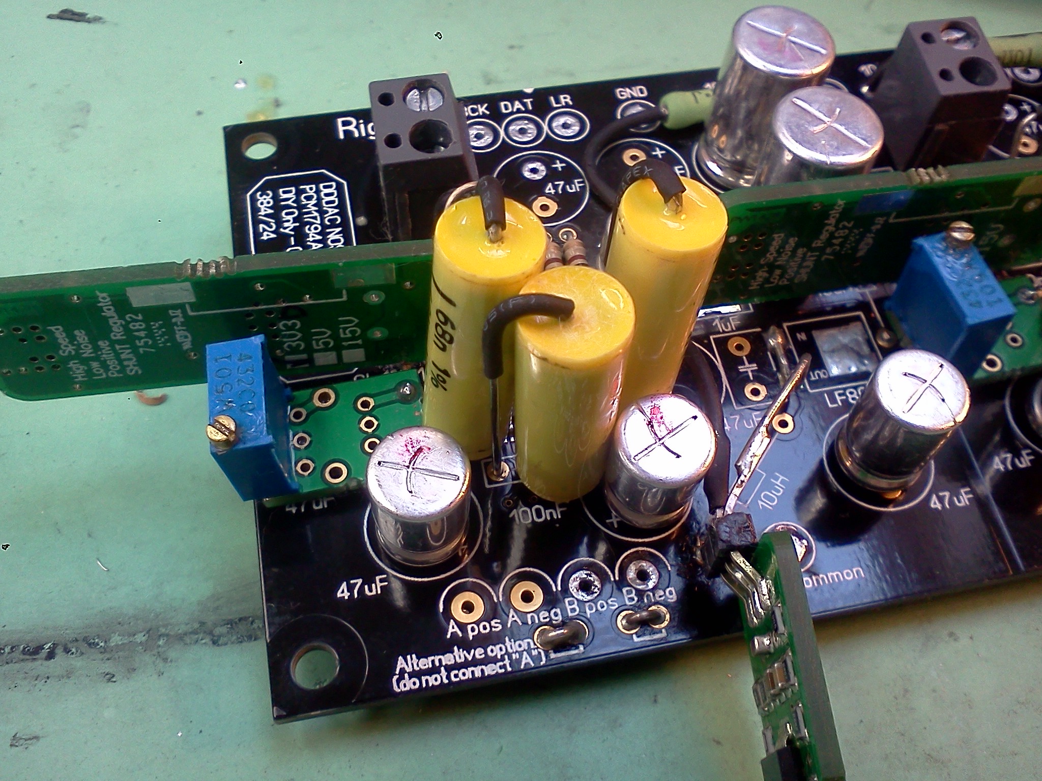

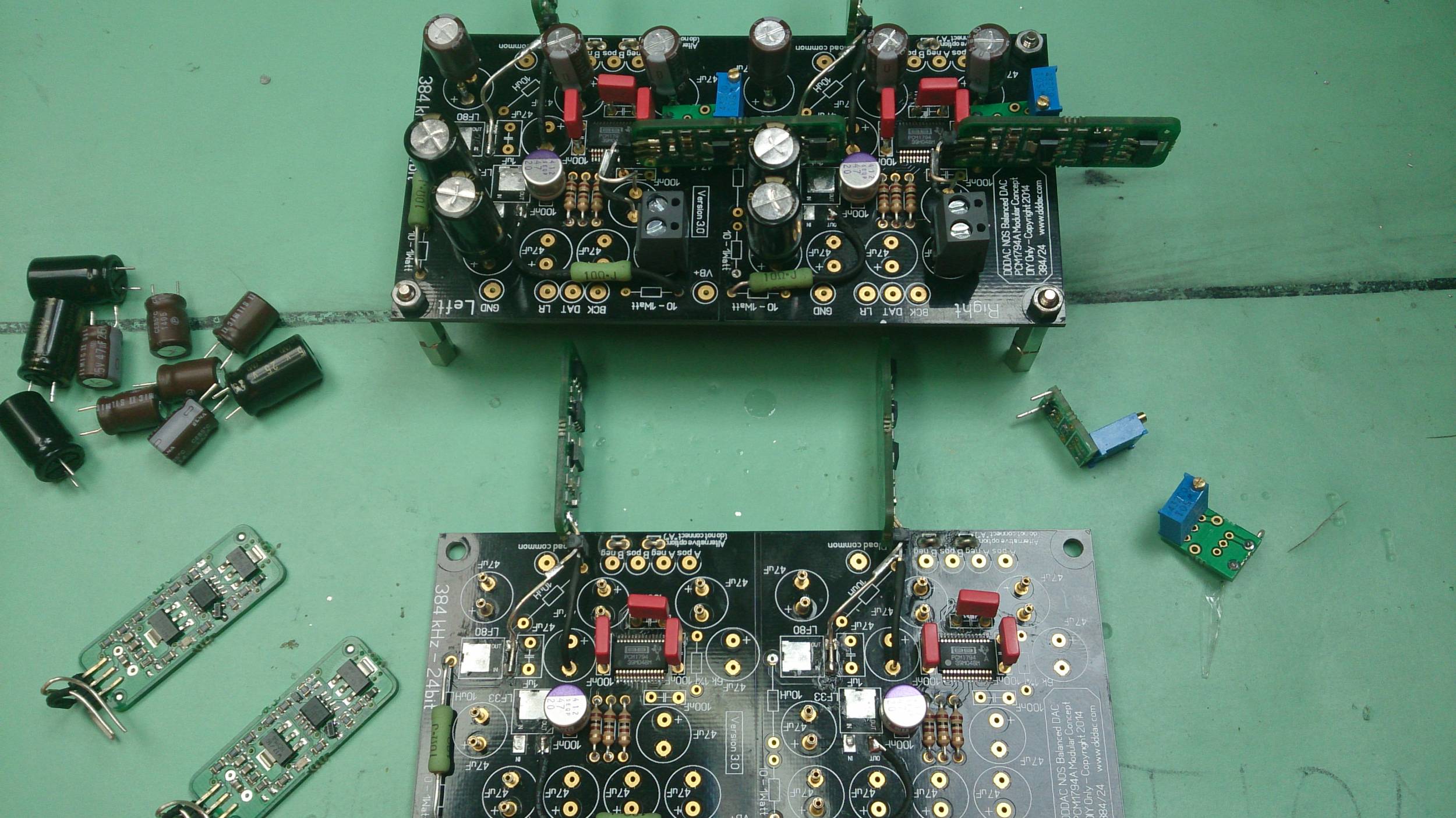

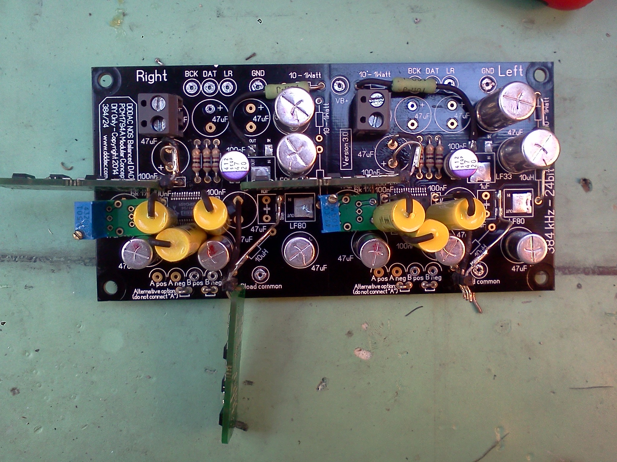

Hi all, my DDAC kit arrived 🙂 and I've been busy getting the case design figured out and collecting the other bits and pieces I need. I would appreciate your views and advice regarding the configuration in my photo. This is a 4 stack DDDAC with two of the boards upside down, the edges carrying bits are lined up - the edges with analogue are separate, but will be connected together of course. The reason for doing this is to fit a 4 stack DDDAC into a 2U case. I can use 10mm spacers as shown which actually gives 22mm between boards (as they alternate) - so if I decide to fit shunt regulators I have a bit more room for them.
Is there any reason you guys can see that this wouldn't work, or is a bad idea for some reason?
(answers regarding the music coming out upside down will be given due consideration!!!)
It is definitively a clever solution and technically there is nothing against it as far as I am concerned. The 120 TDA1543 DAC uses much longer routes for the signals and sounded better than 60, so long wires did not degrade completely. I also tried other things in test set ups with 30cm clip wires and never had the idea it degraded. IF it goes wrong you have digital drop outs and distortion, so you know in a second....
Thanks for your response on this. Sounds likely it will work and possibly even a 2+2 configuration would be ok. I'll report back on the outcome once I've done some more soldering!
