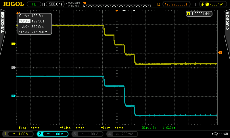

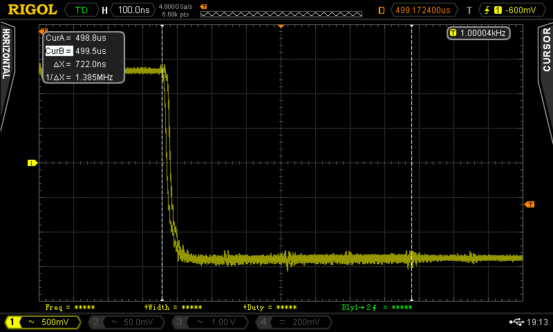

Ah, interesting link, which probably makes sense! I tried to verify this by trying to measure the effects of multiple boards on jitter as I do have this 10ns jitter due to the synchronous reclocking via Acko's reclocking module. (I have a 4-deck setup).

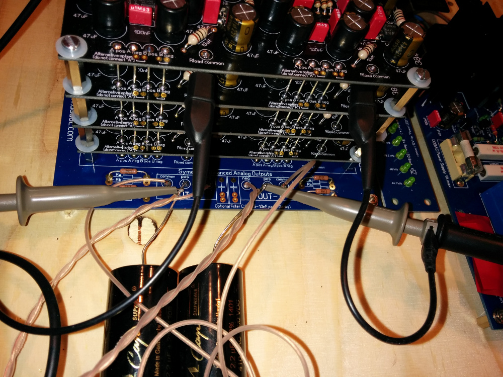

For the test setup, I am simply measuring the output after the I/V resistors when playing a 1kHz square wave at 44.1 kHz/16bit. Interestingly, the 10ns jitter propagates right to the output of the DAC as can be seen in the following picture (right channel):

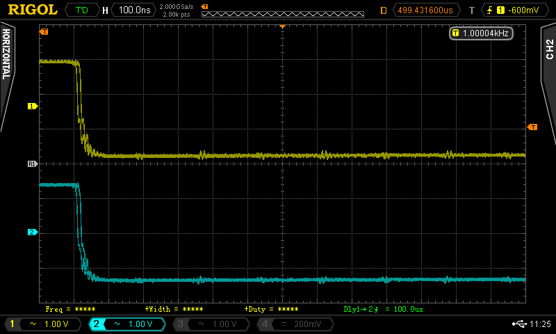

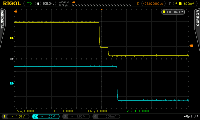

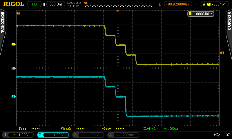

For comparison, I measured the left channel - and uh, oh, look at the square wave: 😱

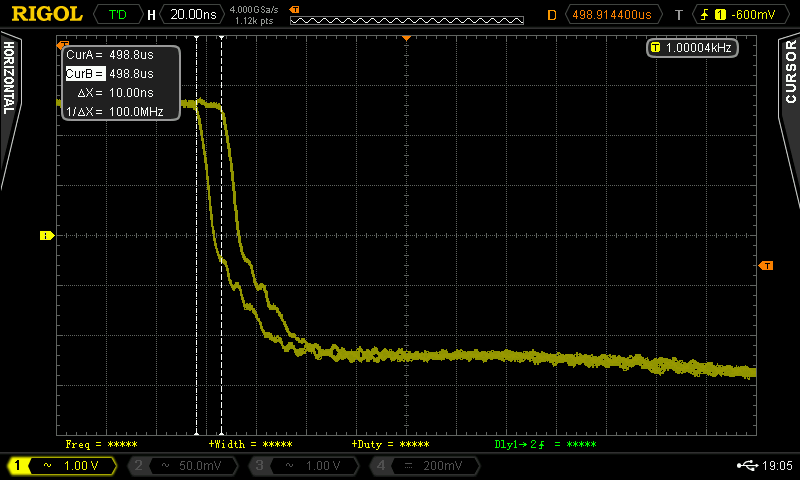

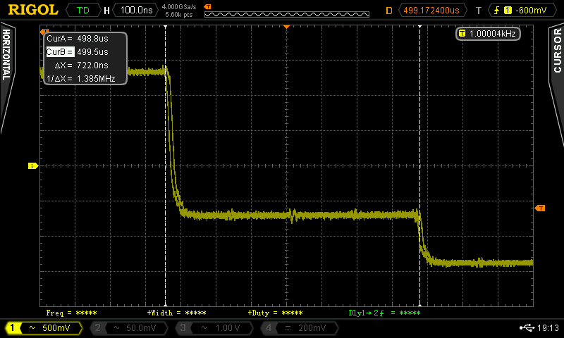

One can easily see the 10ns jitter but there's a stairstep after 722ns there that is absent on the right channel which can be seen here:

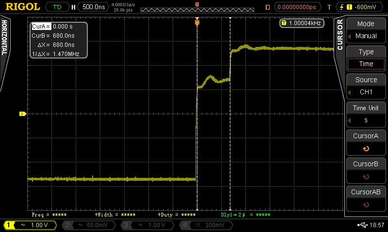

The rising edge on the left channel has a similar pattern:
Hmmm, as the stair-step is approx 1/4 of the full signal height it seems that one of the decks has some strange error. 🙁 Oh my, I should not have brought up this theory of a broken deck that distorts the signal and is "overruled" by adding other decks. It's like a self-fulfilling prophecy...
Well, before disassembling my 4-deck stack, I wanted to know if anyone has a clue what this could be / why this would happen? What's furthermore interesting is that I measured the signal also between "ground - negative" and "ground - positive" on the left channel, with the same results.
I find it also very interesting that the faulty deck is obviously not fully broken but the signal output seems to be delayed for ~ 700ns. Perhaps there's some capacitor broken or not soldered well?
Any help is appreciated!

How strange Hermann, but how nice to be able to see the problem clearly. I wonder if you should check your resistors on you dac boards. Each channel has a group of 3 resistors and the middle one's job is to delay the audio signal by a specific amount. If you have a blue mainboard I think they should all be 100r or 1k for the Red main board. That would be my guess.

Hmmm, just had a look at the decks & schematics of the DAC decks - yes, I can see 3* 100 Ohm resistors, but they are between the I2S signals and the PCM1794A - how would a resistor delay the signal? (Don't get it).

Many thanks for your input, I did single ended measurements as you recommended (for the FFT I did not get better results but I don't want to concentrate on this further as I fear that the FFT of my DSO is not precise enough (12 bit) to get decent results).
I investigated the problem further and it seems that no deck is broken, but the problem is somewhere in the digital domain. First of all my measurement setup:
At first I switched everything on - and surprise - no stairstep, all o.k. Only the 10ns jitter from the synchronous reclocking as expected:
Interesting - I did not change anything since yesterday except maybe the placement of the probes. O.k., then I then replaced the S03 reclocker by the isolator to check jitter on this one, once again, a clean signal (with 2ns jitter) and I switched back to the S03 - and wow, the stairstep is back again 😱 :
Hmmm, resetting the DDDAC (Power off/on) results in a different pattern:
One can see here that a stairstep has the length of BCK. Interesting. When I reset the RPi, or simply press "pause/play", the pattern changes again, sometimes the signal is clean on one channel:
However, I could not get back to the clean signal, I tried resetting everything once again, no chance. Replacing the reclocker to the isolator and back makes no difference, too. Hmmm, I can't figure out what I did initially so that the output was clean? Maybe some capacitance is building up in some way?
Hmmm, I did change the I2S cables during operation, perhaps this is not a good idea as something gets "unsychronized"? Nevertheless, this effect should go away, if I reset everything, right?
Anyway, the problem is quite likely in the digital domain, however, I have no clue how to solve this - any ideas?
