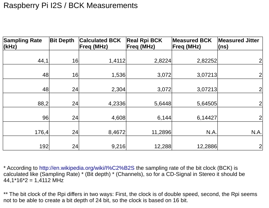

So, asynchronous reclocking can only lock the jittered signal to the phase of the master clock, thus introducing so to say "fixed jitter" instead of "random jitter".
The other is the fact that the RPi can only do 16 bit which can be deduced from the measurements of the I2S clock speed:
attachment.php
So this new knowledge - which I could only gain through simple DSO measurements - lead me to other, new ideas as I'd like to have 24bit resolution along with a jitter of < 100ps as I personally think, lower jitter is better. So the best way to do so would be (I think):
  • Use the BBB with synchronous reclocking, which has the disadvantage that I currently have to manually switch clocks for different sampling rates.
  • Use some other embedded computer that can generate an I2S signal with 16/24 bit depth in all sampling rates - regardless if jitter is added or not (unclear which device this would be - RPi can't do 24bit, BBB can't do 44.1kHz signals). Then combine it with Ian's reclocker, which buffers the signal and thus eliminates any kind of jitter. (However, it seems that it's hard to get).
Best Regards,
Hermann

Look up the botic driver by miero for the BBB in the TPA forum to solve this problem,
You then need two clocks on the s03 and abracadabra peanut butter sandwiches , synchronous clocking at the correct format rate......
Easy and cheap.....well not exactly cheap, but considering the cost of some of our gear......
