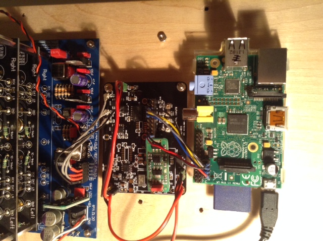

Hi All,
After getting tired of waiting for the botic cape on bbb, I decided to try the Acko S03 pcb.
I just finished this board before the christmas holidays; I am afraid my family will miss me the next week 🙁😀🙁
I build the board accoring to the instructions from Acko and this post from Palmito:
http://www.diyaudio.com/forums/group-buys/227502-amanero-isolator-reclocker-gb-98.html#post3916986
The schematic of this post has a mistake, the power from rpi to isolator is drawn on the left pin, this must be moved one pin to the right.
Thanks to James for pointing this out!

I thought the orientation of the shunt was the other way around, are you using the "positive" version?
@All, Merry Christmas and very best wishes for the new year!
This is the positive version shunt. If you look at the pcb traces on the S03 you will notice that it is oriented the other way around; input of the shunt is orented to the clock. You also need to solder the wire bridge on the underside of the pcb.
If you need assistance for setting the right current on the the Tent shunts please let me know.

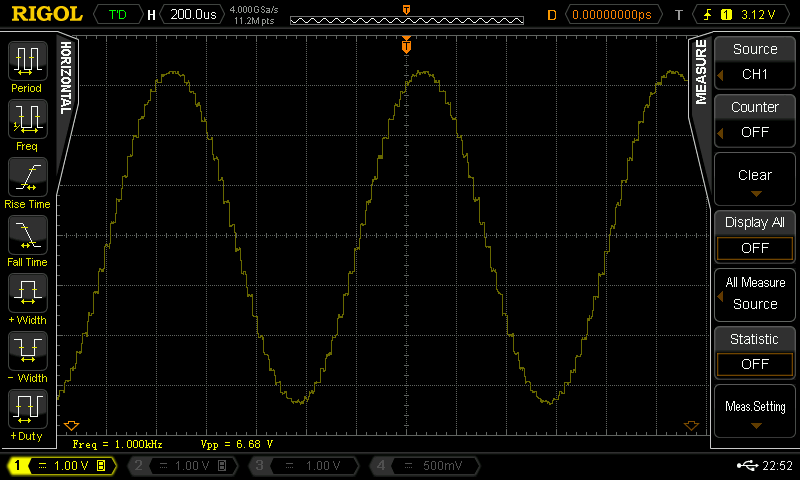

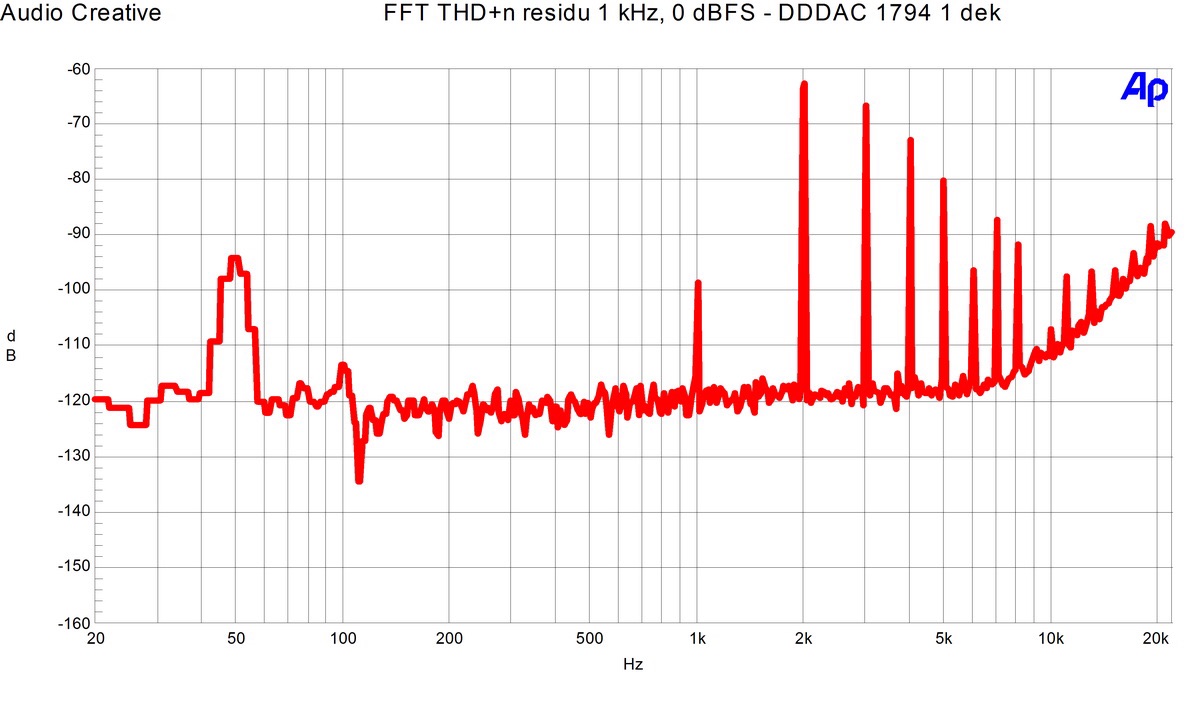

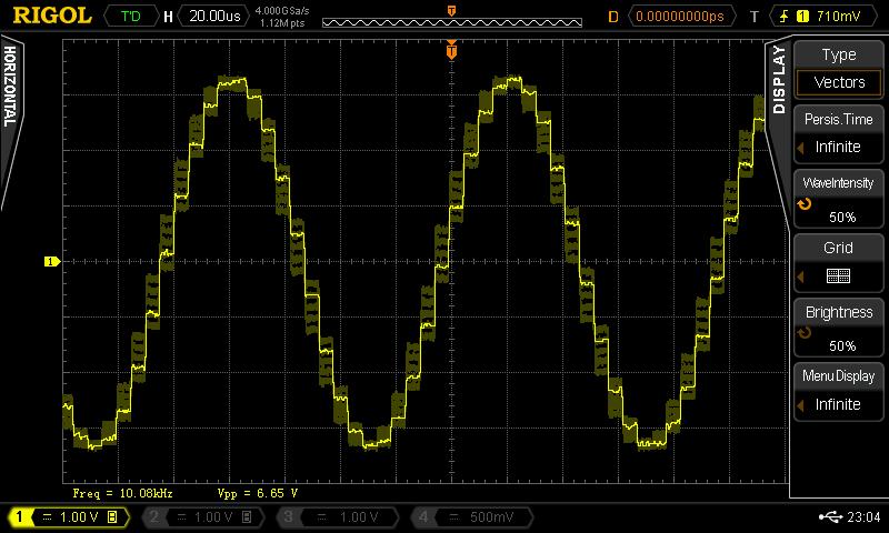

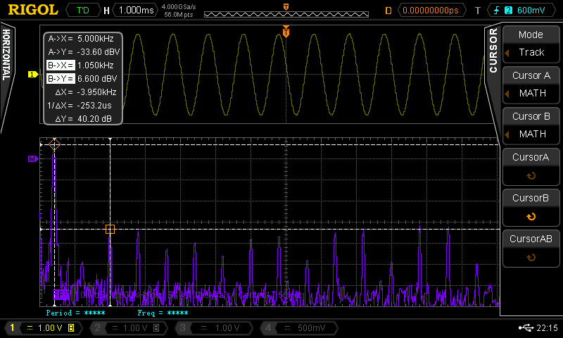

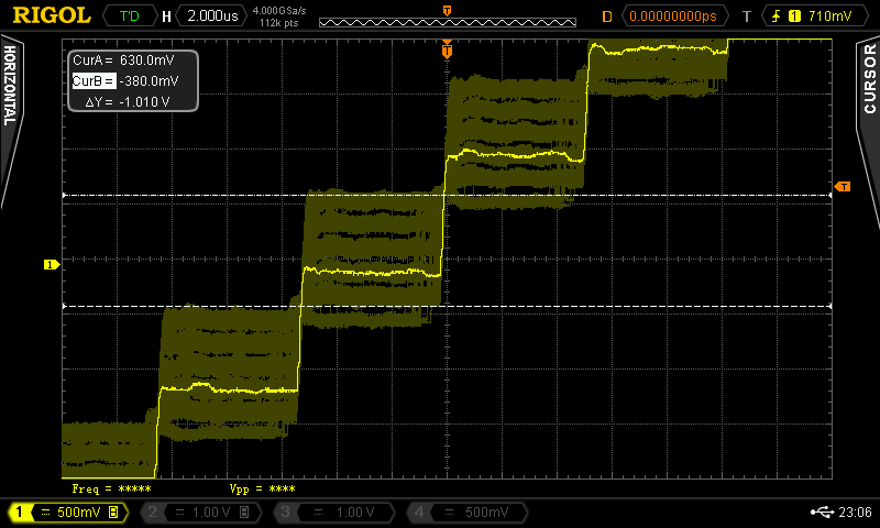

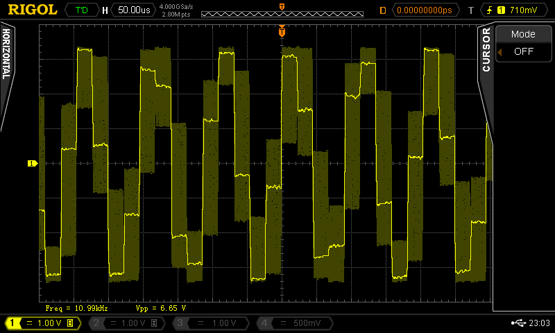

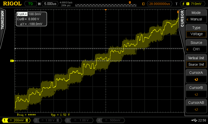

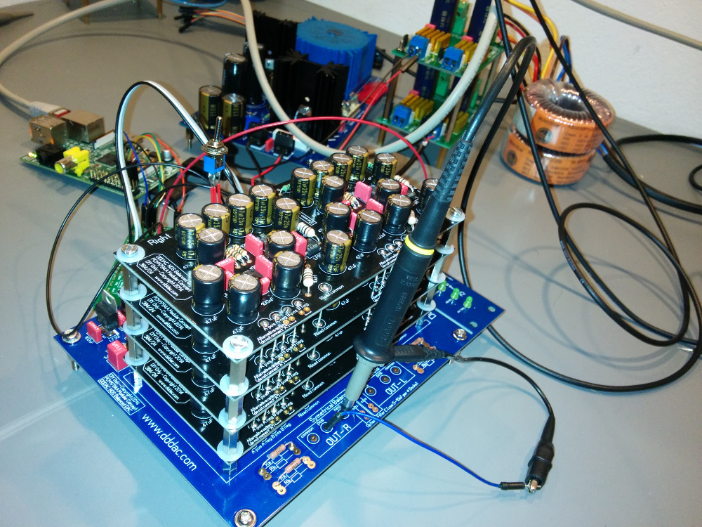

4-Deck DDDAC - some measurement
Hi all,
As I recently finished the build of a 4-Deck DDDAC, I did some function checks with my Rigol DSO. As there seem to be not too many images of measurements out there I thought I'd post some of the screens in this forum. My build is a combination of a 4-Deck DDDAC, an DIYINKH isolator, the DDDAC power supply, a RPi and a DIYINKH power supply for the RPi.
The measurements include the following:
Moreover, what I don't understand further is that the FFT measurements did not change a lot when switching from a 44.1kHz to 19kHz sample rate. That's true even for the 10kHz signal, whereas the stair-steps make a huge difference in the time-domain but seemingly not in the frequency domain.
Maybe the FFT of my DSO is not good enough? Or am I missing something here?
Next I'm going to implement the Acko Reclocker - I wonder if this will lead to different measurement results or if they will be that small that they can't be seen with my equipment.
Best Regards,
Hermann

Did you check my website for comparison?
When looking at your measurement setup I see you put the earth of the scope to the positive output pin. Did you try making single ende measurements to avoid putting one output to your mains earth?
Otherwise hard to judge as I do not know what source you used, bit level of the sine waves etc.
I normally measure aproximately-55 to -60 dB

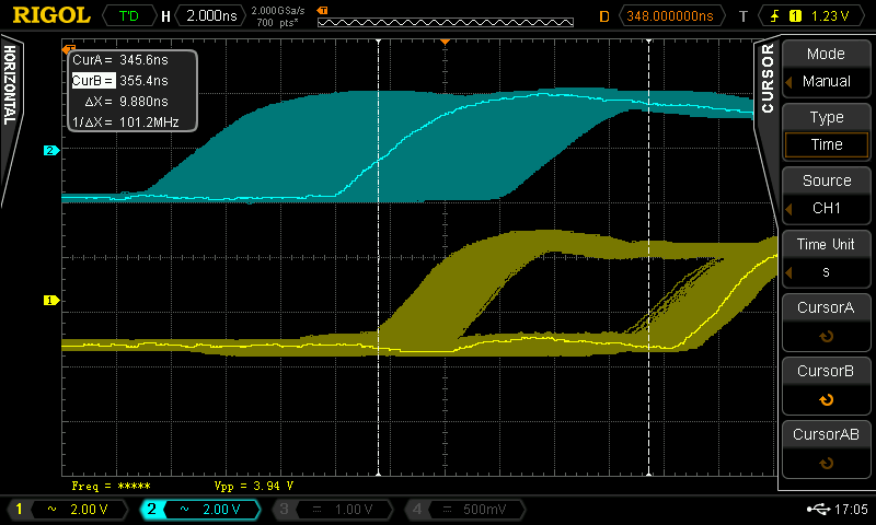

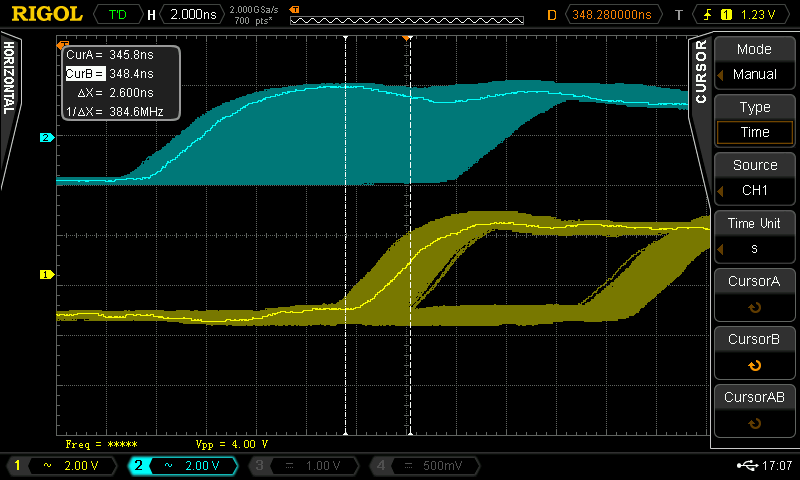

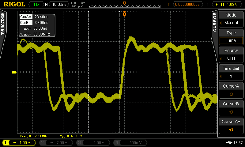

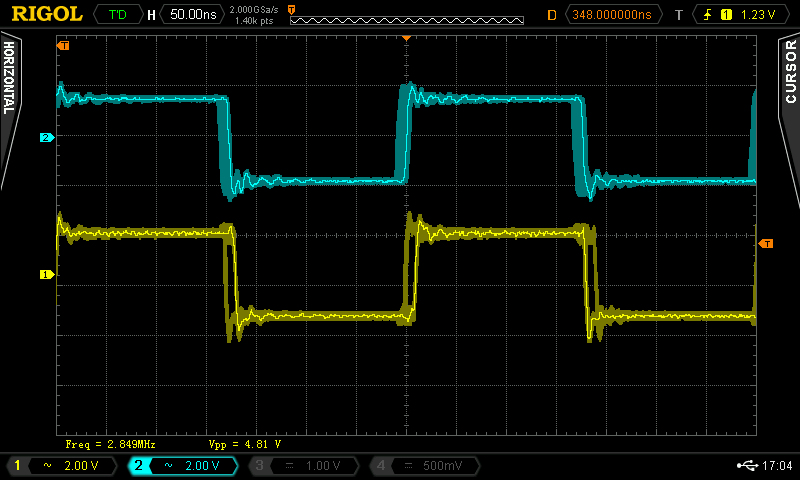

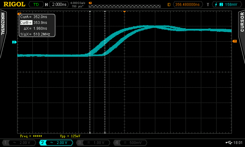

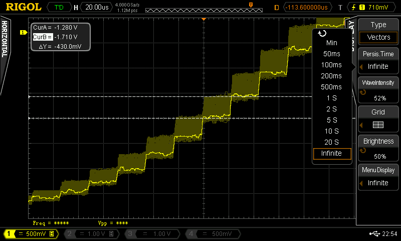

Some surprising measurements regarding Acko reclocker compared to isolator
I yesterday finished the Acko S03 reclocker, so my chain is "RPi -> Acko S03 Reclocker with Crystal of 100Mhz -> 4 Deck DDDAC". What I was interested in was if and how the jitter would improve, so I checked the I2S signals with my DSO and would like to share my findings / thoughts:
- Looking at the BCK signal first, one can see in the picture below that its edges are alternating to some degree (yellow signal is after the reclocker, blue is before, trigger is set to yellow signal).
- A closeup shows that the jitter is quite exactly 10ns, which means that the signal shifts via the FF for one cycle of the 100Mhz signal from time to time.
- Interestingly, another cursor measurement shows that besides to the 10ns alternating rising edge, the output signal has a jitter of approx. 2.6ns.
- The 192khz signal looks very jittered as well as can be seen here:
Next I checked the I2S signal right at the Raspberry Pi and found that the edges also alternate to some degree, however, the jitter is only at approx. 2ns - maybe this is due to the clock generation of the I2S signal via the 500Mhz clock?
What I wonder is the following:
- Am I doing something wrong? Maybe the implementation of the Acko reclocker is somehow flawed? Or I have an error in my measurement setup?
- Or: Is this the intended behaviour of the Acko reclocker? But - if yes, would the reclocker not add jitter instead of remove it?
Best Regards,
Hermann
Best Regards,
Hermann
