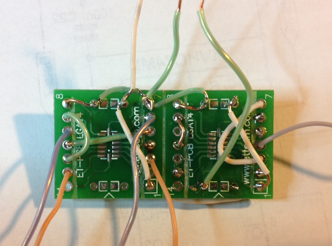

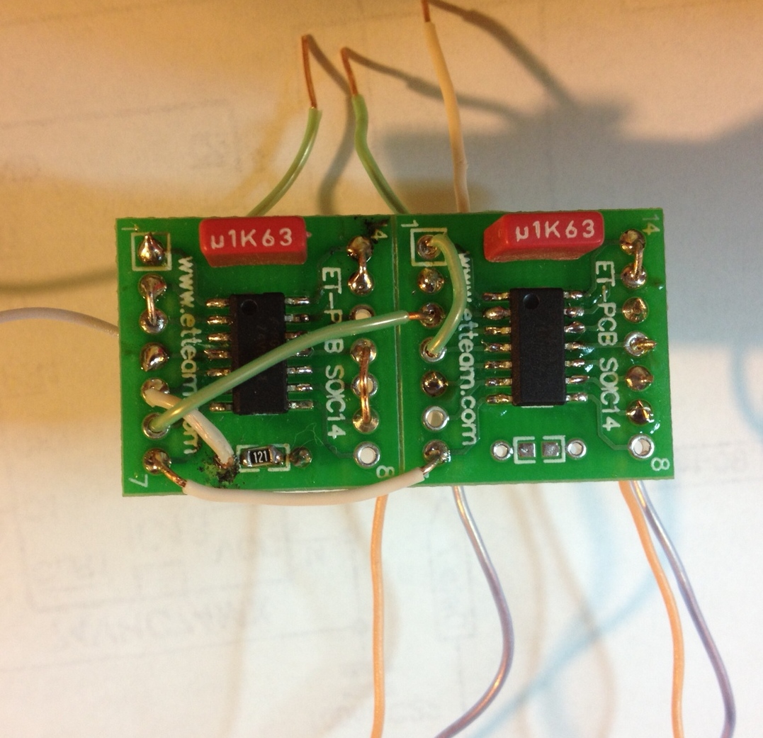

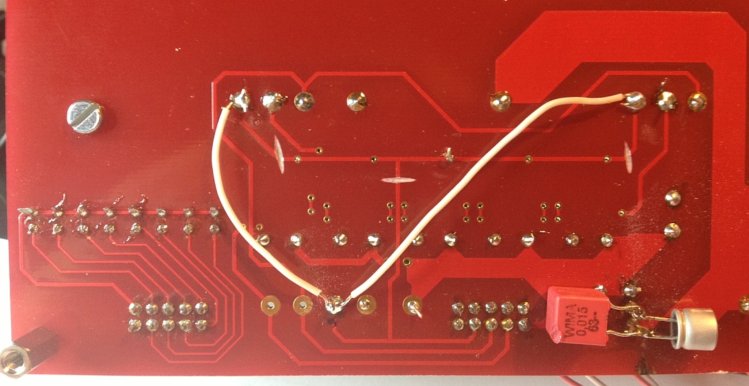

2-Chip 1/2 Clock Delay - Recommended!
It works! See pictures below. Took about 4 hours total to build and install.
I hear MORE music!
- Cymbals sound 100% right for the first time.
- Voices are more articulate
- Sound is more crisp and vibrant. This makes sense if any mishandling of bits results in the blunting of music. Some of this may be new parts sound. No smoothing here.
- Same amount of detail, but it sounds more coherent and "right"
- I got drawn into musical nuances of familiar CDs that I never noticed before.
- More focused placement of instruments in the soundstage. You can almost hear the size and shape of instruments.
The board is about $6 usd of parts, but I had to buy a 5V Belleson SPM78 regulator ($36). The 100 and 1000 ohm I2S resistors were replaced with jumpers. The bottom of the main board had to be modified by cutting BCK foil traces and adding jumpers. You can see the delayed signal wire from the 2-Chip Board coming through one of the clock foil trace holes to the five 74VHC164 chips.
It is possible to design a "tweak" board the size of the DAC board that would stack on top of it. The board could include a buffer circuit, 2-chip 1/2 clock delay circuit and several CCS mini-boards that could be used in place for one DAC or cut out for experimentation or use on multiple DACs. Any interest?
