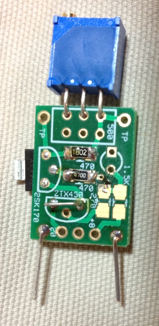

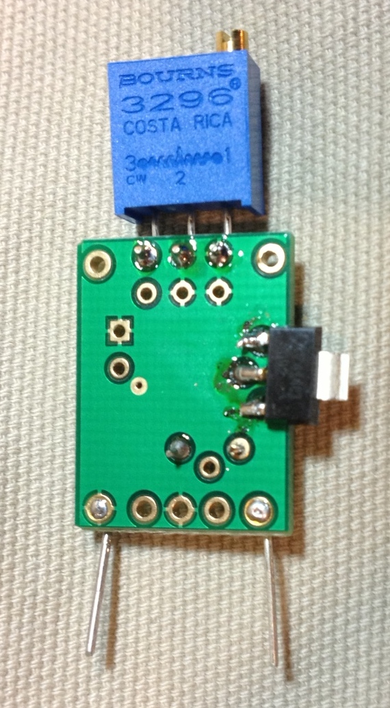

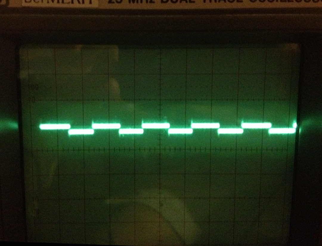

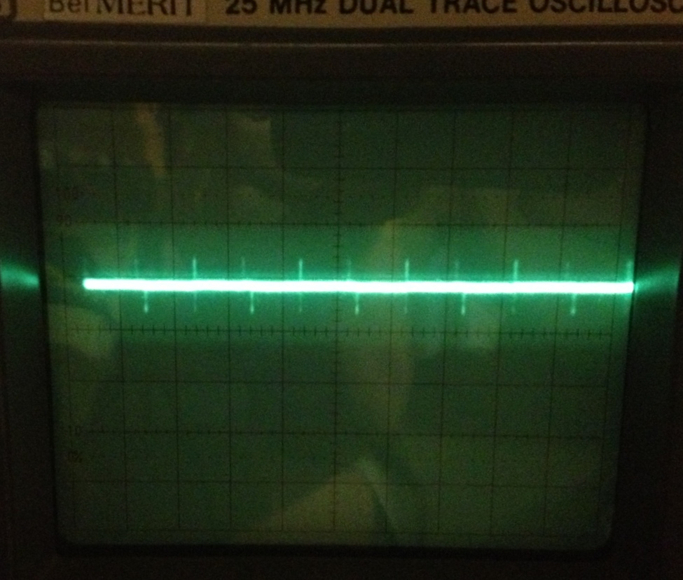

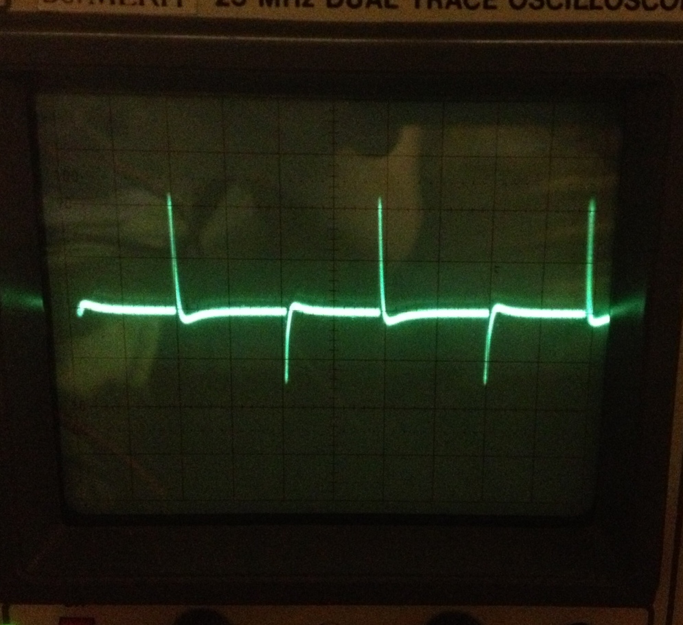

More CCS Tests
LT3092, 2SK246, and mini-CCS boards came in today.
All tests performed with 10 KHz square wave at 0.1V RMS injected on top of the 2.45vdc "pin 20" simulated signal on my breadboard. All CCS circuits adjusted to 0.406ma. Scope display is 5mv/div.
The baseline scope picture is the simple 2SK170 CCS. This is my favorite sounding so far.
Next is the 2SK246 at 2.45V. Unfortunately Vgs had to be adjusted up to 1.85V in order to provide 0.406ma so the JFET has only 0.65V to regulate with. The datasheet shows 1.2V at O.4ma so I raised the "pin 20" voltage to 3.1 to give the 2SK246 1.2V to regulate with. This resulted in the best looking scope display yet. Heating up the 2SK246 with a rework heat gun only caused the current to drop only about 2%. If we can find some 2SK246 with a 1.2Vgs at 0.4ma this may be the best CCS yet. Maybe Erno can tell us where he got his.
I used the mini-board to build a LT3092 CCS. A heat gun did not cause the LT3092 to vary in current at all. Now the bad news - the scope display shows huge overshooting - even uglier looking than for the LM334. If there is interest I will build a second one and give it a listen. Anyone want to buy any LM334 or LT3092 parts?
The CCS board was designed for a cascoded JFET and simple JFET but was able to accommodate the LT3092. The board can be installed many different ways with tall components installed on either side to fit into restricted spaces.
The 4th, 5th, and 6th pictures below are the ones referred to at the start of this post as the 1st, 2nd, and 3rd. You can figure out which one is the ugly one.
That does look promising
Thanks for pushing ahead with the testing
