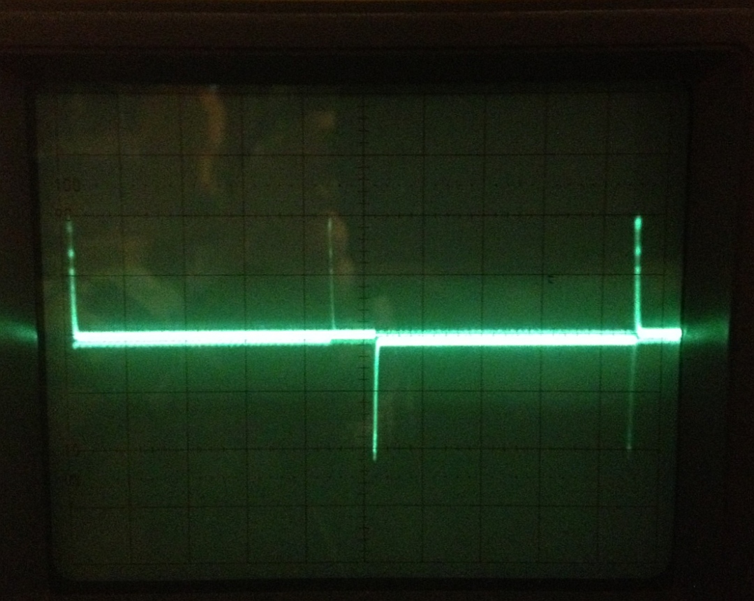

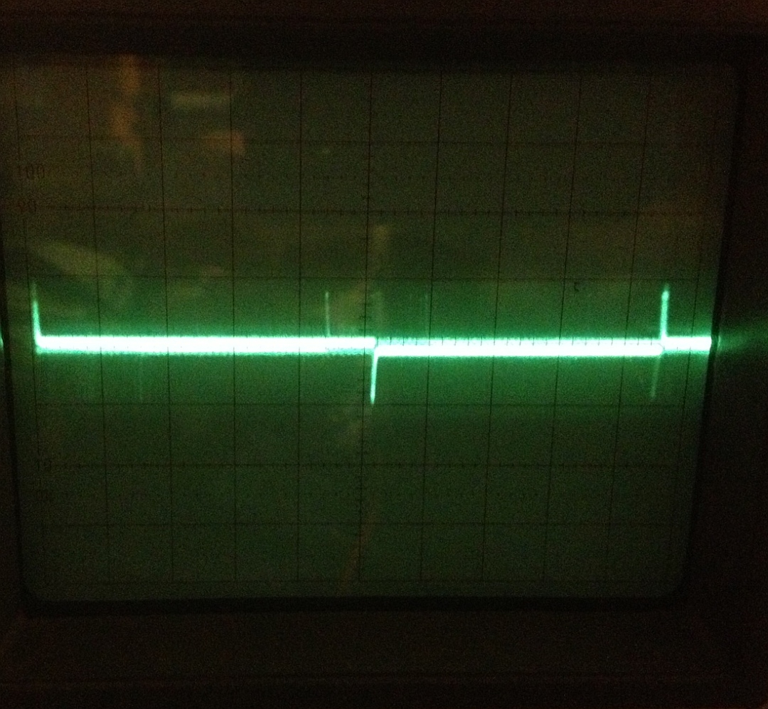

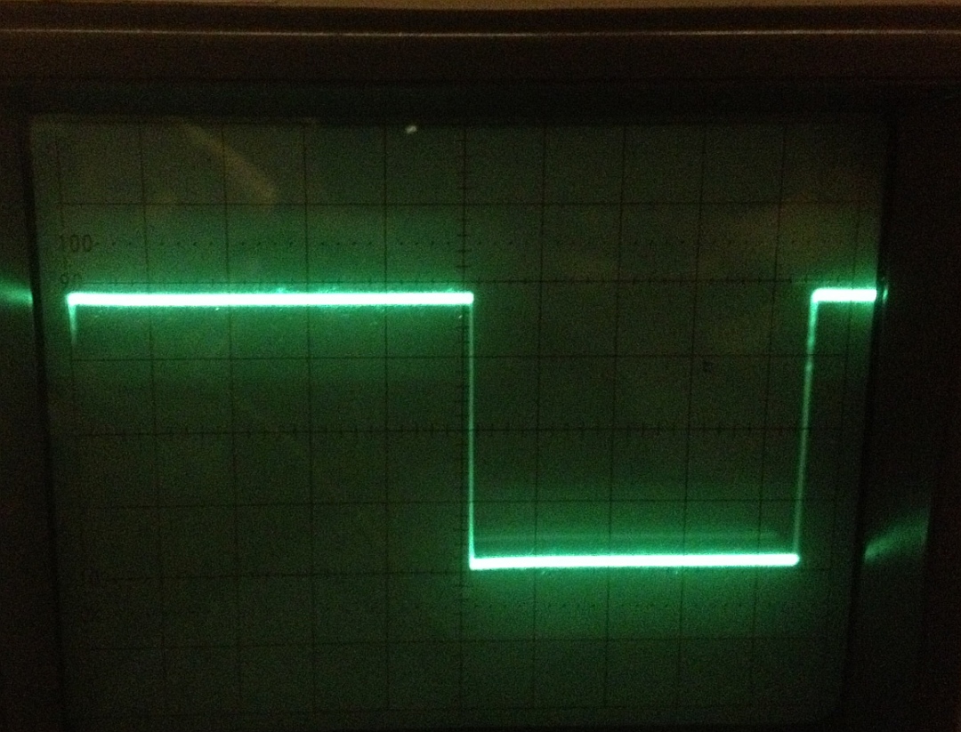

I put some 2SK246Y JFETS through my injected 10KHz 0.1V square wave signal tests on a scope.
The big square wave scope display is from the top (drain) of the JFET at 50mv/div. The JFETS were set up to have a voltage drop of 2.46V from Vd to the low potential end of the source resistor where it joined the jumper to the JFET gate. The signal then went through a 1000 ohm resistor to ground across which I could measure the ma and adjust the source resistance pot to measure .406V (.406ma). The Scope leads were placed across the 1000 ohm resister to measure the current regulating ability and transient response of each JFET.
The next Scope pic is for a 2SK246Y (2.43ma Idss) set at 5mv/div. Current regulation is near perfect with the smallest transient response spikes I have ever seen from a JFET. Several 2SK246Y JFETS ranging from an Idss of 1.79ma to 2.70ma were tested. The Scope displays were identical. Of course the source resistance had to be changed to achieve the same 0.406ma.
The right most Scope pic is for a 2SK170bl (7.47 Idss). This shows much larger spikes in response to the square wave.
Now to build some CCS boards with the 2SK246Y and begin the burnin process. I would be shocked if they didn't sound at least as good as the 2SK170. As I mentioned before, the 2SK246Y is very temperature stable in the 25-40C range. This appears to be the Holy Grail of JFETs for the DDDAC!
The scope pics are dark because I had to turn off all the CFL lights at my work bench because they added noise to the display.
