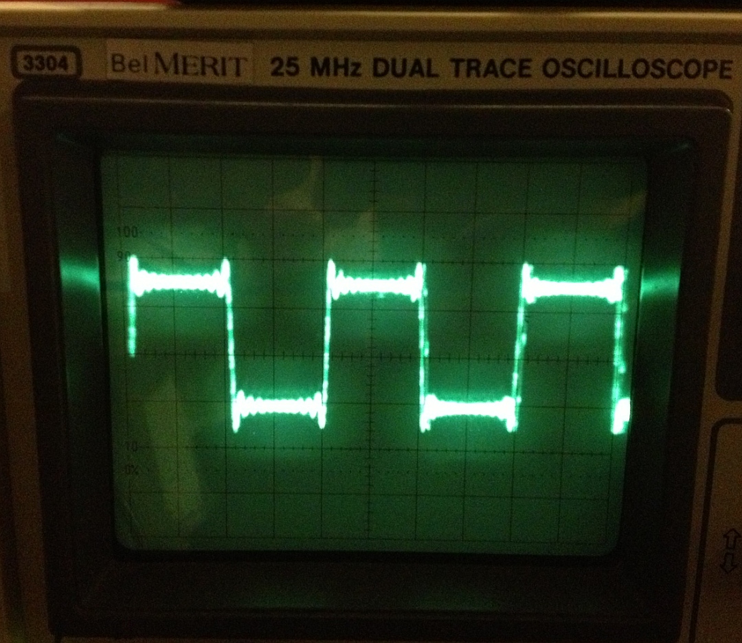

Scope Pin 20
I put a scope on pin 20 feeding a cascoded CCS and also a 6.04K resistor.
The scope pictures didn't show much because the signals smeared together, but this is what I saw.
1. Scope displays showed a variation of what looked like a blend of periodic and random sine waves varying by no more than +/- 5mv. Nothing that resembled square waves, but the sine waves sometimes appeared distorted.
2. The clearest sine waves were displayed at 0.5usec time/div. These could be clock signals or digital noise from the DAC. There were also smeared sine waves at 10usec time/div.
3. Interestingly, the signals for the CCS were about twice as large as the ones for the 6K resistor. I guess this makes sense because a CCS allows the voltage to float without any change in current.
4. The signals were slightly more messy looking with a 1 KHz square wave being fed into the DAC versus no signal being fed.
There is something going on at pin 20 besides a steady 2.4VDC, but the variations are small and at high frequencies. This doesn't tell me what to do but to continue to do listening tests.
Just for fun I scoped the RCA output for the 1 KHz signal. This proves that I was actually putting a signal through the DAC. Maybe someone else can get more definitive scope displays from pin 20.
