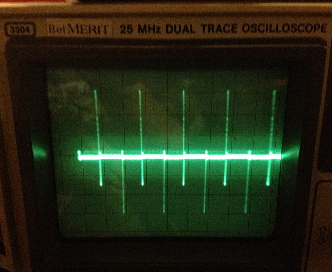

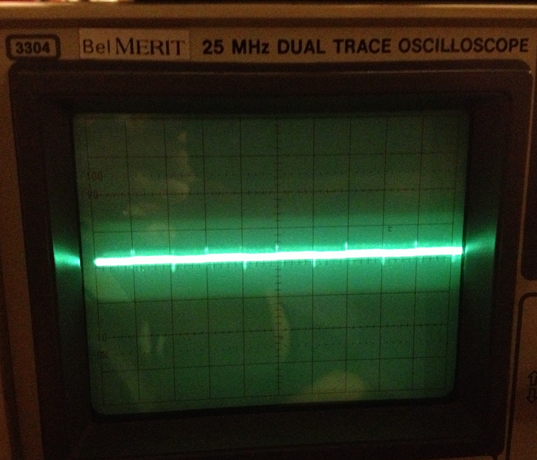

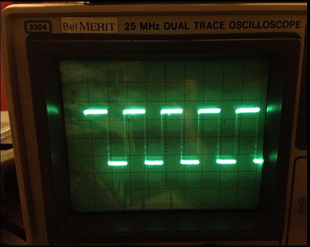

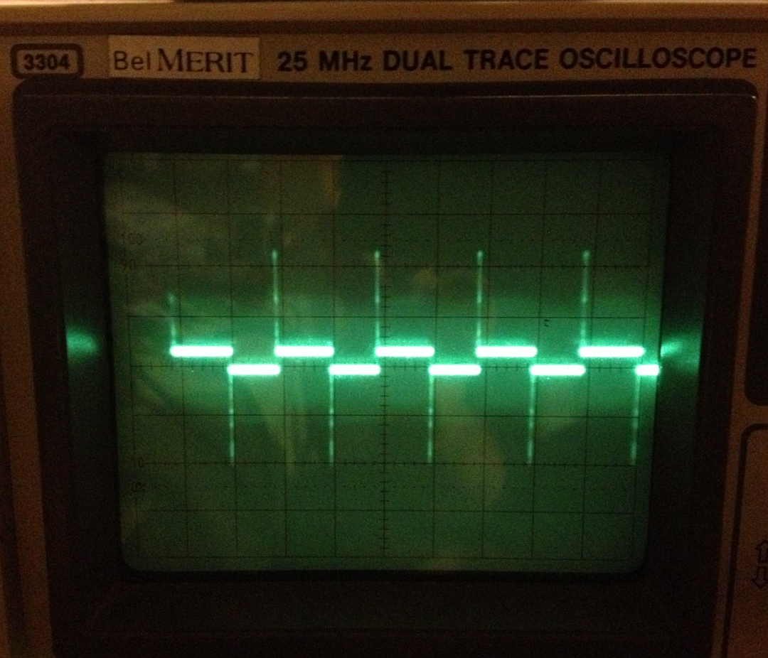

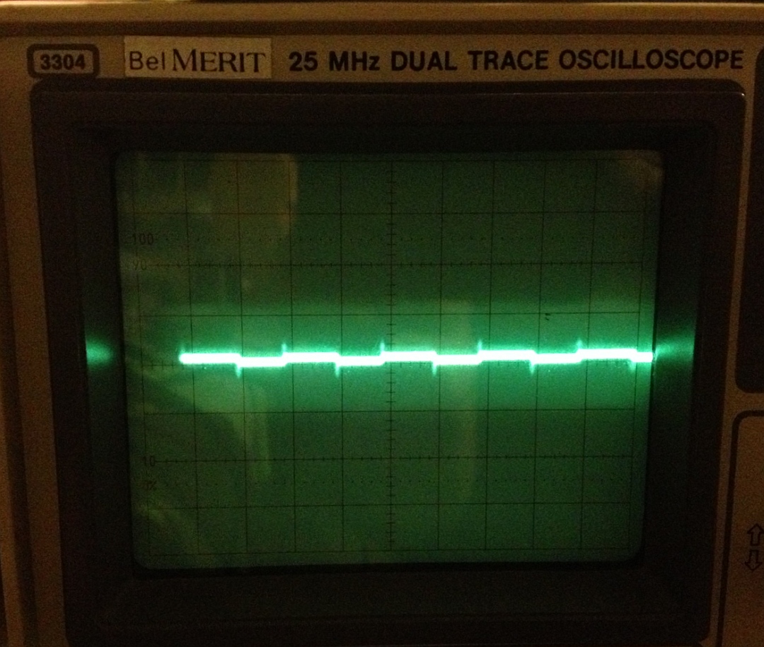

I ran 5 different CCS circuits on a breadboard with all devices set for .406ma and a signal source of 2.46V which duplicates the DDDAC with a 6.04K resistor. A 0.5v 10khz square wave was imposed on the 2.46V source signal. The scope input was from a 100 ohm resistor between the CCS device and ground or as the bottom 100 ohms of the resistance of the CCS circuit to ground. From left to right the Scope displays are:
1. 6.04K resistor
2. JFET
3. Cascoded JFET
4. LM334 with tempco
5. JFET with 22uf cap across the source resistor
The only device without any overshoot spike is the 6.04k resistor, but we all know that it provides the least favorable sq. It also has the most variation in current.
The device with the most severe overshoot spiking is the LM334, but it also provides the most constant current. This same device with a 10K sine wave displays a perfectly flat line. I don't know what kind of signal is present at pin 20, but if the signal changes are well within the transient response time of the LM334 then this CCS may sound great.
I used a TO-92 plastic LM334. I measured 0.596V across the 1N457 diode. I had to adjust the R1 resistance to 340 ohms and R2 to 3.4K to get the current I needed. 330 ohms gave me 4.16ma which may be ok too.
The least amount of spiking in an active device is the cascoded JFET which I am listening to right now with about 300 hours of play time. Very neutral, detailed, and authoritative compared to the 6K resistor. Current variation is almost flat on the scope.
The single JFET CCS shows a little more spiking and the current varies a little with input signal. I want to test this CCS some more because in my limited testing with a prototype board there was an extra excitement and 3 dimensional presentation of the music. I need to know what it sounds like after a 300 hour burnin.
Adding a source resistor bypass cap to the JFET adds a component with worse scope displays compared with the JFET. I'm dropping this from further consideration.
I need to learn how dwjames drops pictures into the middle of the test.
The scope was set for 5mv/division. The hazy band across the display is there with inputs shorted. I had to increase the intensity to make the spikes more visible.

Top work Sir!
That certainly shows up the lm334 as not ideal in that test, but as you say, how does that translate in terms of sound?
Have you been able to scope the pin20 output with music playing to get an idea of what the typical real world voltage variation is?
