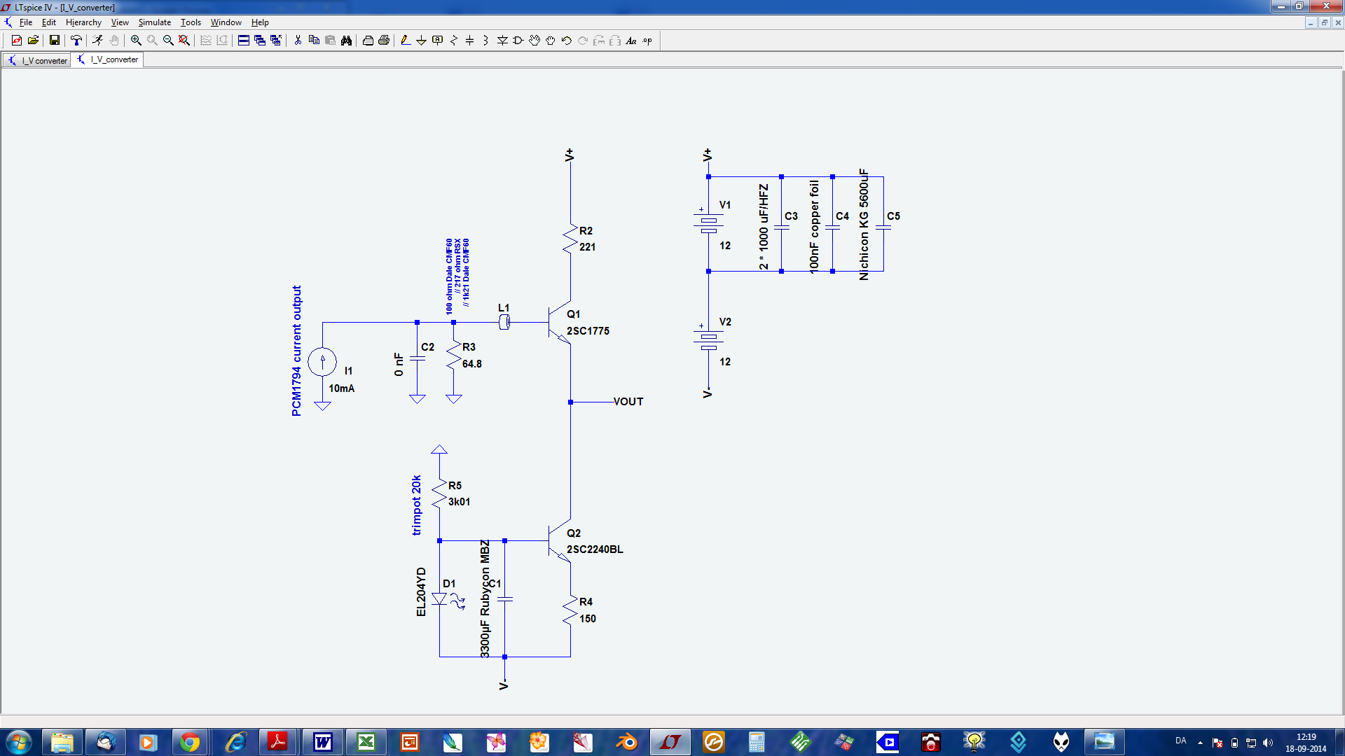

A DDDAC with DC coupled semi-passive output stage.
Hi All,

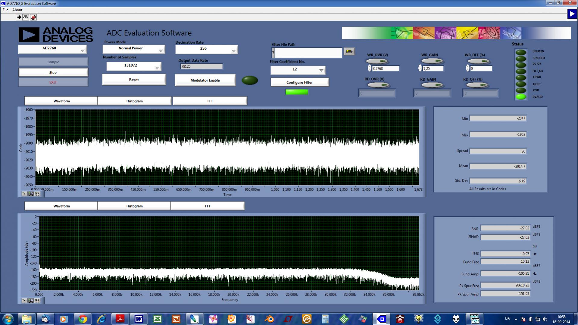

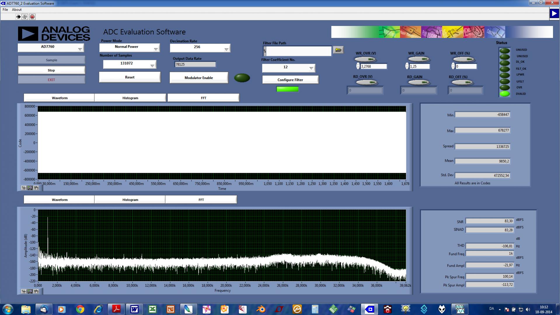

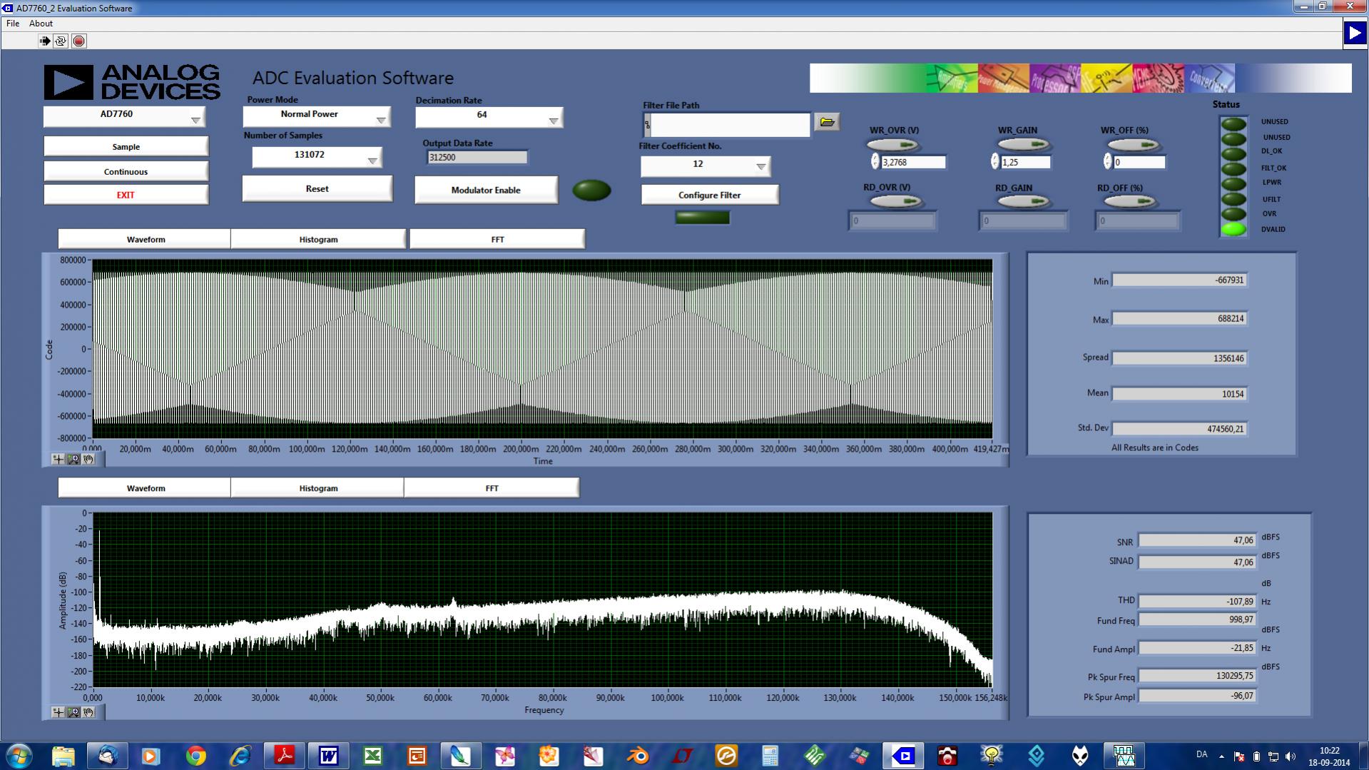

I've now mostly completed my DDDAC inspired D/A converter, however, I've used a different and capacitor-less output stage that I'm thinking might be interesting to someone here - the schematic is shown in one of the attachments to this post.
Since it's a rather straightforward circuitry I suppose someone else could have suggested this - I just haven't seen it which is why I now post it.
The circuitry basically is a passive I/V resistor which combined with the Vbe of a 2SC1775 transistor and the 6 kohm Doede has suggested for the Iref resistor makes for a DC offset of 0V +/- a couple of mVs. The DC offset is quite stable when the circuitry has warmed up and stabilized. In practice it is less than 10 mVs after a few minutes of warm up.
The output is somewhat lowish, app. 0.3 Vpp, however to my ears the sound is superb and all the harmonics at a 1kHz sine wave output are <= - 110 dBs relative to a 0 dB output level (shown in attachment; due to the 0.3 Vpp output level 0 dB data level output corresponds to -20.2 dBs with the ADC; for reference the noise level of the ADC with inputs shorted is also shown; measurements were made in the open with the DAC mounted on a wooden board - no shielding except of the ADC itself).
One caveat with this design is that the I/V resistor and the used transistors' Vbe needs be carefully adjusted to each other to obtain 0 VDC on the output. Yet by pairing the transistors and parallelling a couple of resistors this now works fine. After listening to a range of resistors (Shinkoh tantalum, Holco H4, Caddock TF, Vishay S102, PRP, Dale CMF, Welwyn RC-65, Xicon, RSX - see below, Takman REX & REY, carbon composition) I ended up using Dale's CMF60 resistor series, which is an ROHS compliant part, in parallel with an RSX resistor (I have a vague recollection that Doede uses the RN60 or RN65?). The RSX resistor comes from the hearing aid industry - very small, no more available yet very extended at the upper frequencies. Some of the other resistors - to my ears - were also fine but just different. The CMF60 + RSX resistor were just the most homogenous & without obvious flaws in this context.
I also tried various transistors (2SC2240, 2SC1775, 2SC3114, 2SD786, 2SC1845, 2SC2362, 2SD756, 2N3906) but ended up with the 2SC1775 run at a quite high quiescent current of 8 mA ... This actually happened by coincidence. I just happened to place the 2SC1775 in my circuitry with the CCS at a high current, yet found that (again to my ears) it sounded most open, very dynamic and upwards extended.
Since the 2SC1775 is a 50 mA max Ic transistor I normally wouldn't expect this to be so but looking at the transistor's datasheet both the Ft and Hfe are actually highest and most linear just around 8 mAs. Maybe this is part of the explanation ....? Measuring the distortions generated with some of the various transistors placed in the circuitry the 2SC1775 actually also had the lowest distortion figures closely followed by the 2SC2240 (I used wavegene to generate output wave forms).
I've also experimented with connecting a capacitor from the PCM1794's output (an optional capacitor in Doede's DDDAC paper) to ground. Values have been 4.7 nF, 10 nF, 22 nF, 100 nF (wima FKP2 4.7 nF, 10 nF, 22 nF; Russian Silver Mica 10 nF; Panasonic copper foil 100 nF). And although I do notice various degrees of "upwards calmness" with the different capacitors somehow it sounds to me as if the sound also becomes less dynamic and free/open - so for now I don't use any. Might eventually do so, though, but would then see if I can find a 2.2 - 3.3 nF panasonic copper foil polypropylene capacitor ...
And so - how about the sound? Well - to my ears - the most extended, nuanced, tonally integrated, speedy, spatially exceptionally transparent, layering, and altogether quick/"being there" DAC I've heard. Very, very musical yet also revealing of the recordings used. Just a very slight tad on the tonally light side - something I chose more or less deliberately by using Nichicon's KG capacitors in the PSU for the DAC's VDD and VCC and the 2SC1775 (the 2SC2240 in this circuitry sounds more "solid" if I can say it so).
A P.S.: The ferrite bead in the schematic is mounted directly on the transistor leg. It's one of those 5 mm long, 1.5 mm inner diameter cylinder beads that a wire can go through. In my experience using the bead sort of "assembles" the sound without any obvious side-effects.
Jesper
