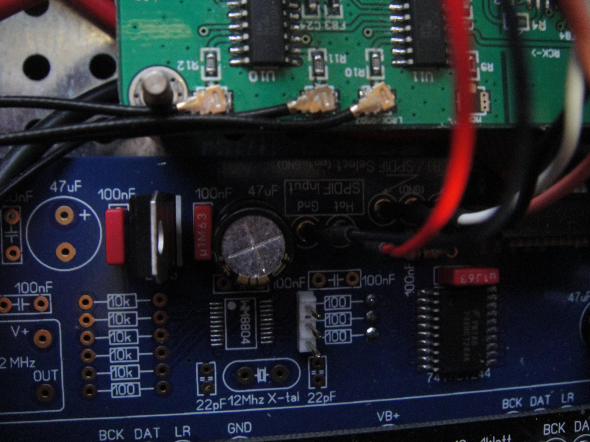

It's $35 posted for the board, then the digikey order was something like $75 and a maybe $10 from Potato Semiconductors too.
I still need to work out the best way to get from the U.FL connectors onto the DDDAC mainboard, so I guess a few $ more still to come

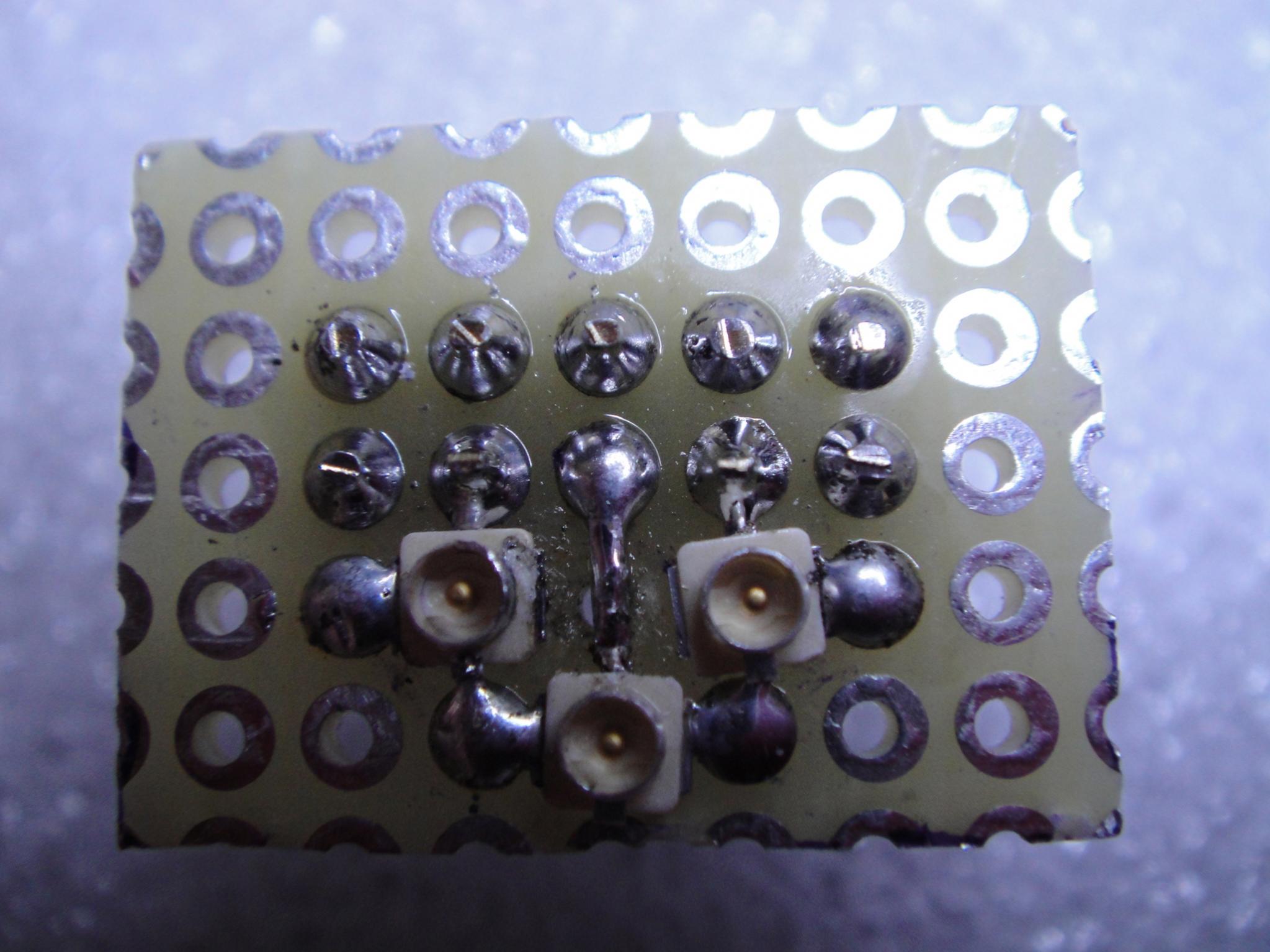

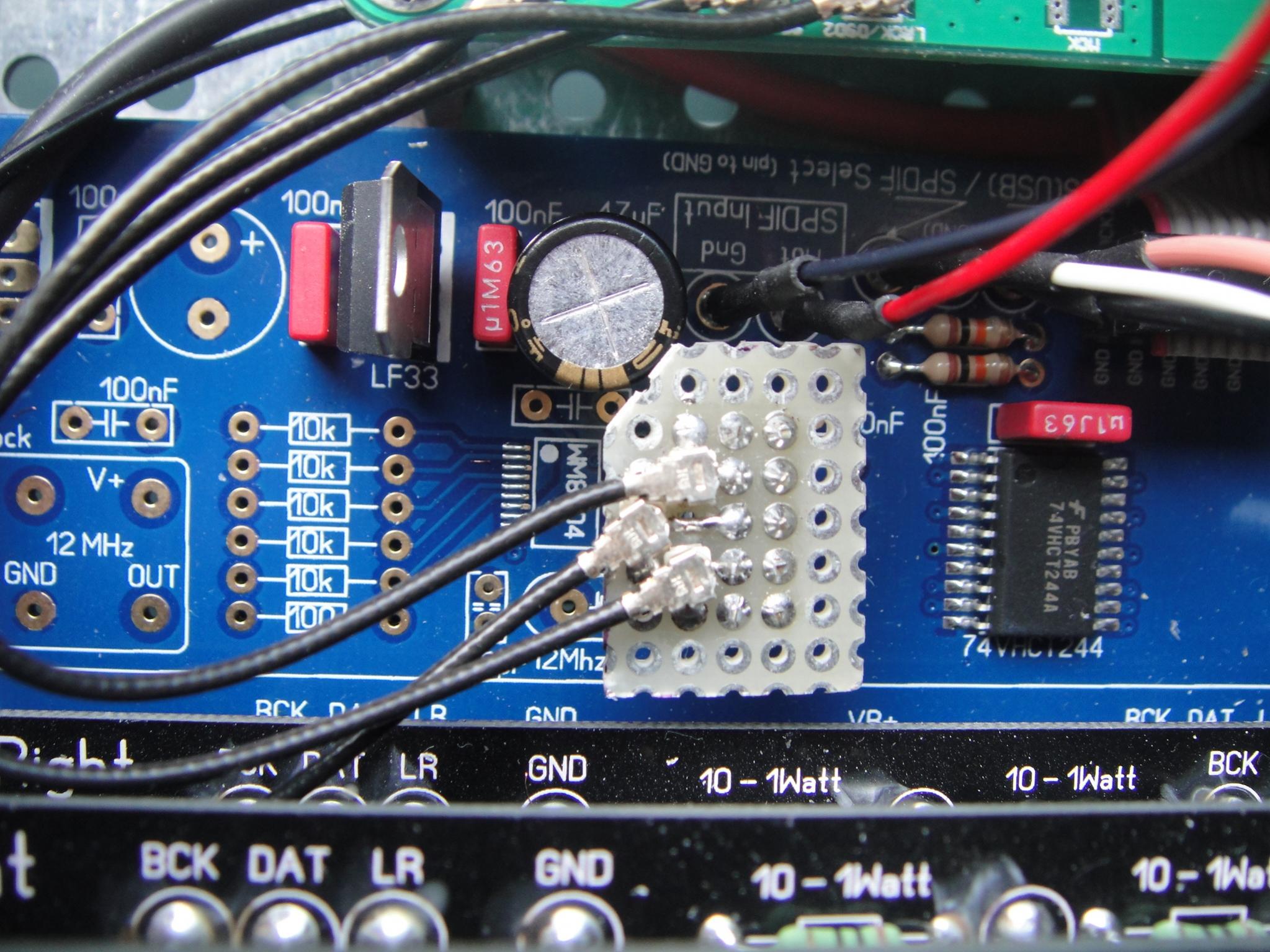

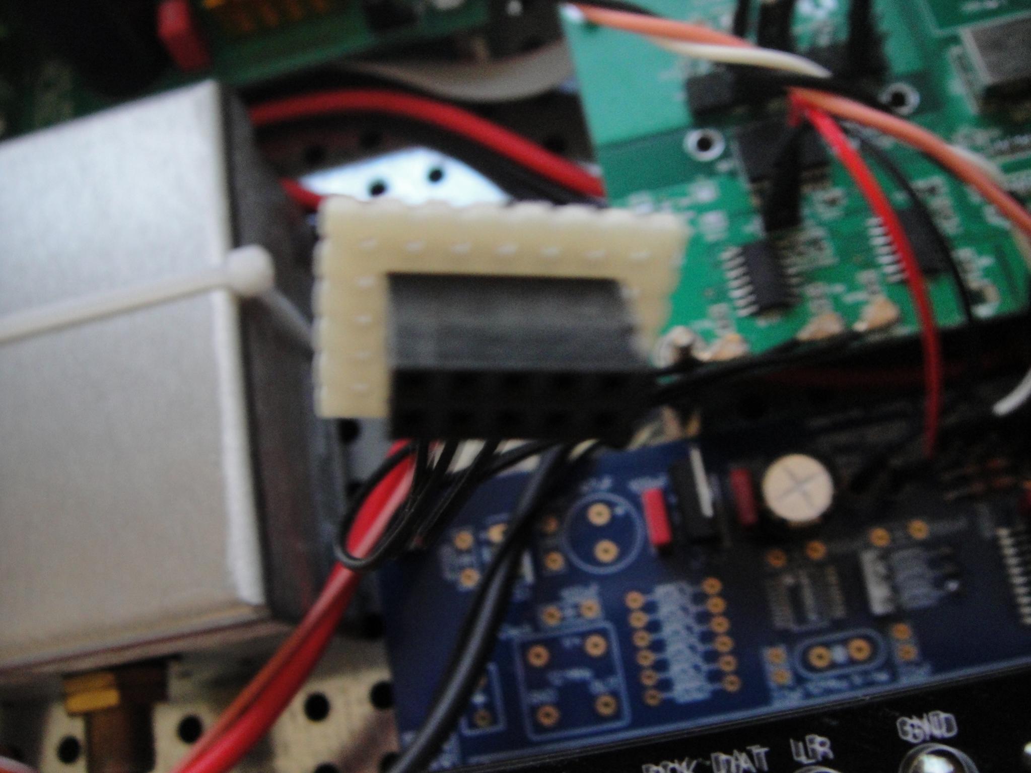

Hi James,
I just read your post and I don't know if you have been solved the U.FL cable connection to the DAC.
Anyway, I solve the problem with a small (very DIYer) pcb, 3 U.FL connectors and Molex female connector.
The molex connector can be used for both the DAC motherboards.
If you use the old type the connector will go straight in the input connector.
I have the new board and I use both the RPI+S03 and the Waveio.
I leave the input connector for the Waveio. For the S03 connection I made a small modification: I remove the IC WM8804 (is part of the S-PDIF input that I don't use), I solded the 3 100ohm resistor on the back side of the board and I use the 3 holes for a small molex connector.
Attached are some pictures about... I hope this can help you
Enrico
Thanks Enrico, that's very helpful.Hi James,

I hadn't solved this little issue yet as I haven't found the time for the tiny SMD soldering on the S03.
This looks like a nice method, I'll give it a go.
cheers,
James
