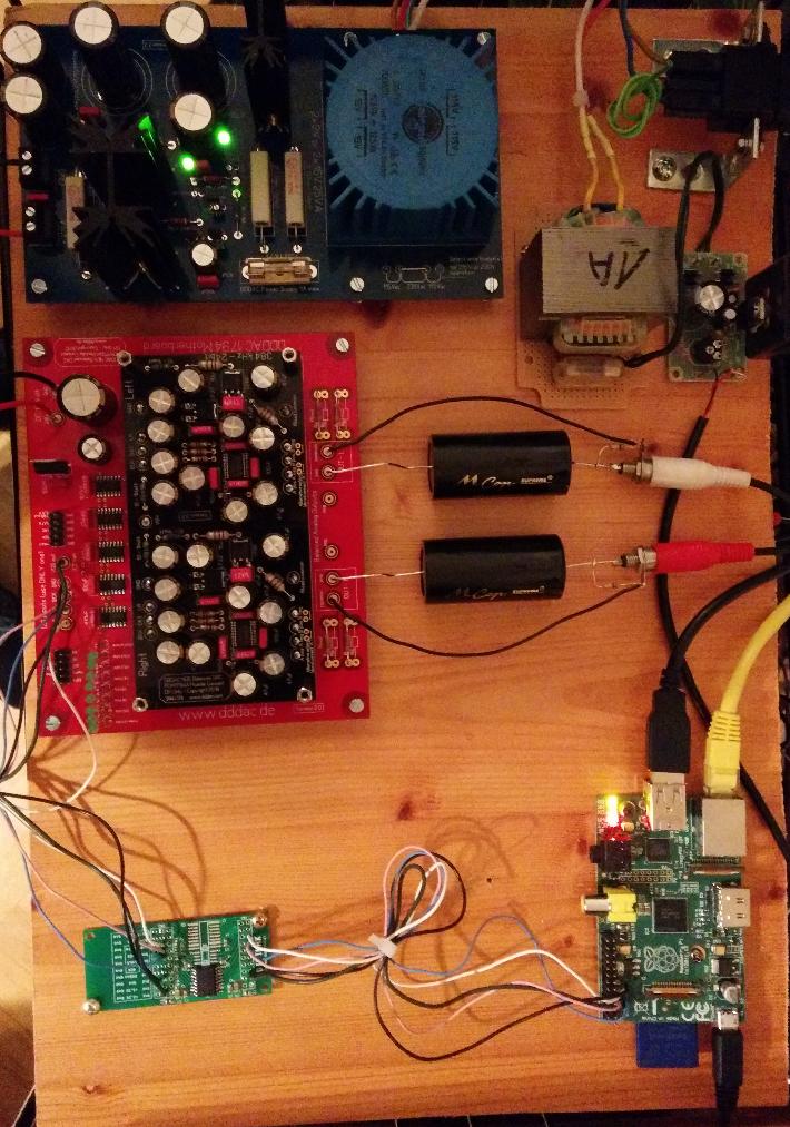

DDDAC finished - A short report
I just wanted to let you know that we (a group of friends in Austria/Vienna) just successfully finished our little DDDAC-Project. The setup is as follows:
- DDDAC Mainboard (red version)
- One DDDAC PCB
- DDDAC 12V power supply
- Mundorf Gold capacitors
- Raspberry Pi Vers. B as input source with Volumio
- DIYINHK isolator (for isolation of the I2S signal between Raspberry and DDDAC)
- Simple / non-switiching power supply for Raspberry
All in all the construction was relatively simple. The parts ordered from audiocreative - Audio Creative Shop DDDAC 1794 - WEB Shop Archives - Audio Creative Shop - arrived quite fast, sales was helpful in selecting the right parts. Soldering was quite easy too.
We selected better Mundorf capacitors (not too expensive) for output to improve quality a bit. Moreover, I was recommended to put an isolator between the Raspberry and the DDDAC, whereas the very cheap DIYINHK isolator seemed like a suitable solution and was not too hard to assemble.
After everything was soldered, we put all parts together - however, there was one problem: Audio was playing, but there was some hissing noise. When moving the I2S cables the hissing changed and eventually vanished. At that stage we used a cheap wallplug switching power supply for the Raspberry and thus exchanged it with a cheap non-switching variant - now the hissing is gone.
-> So it was interesting that the noise of the switching power supply did interfere with the I2S signal that much that it led to errors in the signal and thus to this hissing noise - I did not expect that.
Currently the test setup is on a wooden board (see photo below), now it will be assembled into a case we purchased from ebay.
attachment.php
Today we did some first listening tests, and I can tell you, the result is awesome! The sound is very clear and crisp, locating the instruments etc. is great, it's like pulling a curtain away from the music.
We heard details in songs we never heard before, simply because the sound picture is so detailed that one can make out elements that were simply melted with other elements with the old DAC. It can be best described as "unblurring" a picture, similar when someone short-sighted puts his glasses on and can suddenly see a sharp picture and make out details he never knew they were there.
I have to add that the Hifi system we tested the DDDAC is nice but far from perfect, it consists of 20 years old Infinity speakers (approx. € 600 that time) and a common Denon amplifier. Nevertheless the difference was easy to make out and the DDDAC produced a sound not expected from this Hifi system.
So, all in all I want to thank everyone who contributed to this project, especially Doede, who came up with this design and also Enrico and others who gave me some helpful tips regarding the DDDAC and Raspberry!

Good work Hermann :)
Glad you are enjoying the creation and importantly, enjoying the music :)
I would suggest that you should try and keep your i2s wires as short as possible. Ideally less than 10cm.
Hi Hermann,
I am very glad to know that you can make the Rpi working... nice job indeed! :up: and I quote 100% the message from James... the hissing noise that you describe is surely due to the too long length of the connection between the Rpi, the isolator and the DDDAC. And, if you have the chance, give a better power supply to the Rpi... he deserves it.
Enrico

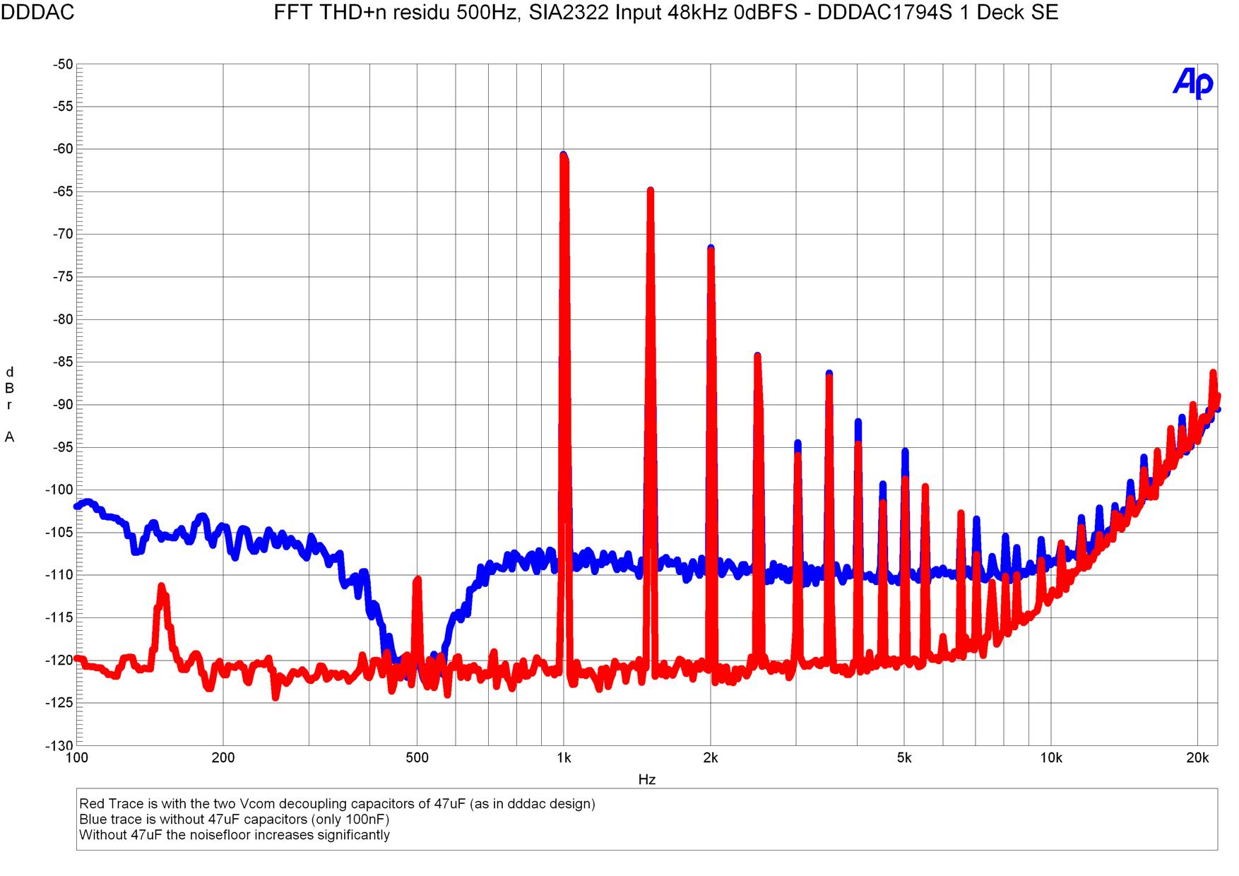

OK Guys, here is some answer ........ :cool:
Did some testing on my single deck "test-dac" by measuring linearity and THD with noise floor with and without the 47uF and, yes you need the capacitors !!
Just look at the two measurements, explains it...
Did not do listening tests (as it is a bit work to do this on a 8-deck)
Something tells me, this position could be significant for SQ... (better quality 47uF, parallel film cap or something)
After one night sleep this intrigues me. I want to be sure and would like to do some more checking... As said I build a one deck test dac with good open space (important to be tweaked capacitors 10mm above board and left a few out) so I can easily change with/without and swop between Tent Shunt and normal LDO situation. I built an exact "stock" copy to compare. I am less interested for this test case on final absolute sound, rather for comparison, so it will become clear where the real potential is for SQ tweaks. Now the Vcom capacitors can be part of that. Today is nice weather again, so I “have to” play golf first. :D
Before listening, I will do some more measurements on the Vcom topic…
