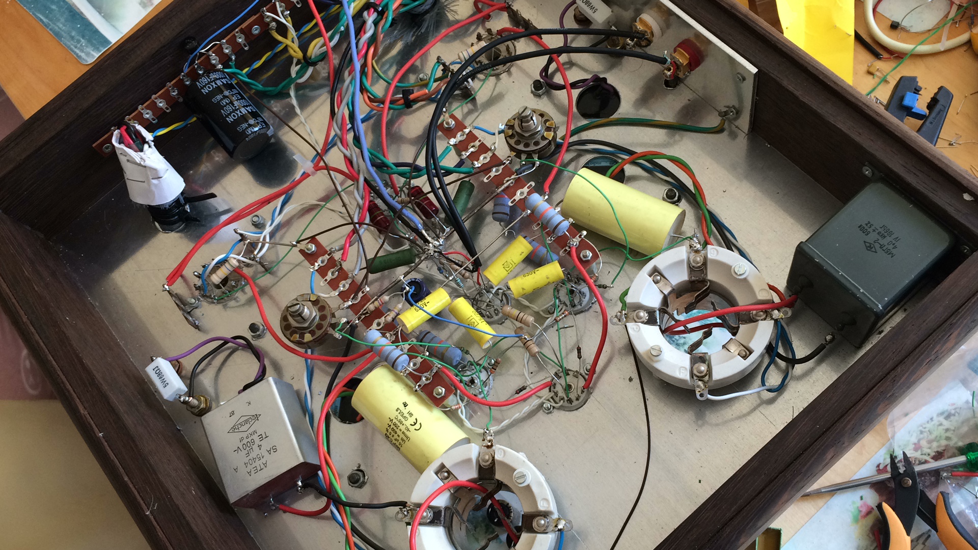

A Noob Valve Preamp Build?
Looks similar to the stuff i build usually when i want to try something new.

'I'll stick with proper circuits from now on.'
If the above means Eli's circuit is not proper then we assure you that it's a complete and proper/correct circuit.
We salute you for the effort you put into the build. Pls try again. Put PS circuit to one side of the box and signal circuit to another. Keep input and output wires away from power supply. Twist heater wires as much as possible and keep it close to the box surface. Keep the tubes away from PT and Chokes. Double check your volume pot wiring.....you will be successful at the end if you try hard and that will give you immence
pleasure.
Many diyers tried Eli's 12b4 circuit and it's a wonderful pre with proper gain for line drive. Wish you success in nearest future.
Regards
Please check the value of the 1.5M resistor with a DMM. You need to de-solder one end of the resistor for proper measurement. Very low value may eat-up gain. Also check the value of the input resistor i.e. tube grid to ground. Please remember tube pins/socket pins are read from downside. PLEASE TRY AGAIN, you will be successful this time.
Regards
Thanks for your encouragement minhaj. OK I'll do it again . We read the tube pins looking at the base so from underneath if it were in place , right? Number 1 is to the left of the gap , with the gap at the top, yes?
Those values of the 500ohm to the gate and the 1.5M are correct.
So I'll get a different breadboard and rebuild the circuit as you suggest.
Cheers.

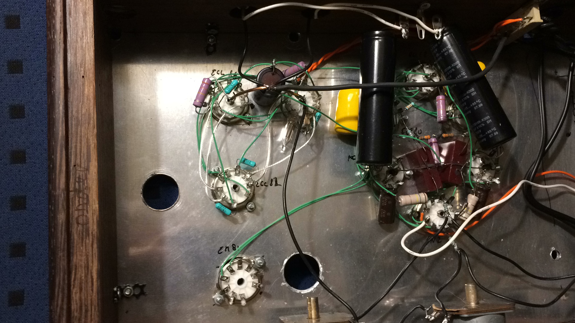

Rebuilt much neater. Took it all onboard. Made a separate signal board from the PS.
Still a fail. Plug amp into output and there's a slight hum. Plug input in from the computer and it screams. Not even remotely working.
I think I may have fried the IOM45's as when I first started I had a couple of shorts from the valve terminals which tripped the circuit breaker. This happened about 5 times till I finally tracked down the culprit. There doesn't seem to be any voltage from the IOM45 terminals going into the valve. I thought that should be measurable.
Any hints to check those things?
Request you to replace the Plate CCS with a 6k-8k 10W resistor and try. Plate voltage (from plate to ground) should be 90-100 volt and cathode voltage (from cathode to ground) should be 5-6 volt. Heater voltage across heater pins should be 6.3 volt. If these are ok but no sound the something wrong with input and/or output. Do you read voltage at PS out?

I don't understand what Plate CCS means sorry. Are you talking about the 1.5M resistor?
I have discovered the following voltages. Firstly across the heater terminals there is 13 volts, not 6.3V.
Plate -ground is 13.7
Cathode -ground is 8.2
PS after the IOM45 is 13.1.
I discovered this morning that the negative from the power supply was not connected so I was very hopeful that this major omission would be the answer but it was not to be.
The initial power at the zener diode has 120V AC and this becomes a bit over 400V DC at the beginning of the circuit. The IOM45 then regulates that down to 13.1 which is impressive. I have them mounted straight onto the heavy aluminium base of the cabinet but I wonder if they should have their own dedicated heatsinks?

At one point of time everybody was a basket case. No issue at all.
Let us start.
plate CCC is constant current source for the plate (10M45 not IOM45).
12B4A pin arrangement are as follows:
1 2 3 4 5 6 7 8 9
Cathode Grid Heater CT Heater Heater NC Grid NC Plate
I think your 10M45 is fried you replace that with 6k-8k 10 watt resistor. It will be in-between B+ and plate/pin no 9. 500 ohms resistor will be in-between cathode/pin no1 and ground. Solder each 2.2k resistor to grid/pin no 2 and 7. Solder a short wire in-between open ends of 2.2k resistors. Connect your input wire to 2.2k shorted end.
Heater wiring: If your heater winding/supply voltage is 6.3 volt
Solder a short wire in-between pin 4 and 5. Now connect you 6.3 volt supply to pin 3 and 4. You are done.
Output wiring: Solder your output film cap to plate/pin no 9- other end to output socket pin. 1.5M resistor should be connected in-between output pin and ground.
'Should all the grounds be common with the earth on the signal board which is the common earth for the power supply?' -there are more to it but for now it is 'YES".
'The initial power at the zener diode has 120V AC' -these are rectifier diodes.
IF YOU CAN LEARN HOW to OPERATE A COMPUTER THEN YOU CAN LEARN TO build a TUBE PRE NO QUESTION ASKED.
Regards

Minhaj,
Thanks again for your persistance with me. OK so I think I've worked out why it doesn't work. It's kind of embarrassing. I haven't got enough stuff earthed. I think it's going to be that simple. I don't think the 10M45's are fried because I get a straight 13 volts from their output .
However I do have a problem with the heater circuit because it is 13 volts for each side , not 6.3 volts as the specs and you suggest. I'm wondering if this will really matter in the scheme of things since these valves seem to be robust and have varying capacities for taking different volts. But I think it might add distortion and certainly seems to increase the other voltages that you mentioned.
So if you think it is essential to have 6.3 V on each heater I'll need another transformer , as I bought the one that Eli recommended. It's 24V Series and 12V parallel. That is unless there's an easy way to halve the output volts.
But tomorrow I plan to rush round with some decent earth wires everywhere and test it once again . The way it is it can't possibly work. I've looked at it all afternoon and was just waiting for your confirmation. I'll run them all onto the chassis.
