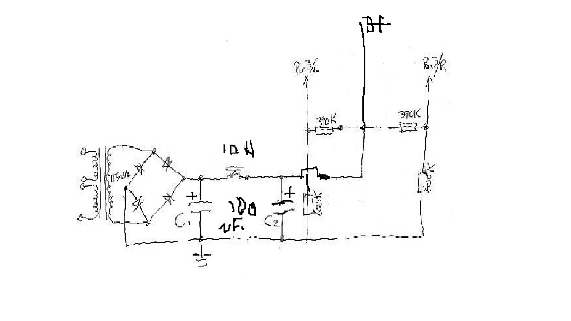

Alright so perhaps from what you say the power supply might look like this?
In which case C1 and C2 are 100uF 250V caps right?.
And though I understand a choke as a coil it must also have a value?
I would use a full bridge rectifier by preference to 4 separate diodes. Is that OK?

I said "simple". Here it is.
Just to be clear, the parts values in the voltage dividers are 390 K and 680 K.
I previously linked candidate filter caps. and a candidate choke.
It's well filtered and the 10M45S CCSes will provide quite adequate PSRR.

By the 10M45S I assume you speak of the choke of which you recommended the Triad C-7X. Is this the one and does it matter which way round it is wired?
Thanks so much for descending to this level for me Eli. I think I just about have it wrapped up.
Notice the 2 interlocked circles in the signal circuitry schematic. That's the symbol for constant current
The 10M45S is a TO220 case constant current device. Here it's used as a plate load. Refer to the previously linked datasheet and work out the resistors needed to set the device up for 20 mA.
There is no particular configuration for the C-7X choke.
