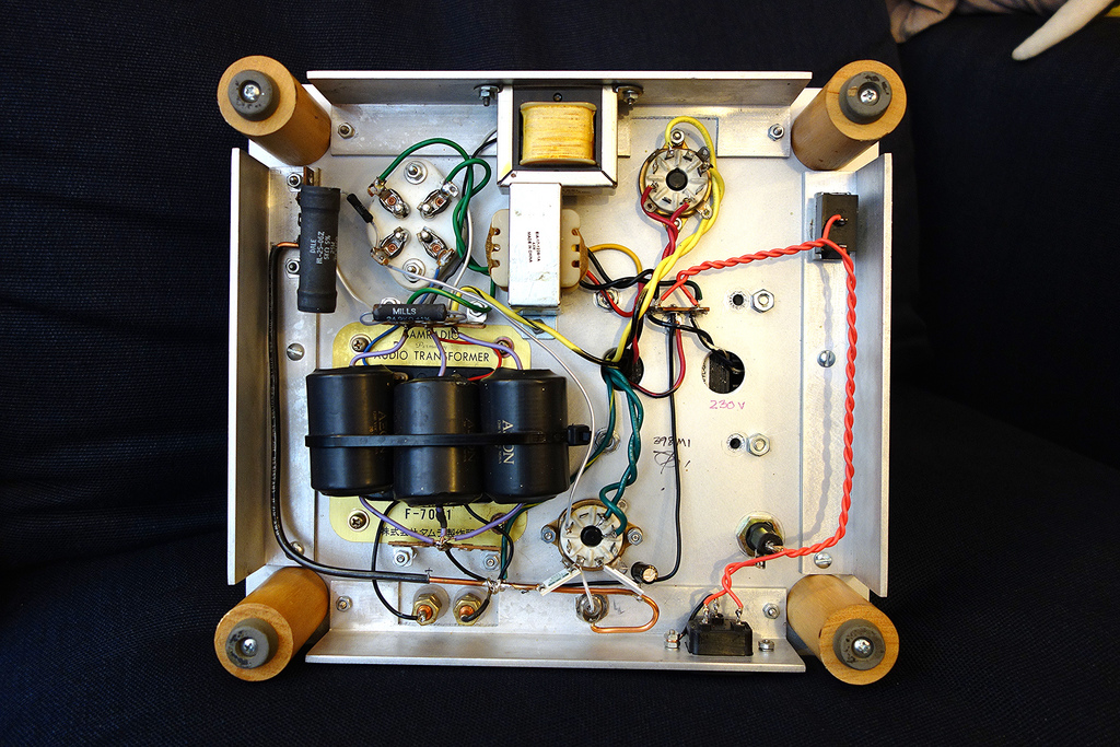

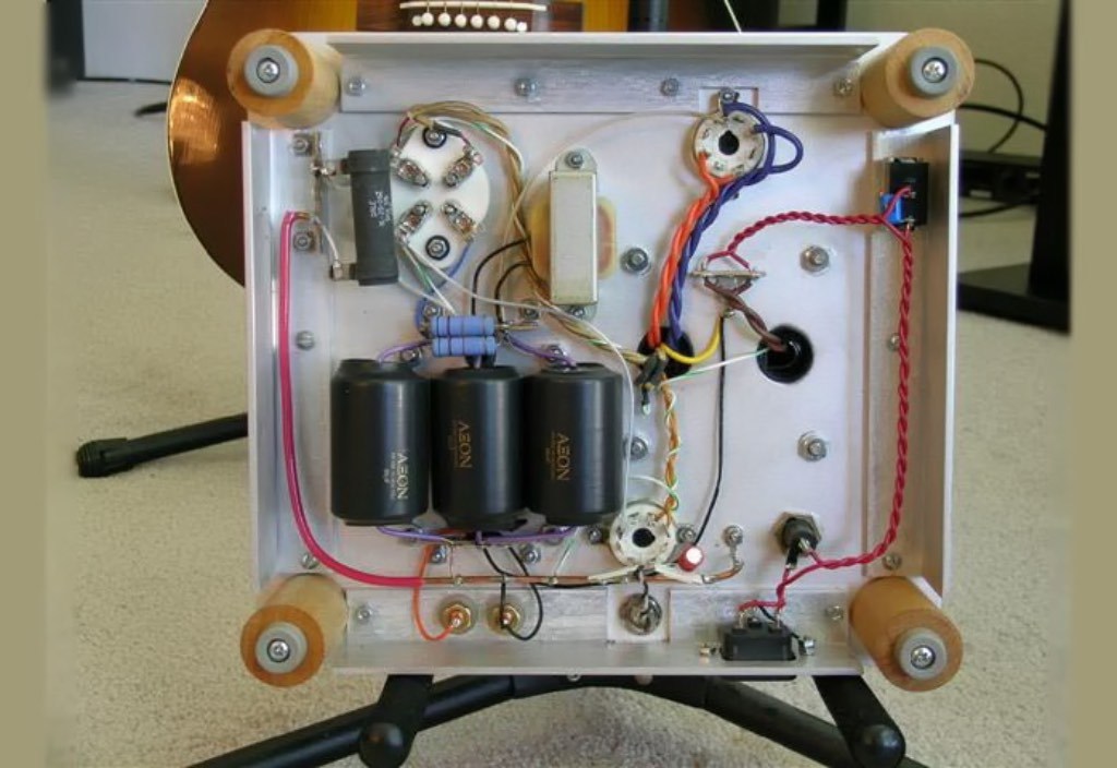

Experimental Chasis...

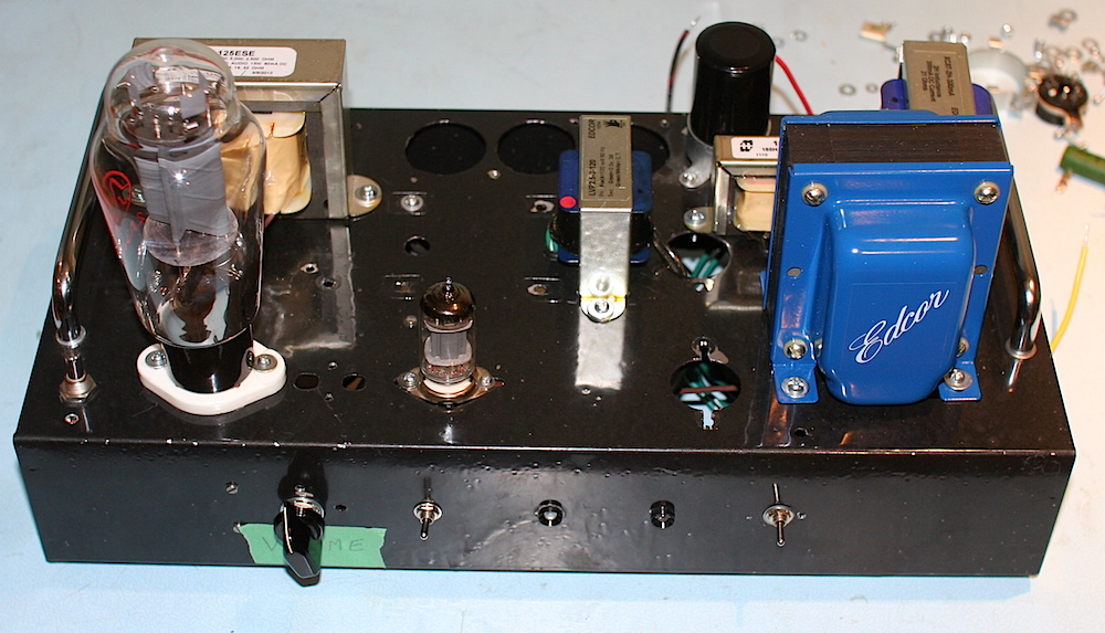

Then it's time to tinker. If I wait until I have all the bits and a clean chassis I'll be old and grey. Actually I am getting old and grey 😡
I've recycled the experimental chasis from my Spud amp project and drilled a few more holes, filled a few more shapes and as Sakuma-san would say 'mounted the iron'.
That's about it for now, next steps will include wiring up some bits and pieces, probably start with the power supply development. I'll find out soon enough if I'm missing any parts !

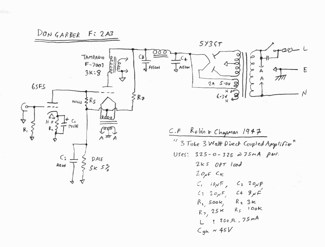

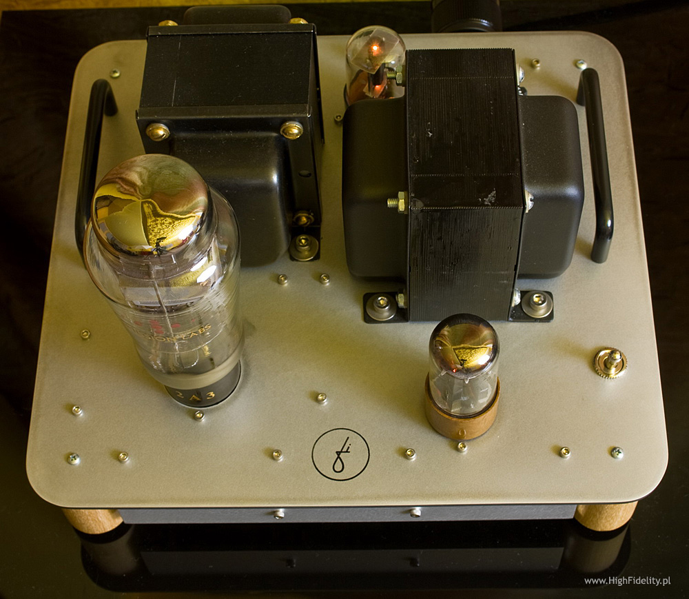

Don Garber Fi 2A3
Time to rekindle my interest in this project.
I read a little while back that Don Garber has passed on. He left a legacy of a very well regarded 2A3 mono-block amplifier. For me, it epitomizes the goal of this project, a nice little valve amplifier. I decided to take a peek at what he made. Attached are my findings. You will see that the topology is essentially that of the Robin & Chapman circuit published in a book in 1947 called 'Practical Amplifier Diagrams' and has 45 circuits inside. It sold for $2, or about $6 in todays money. The circuit of interest appears on page 6 as a "3 Tube 3 Watt Direct Coupled Amplifier". No doubt Shishido and Asano took inspiration from this design too.
Clearly, in the case of the Fi, the driver tube is operating at low current (e.g. 0.4mA) and the 2A3 likewise idling lower than 'standard' at around 40mA. These operating points are similar to the Serious Stereo too.
I could do worse than clone the Fi design for my project.

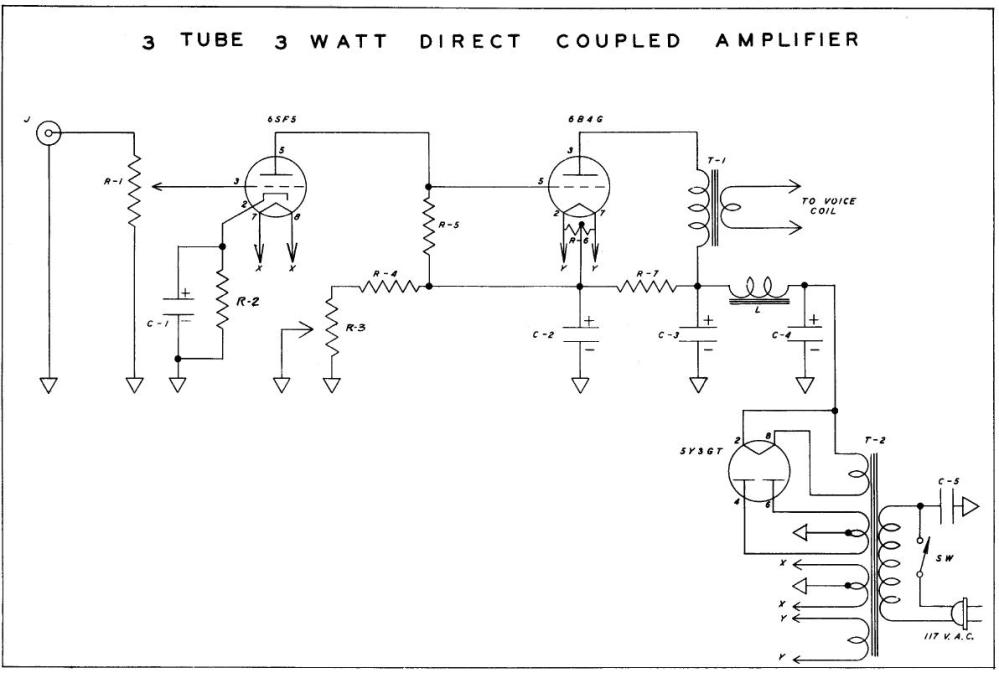

I have not gone through the previous 21 pages of this topic.
(I'm not sure if the fix is completely the same)
Here's some info from audioasylum,
Direct Coupled 6SF5-6B4G Amp Question - SomeJoe - Tube DIY Asylum
look for posts by Ejam
RE: Direct Coupled 6SF5-6B4G Amp Question - Ejam - Tube DIY Asylum
r5 is wrong, but he corrected in the following post.
this fix shows 2 chokes
Fi X Integrated 2A3 SET Amp (Magnequest trannies) and Y Preamp: Don Garber classic units xtra tubes Photo #1565080 - US Audio Mart
the fi x 46 version shows 2 chokes in the power supply
Don Garber's Magical Fi X4 Stereo Amplifier A stunning 1.5 watts with Tung-Sol 46 for only $1095! Review By A. Colin Flood
Your amp is looking good!

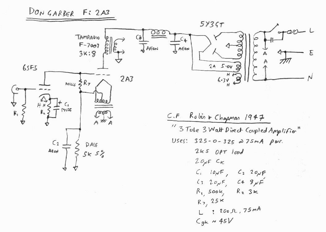

Joined 2009

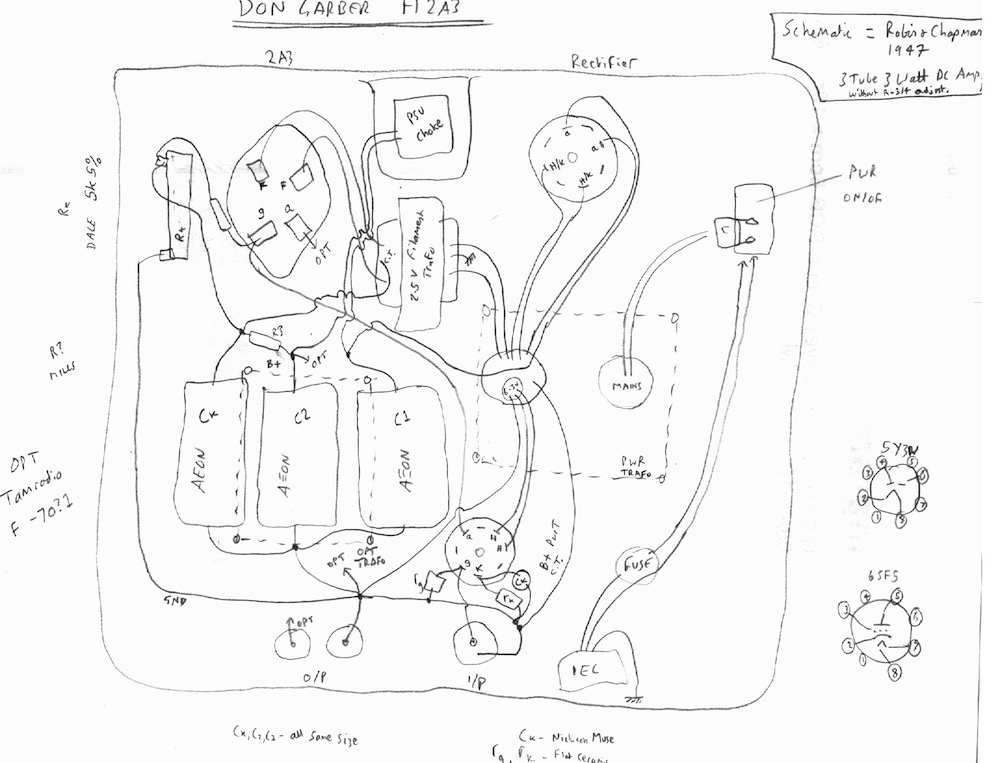

Thanks for those links - I've updated my schematic for the Fi 2A3 accordingly.Here's some info from audioasylum
my amp is back to square one. I'll be ordering a new chassis. I'd like to get it built before the winter is done, it's a 'winter amp'.Your amp is looking good!

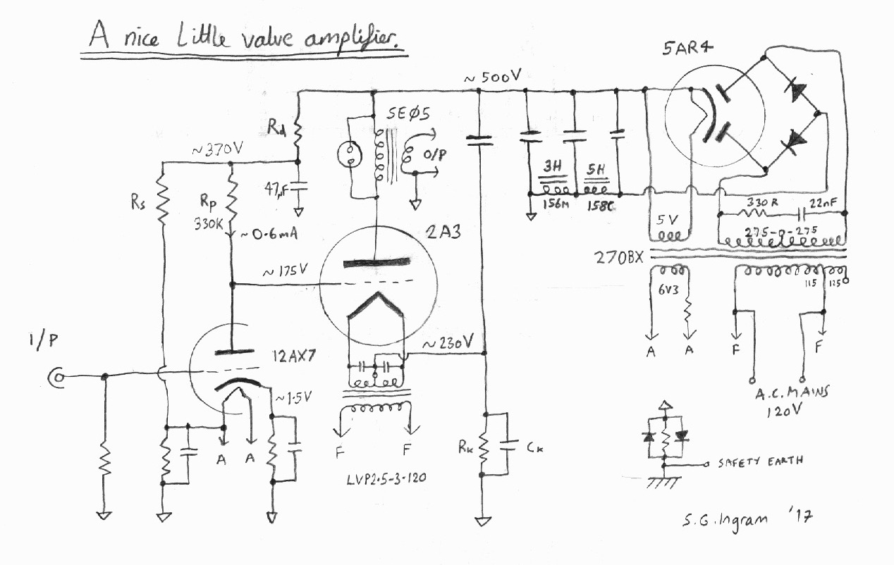

There are a couple of things I'd like to retain from my earlier doodles, rather than cloning the Fi 2A3 as is
a) independent control over the value of the driver plate load resistor which establishes gain and somewhat the harmonic profile
b) the hum reduction from the 'Westinghouse' ultrapath capacitor connection to the 2A3 cathode
c) a two-choke power supply filter, based on advice received about avoiding a large single choke large capacitor supply
My power transformer requires the use of a bridge rectifier to get the voltage I need so I'll use a hybrid bridge as being the closest option.

I just went over the previous 21 pages of this topic-ugh.
Here's something simple,
Simpler SE 45/2A3 Amplifier
2A3 Stereo Amplifier on a Budget
EZINDEX
Some of my amps are on pages 808 & 809, If I were doing this amp I would either hardwire extra sockets to try other tubes or try socket adapters. But space considerations you might not want more sockets. My pp6v6 I use either 12ax7, 6sl7 or 5751- I can't tell any differences. Maybe it's the cct, I don't know. BTW my pp6v6 has only 2 caps in the amplifier cct. from 1951. My Preamp I plug in either 6sn7 or 6fq7 I don't have to look for a socket adapter.
another tube to consider - 6sq7, I've had this on the breadboard I like it. It's= 12ax7 1/2 note- it has diodes Dynaco Push-Pull EL84/6BQ5 or 6V6/6AQ5 Tube Amp Schematic
check half way down (some people will agree and some will disagree) amplifiers vacuum tube systems hi-fi hihighend 6c33c triode SET OTL's
