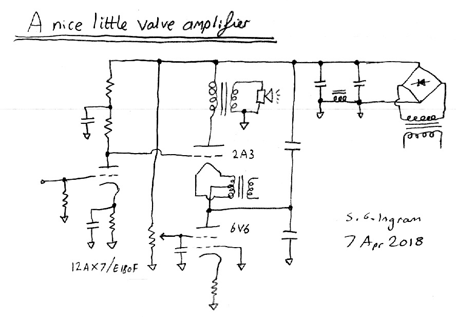

Hi Phil, my thinking is this - there are a lot of very well regarded direct coupled designs that are cathode biassed. I want to build an amp that has pedigree, leaves no doubts as to whether I coulda shoulda done it differently. The dc coupled amp has a delicate balance of operating conditions and the cathode bias provides a robust way to keep things in-check as tubes age, mains voltages vary etc. Yes, there's a cathode bypass capacitor, but fixed bias also has it's capacitors when you look at the signal current loops.
I was thinking
When it comes time to build this amp, and it will be built (we're only a few years into the project now after all), it's going to run hot. It's the cathode resistor on the 2A3, it's going to burn a good 10W or so depending on the final choice of operating points.
I'd rather not have that heat underneath the chassis, but on top with the other hot bits. I don't want a heatsink up on top. So that leaves the obvious choice of burning it off in time honoured fashion of a hot anode. Placing a tube up on top puts all the heat up on top.
Today I found a schematic by Gordon Rankin for a direct coupled 45 amp in which he used a valve as a CCS in place of the cathode resistor. I've seen this suggestion before but never in the form of a proven-out schematic. Until now. His amplifier has been built by others and much praised. Gordon said it was in his top 5 (according to a post by Gordon on another forum). And that has emboldened me. I'd normally go with the simple approach, just put a resistor in there. But a valve based CCS lets me put the heat somewhere else.
Gordon used a triode wired pentode which has the advantage of lower noise (bear in mind, it's shunted by a capacitor) and no requirement for a separate screen supply. But a pentode is a much better CCS if left as a Pentode so I thought of starting there. See attached. Of course, it may still be better to go with the triode wired pentode option since it's still going to have a higher resistance than the cathode resistor would have had. Not sure which approach is best on paper but Gordon must have given it some thought. Being adjustable could be very handy for messing around - it would allow for some tube rolling between the more robust JJ-2A3-40 and some of the less able tubes, or even substitute a 45.
Getting fancy could mean sizing the screen capacitor (see attached) to slow down the turn-on current draw of the 2A3 since this cap has to charge up through the screen pot.

A 2A3 and 12ax7 should sound very good. I would spend a little more on the transformer and get a 20w SE transformer making for a very sweet midrange and highs and solid bottom end.
The 6v6 as a current source is an interesting idea that may add flavor as opposed to a resistor bypassed by a 100uf capacitor

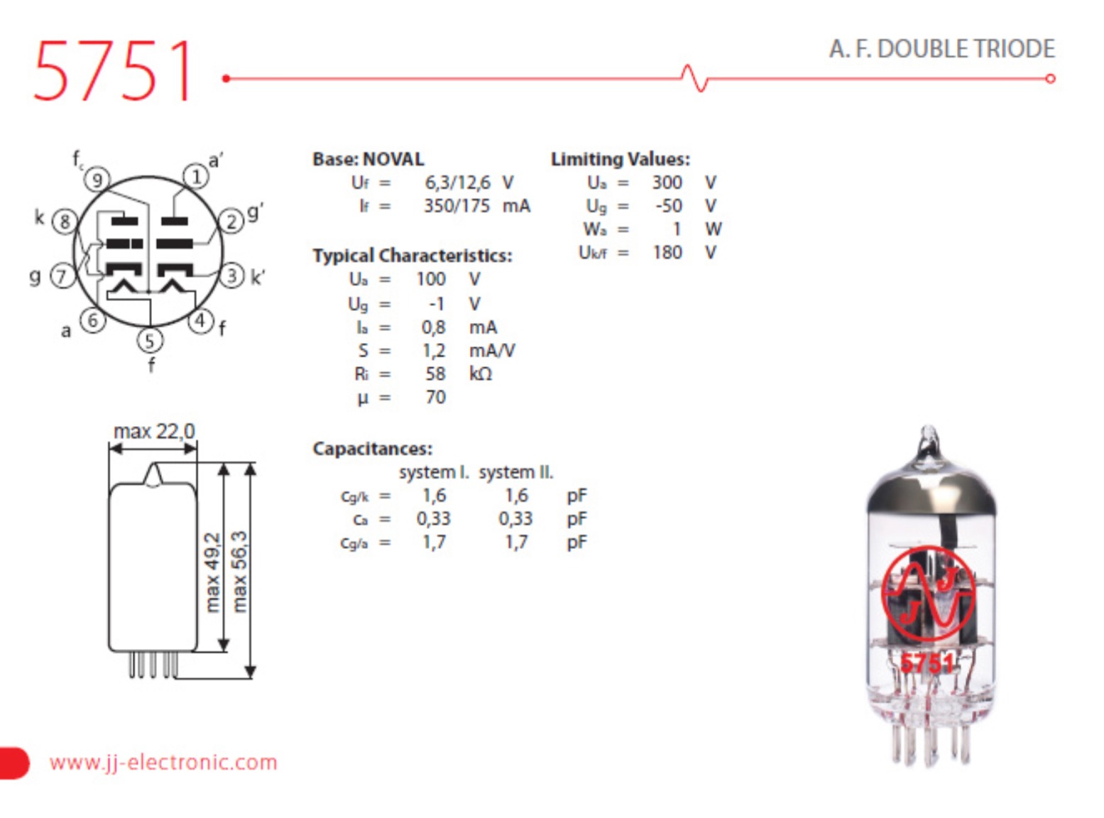

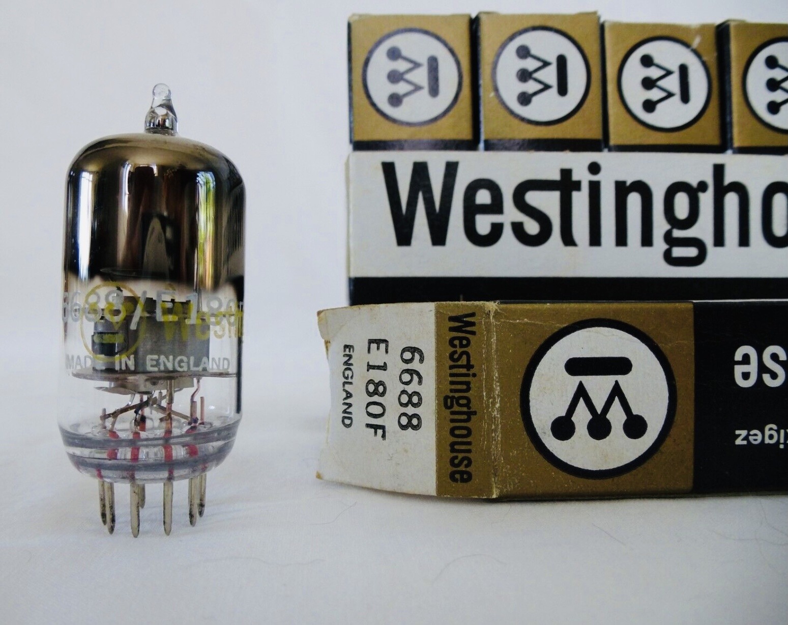

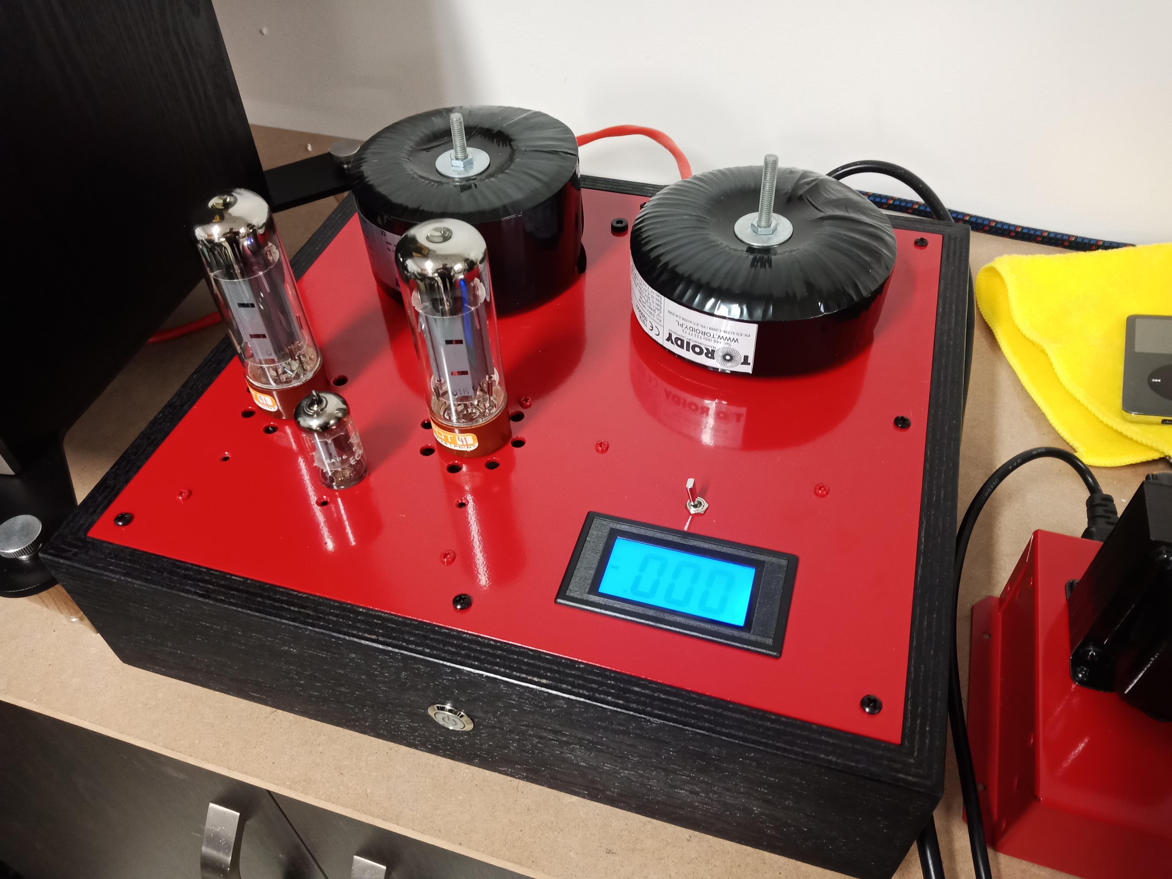

Now that I have my Kondo-Ashizawa M7 up and running it’s time to revive this thread and finish building my nice little valve amplifier. When I ordered the valves for the preamp I included a JJ 5751 with the idea of it being an option for the input valve of this amp. I’ve also ordered some E180F pentodes which can be triode wired to give another driver option with more drive capability if the 5751 doesn’t satisfy.
