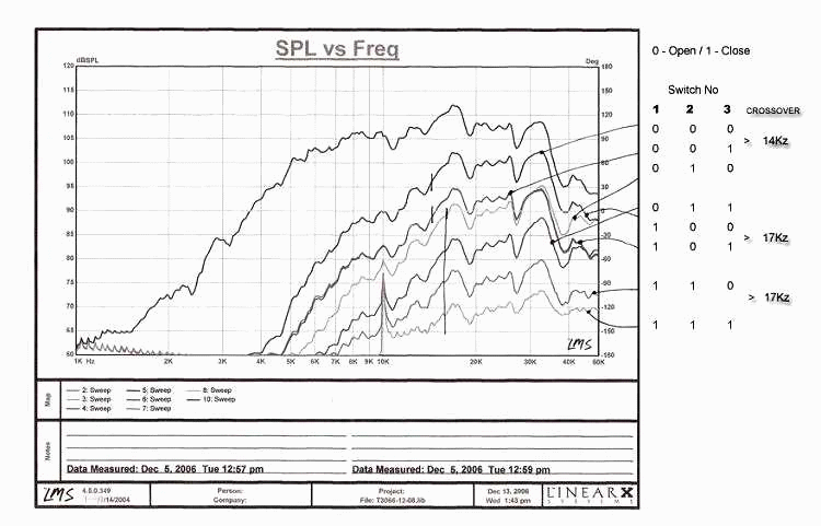

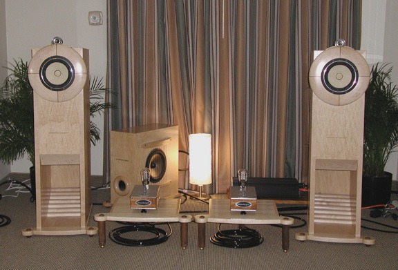

Yesterday evening I was reading this article about supertweeters: https://www.tnt-audio.com/casse/jb_supertweeter_e.html
What is your experience with them generally and with FHXL and Silbury?

It's completely dependent upon design & implementation unfortunately
so there's no single answer beyond that. Without a proper crossover in place, they will almost certainly have some destructive interference with the main unit over the transition band / shared BW before the main driver eventually rolls off, but how & what = see above, along with where you happen to be listening as this will also shift about depending on axis.
Thanks @Scottmoose ,
I’ve seen those have three switch to modify their response:
As far as I understand I should place them on top of the FHXL and on the side of the Silbury.
Do some of you use them, or stick with the FullRangers only?
Thanks again!
Roberto
Thanks again!
Roberto
Roberto, speaking for myself only, after playing with several of the earlier MA models in both paper and metal cones, I determined I generally preferred the latter, and never felt the need for any augmentation at the top end.
If however you feel that need, or even simply want to experiment, then I think your supposition for proximity to acoustic centre of main wideband driver would prove most efficacious. That was the configuration used by our long departed friend Terry Cain with his BEN and Double BENs

As physically close as possible to the main unit is generally preferred
Given the necessarily large separation (reletive to the quarter wavelength of the XO frequency, you will get a lot of combing. Response from constructive and destructive cancelation usually means that teh response is onlky right in a very small volume of your listening room (head in a vise).
Seems to work out some of the time, you have to try it, and many find firing the tweeter upward or backward works better.

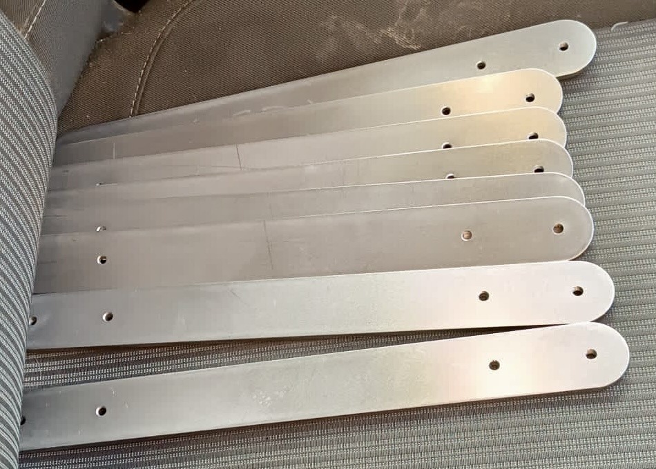

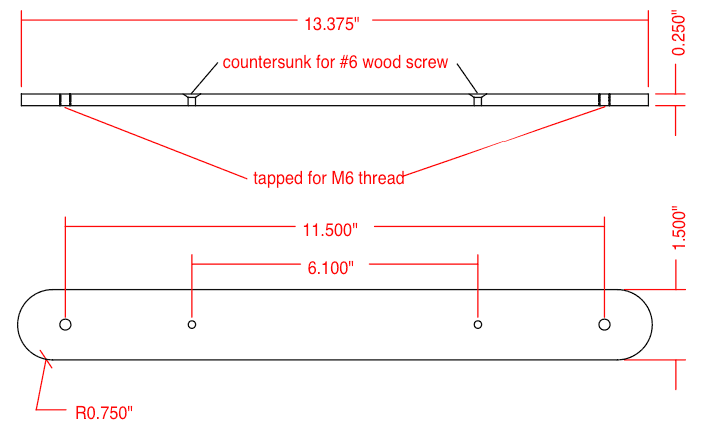

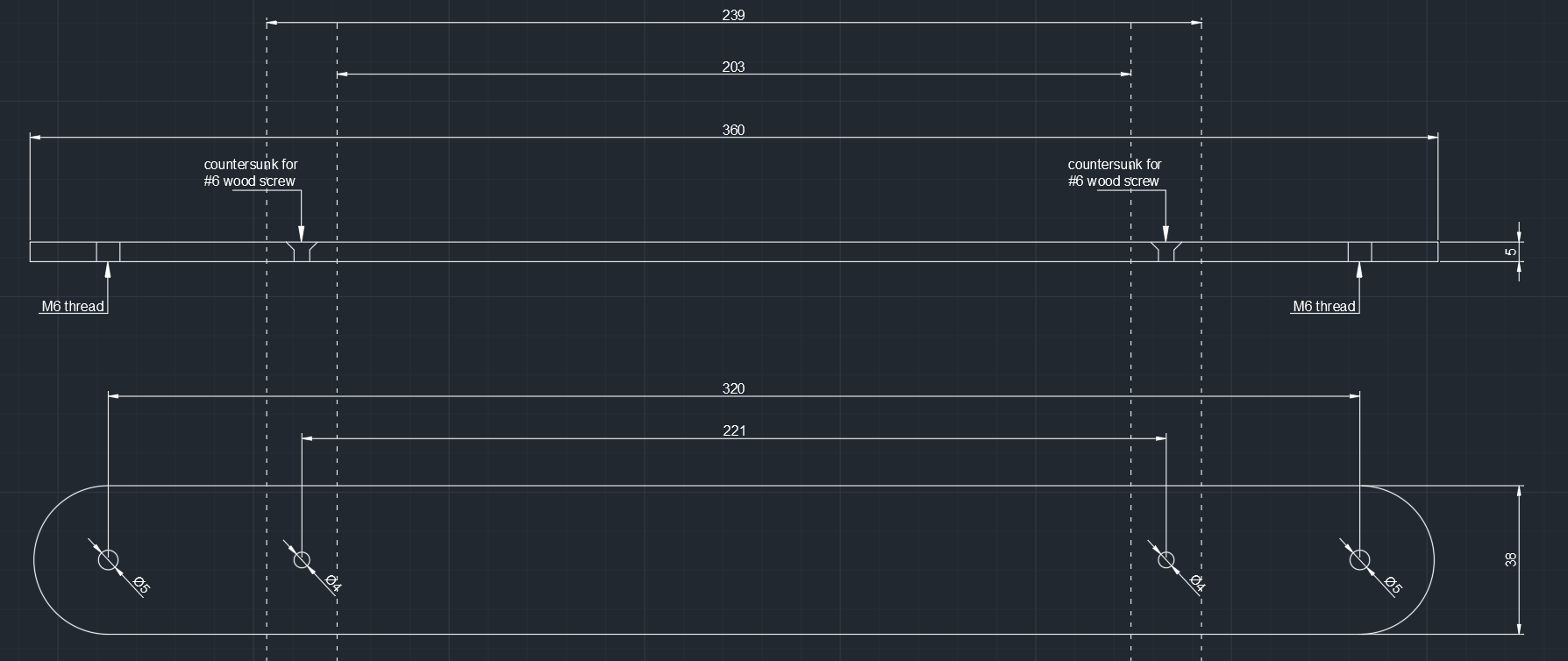

What about moving the wood screws inside lateral panels of the cabinets, in order to use longer screws?
Like this (dimensions in mm, side panels of the cabinet dashed):
IIRC, those countersunk holes were located so as to be centered on the vertical side panels of the FH3 for which the were originally fabricated, and on my own installs the wood screws were probably 2” - 2 1/2”?
They were aluminium bar stock, so it was certainly easy enough to drill new holes should that have been necessary.
Indeed you are right @chrisb !
https://www.frugal-horn.com/downloads/frugel-hornMk3-1v0-060518.pdf
The centers of the vertical panels are around 6" apart in the FH3.
I will then use the below (simplified with 4 holes of 5 mm diameter, in order to thread for M6 and use 4,5 mm wooden screws):
I will order 8 of them, lasercut, as Silbury and FHXL have the same front width.
Countersunk will be done later on. Threads if needed.

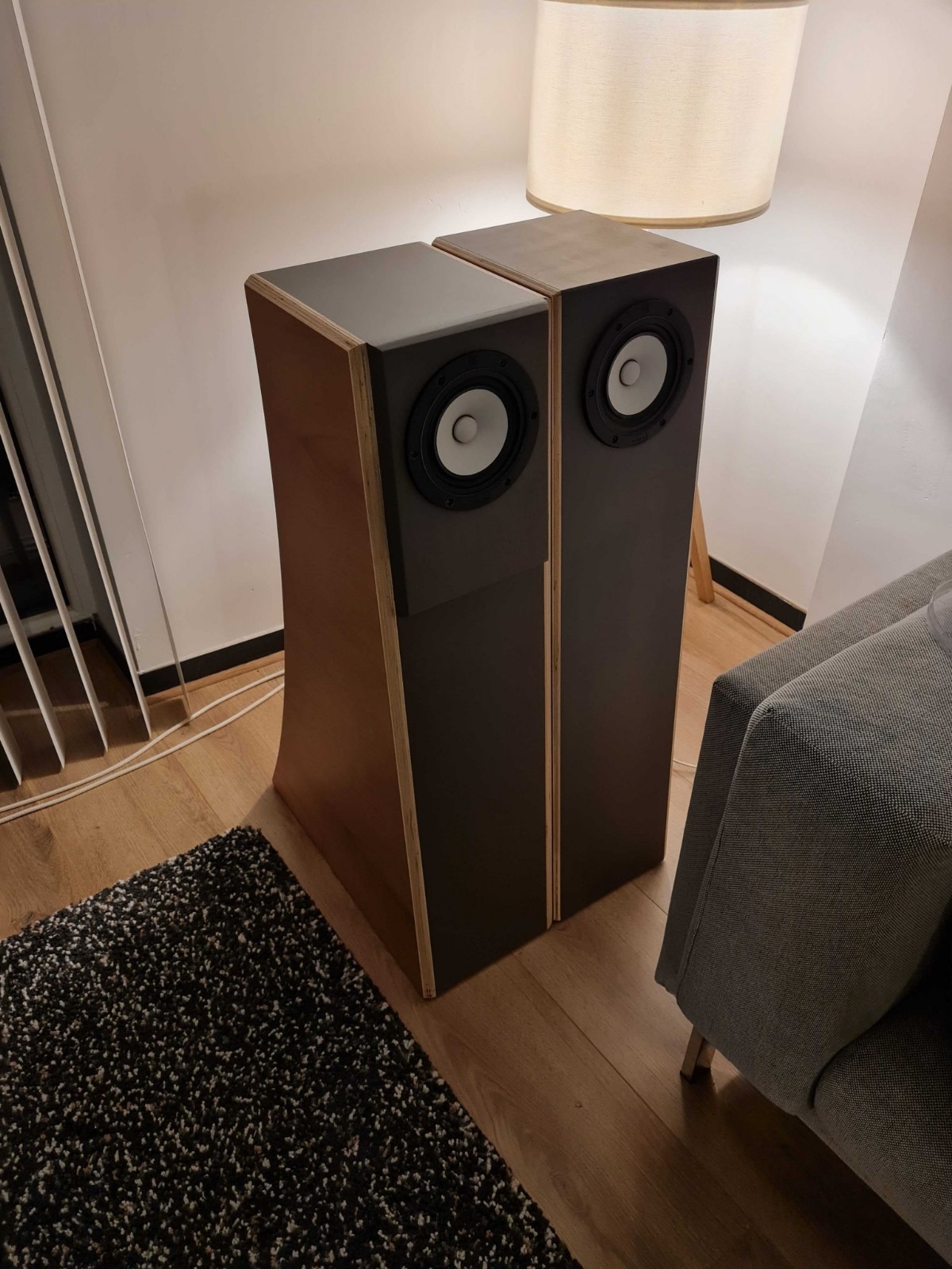

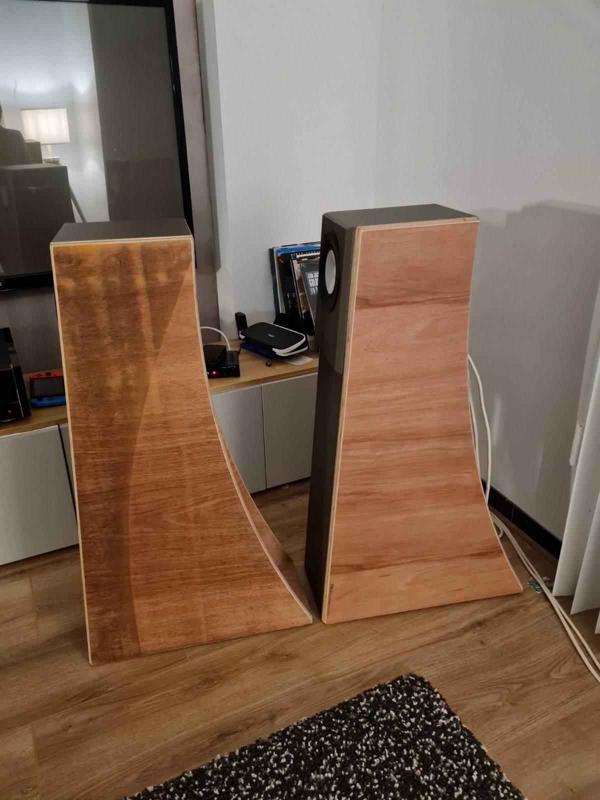

My guess is that’s entirely the luck of the draw on the slip matched flitches of rotary cut veneers on the top face of sheets, and in the case of the left enclosure on top photo from “sun-burn” due to extended storage of materials with partial masking from stacking, to which some species are more susceptible than others.
Looks like meranti or some other tropical species to me, but those are just guesses.
I was always more inclined towards vertical grain orientation, which dis make for creative cut plans for enclosures such as these with irregular shaped side panels. Some of the cut sheet plans in Dave’s drawings referenced above were layed out for than purpose. They needed be even more creative when highly figured species such as bookmatched American black walnut or cheery were used for final post veneering. Much fun.
Thanks, my idea is more about keeping the wood as it is on the sides (see first picture at post #92: https://www.diyaudio.com/community/...speakers-newbie-questions.398826/post-7474296 ) and enhance the grains with a warmer general look, while having another colour on the front&rear (probably fitting the stainless steel & wood internal stair or the pellet stove).
Saw those earlier, and don’t think I complimented the workmanship. I hope you enjoy completing the project and the first playing - even with repeated build of similar enclosure designs, that first date was always fun.
Outriggers are ready, this evening they will be polished.
I made all holes with a diameter of 5 mm so the outer ones can be threaded for M6 and the inner ones fit 4,5 mm wood screws.
With the dimensions I used above, outriggers exceed 60 mm per side from side panels, being 360 mm wide totally.
More than enough for the FHXL, and still good for Silbury IMHO.
