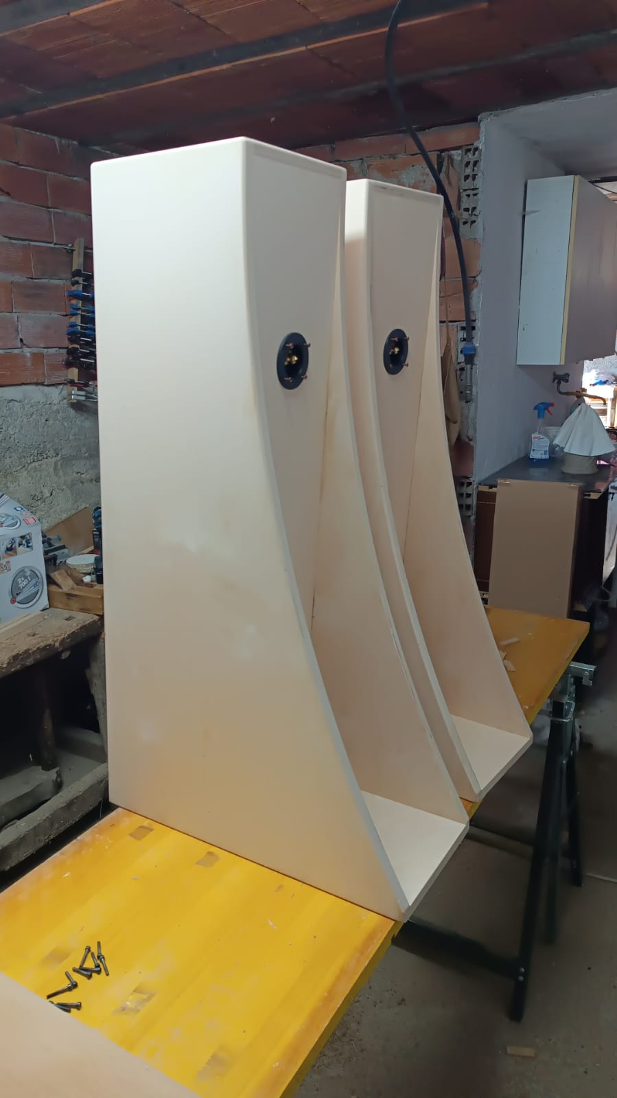

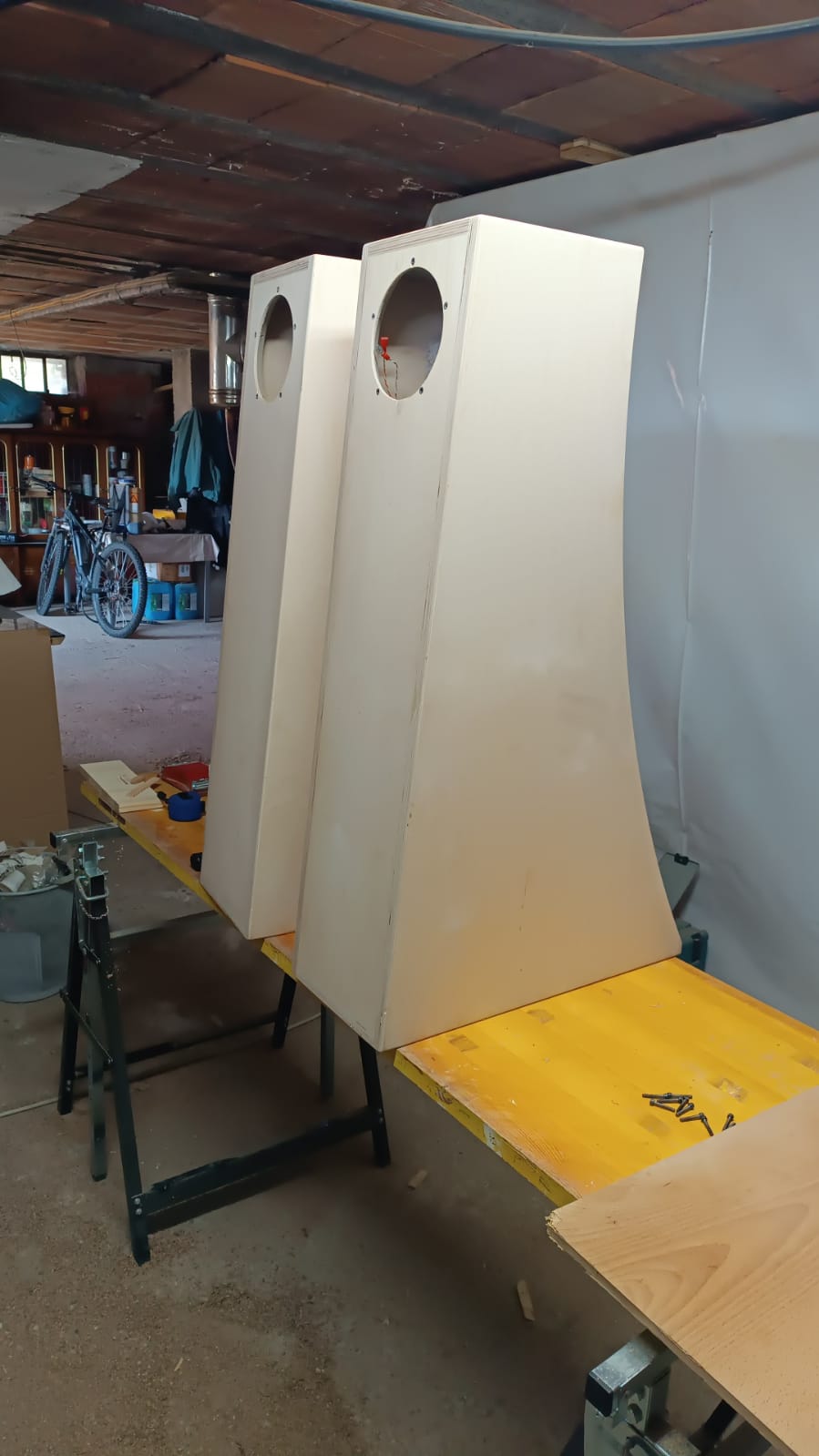

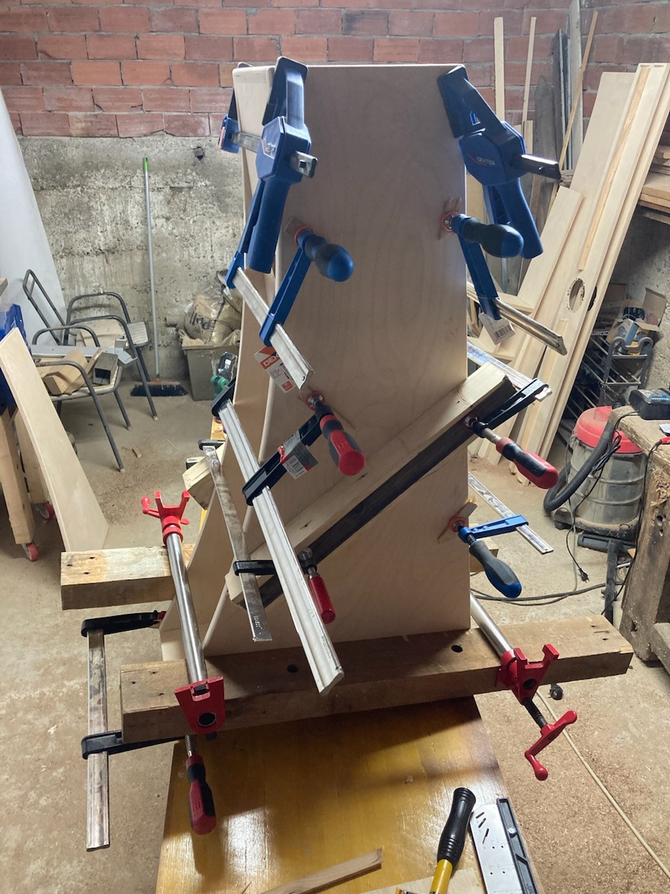

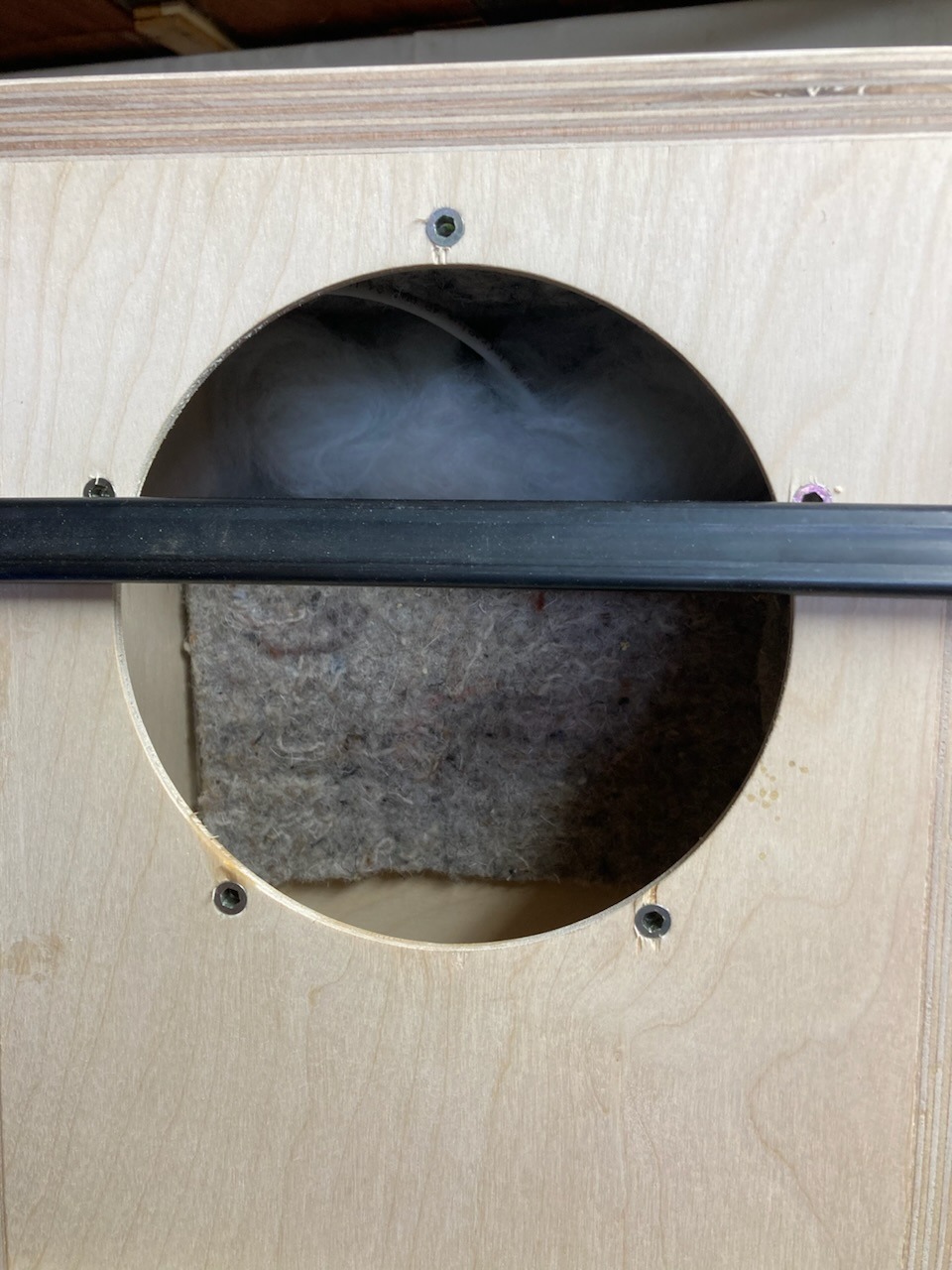

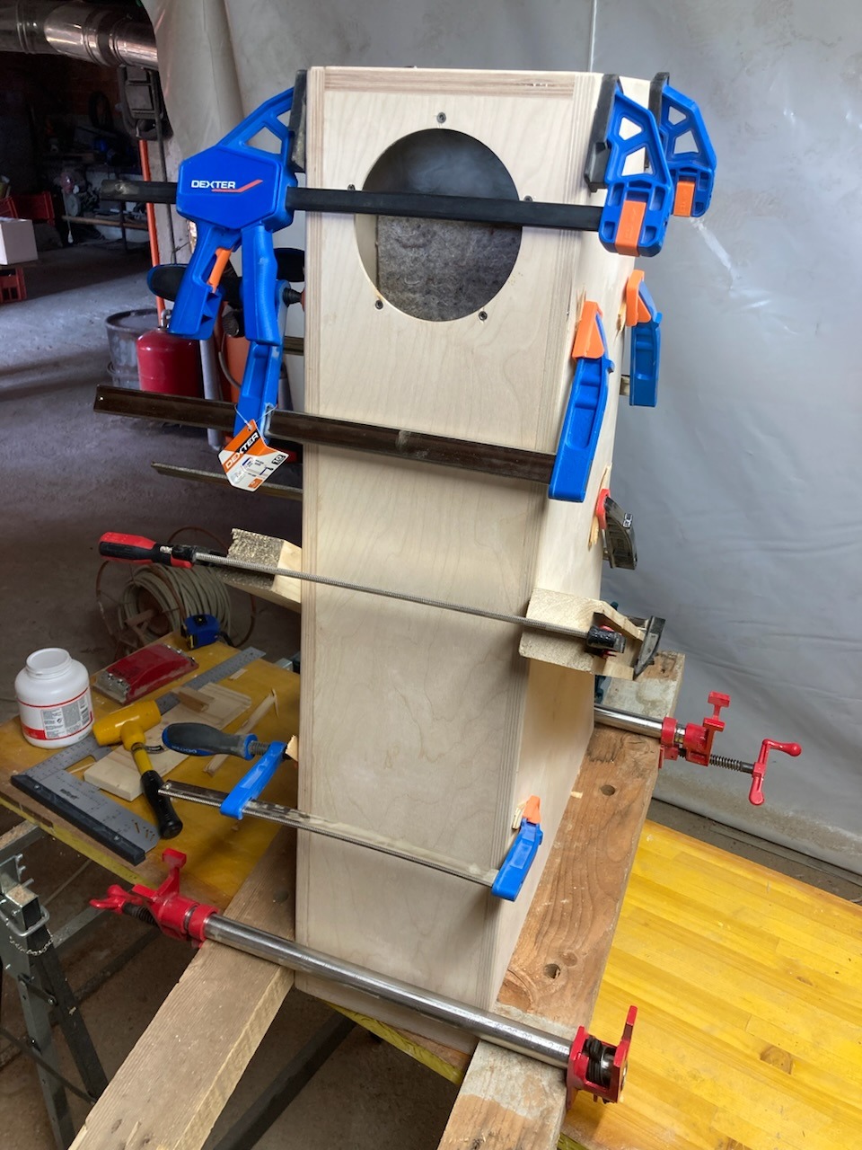

Glueing in progress for one FHXL. The other will follow. Silbury on the background.
I haven’t used that much vinavil, but some leaked when the panels have been pressed together.
I’ll add the last felt when the cabinet will be glued.

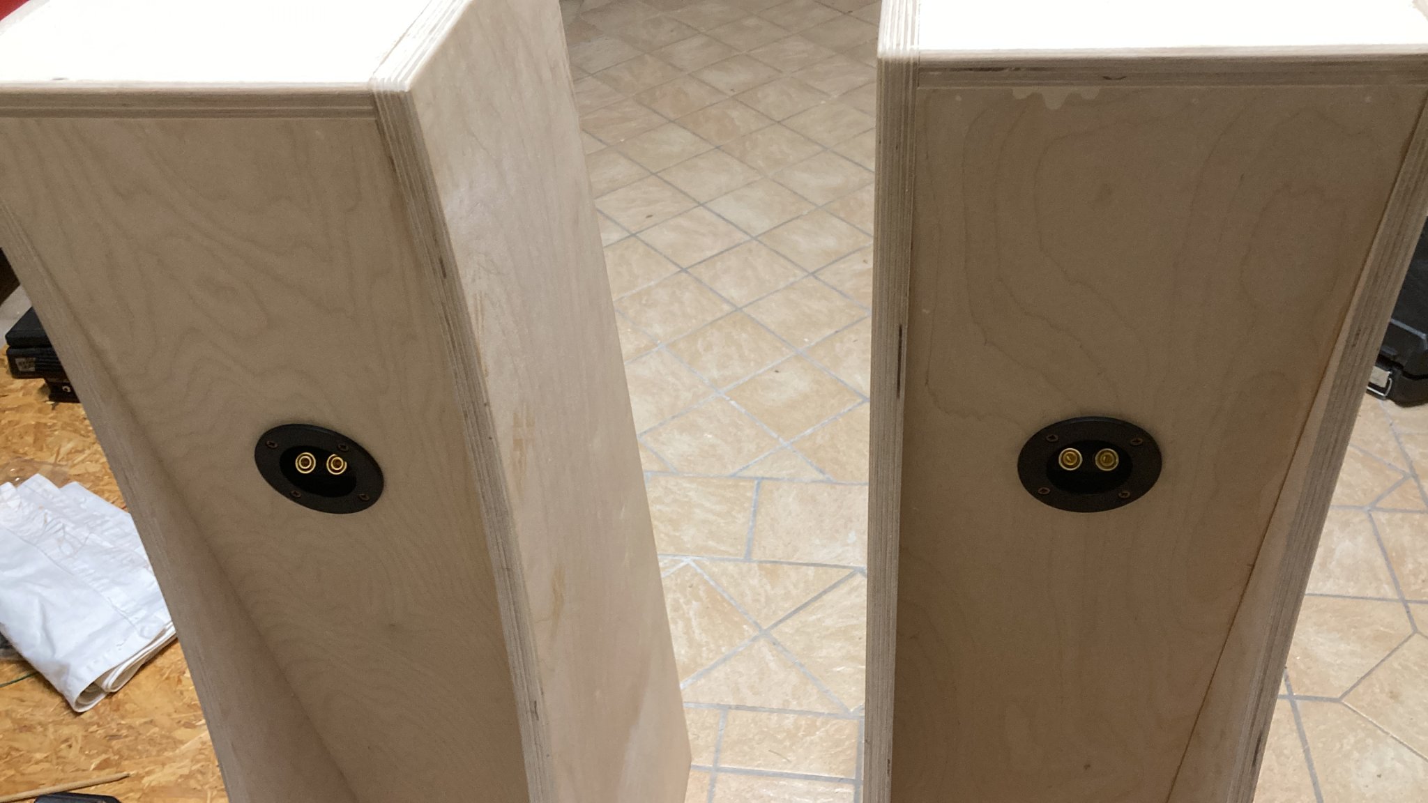

Added a complete Ethernet cable inside, only one pair will be used. Do I need to remove the rest of the cable?
I will use an o-ring to close the connectors in the back.

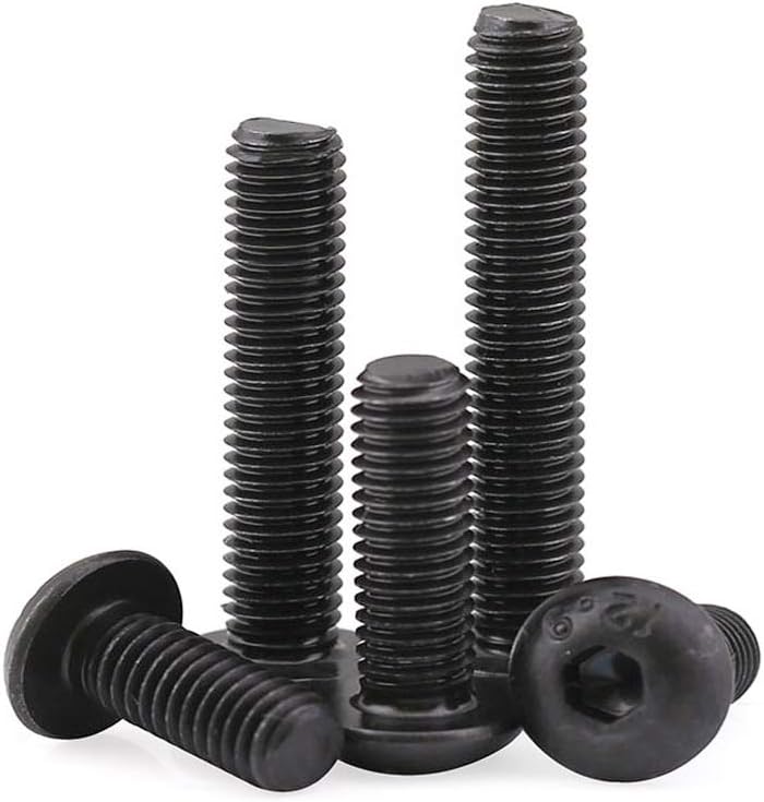

One advantage I’ve found for those threaded inserts I’m using to fix the speakers, is that you can simply make a full circle at 45 degrees on the back of the speaker hole without worrying about leaving more wood for wood screws.
Exactly! I use five M5x20 mm for each speaker (six for the MA10.3), burnished as they disappear when you look at the speaker, with allen-key connection to avoid the the screw driver slips and damages the speaker, cilindrial headed for the MA10.3, semispherical for the MA11ms because of the shape of the speaker: they fill better the holes for the screws without exceeding outide the blunt shape.
It is indeed enough an M4, but the M5 fills better the five/six hollows for the bolts, and it’s tighter in the holes.
One step further: internal Ethernet cable connected, it needs only the two 11MS and an o-ring on the rear to seal the speaker connectors.
Tomorrow they will start playing music!

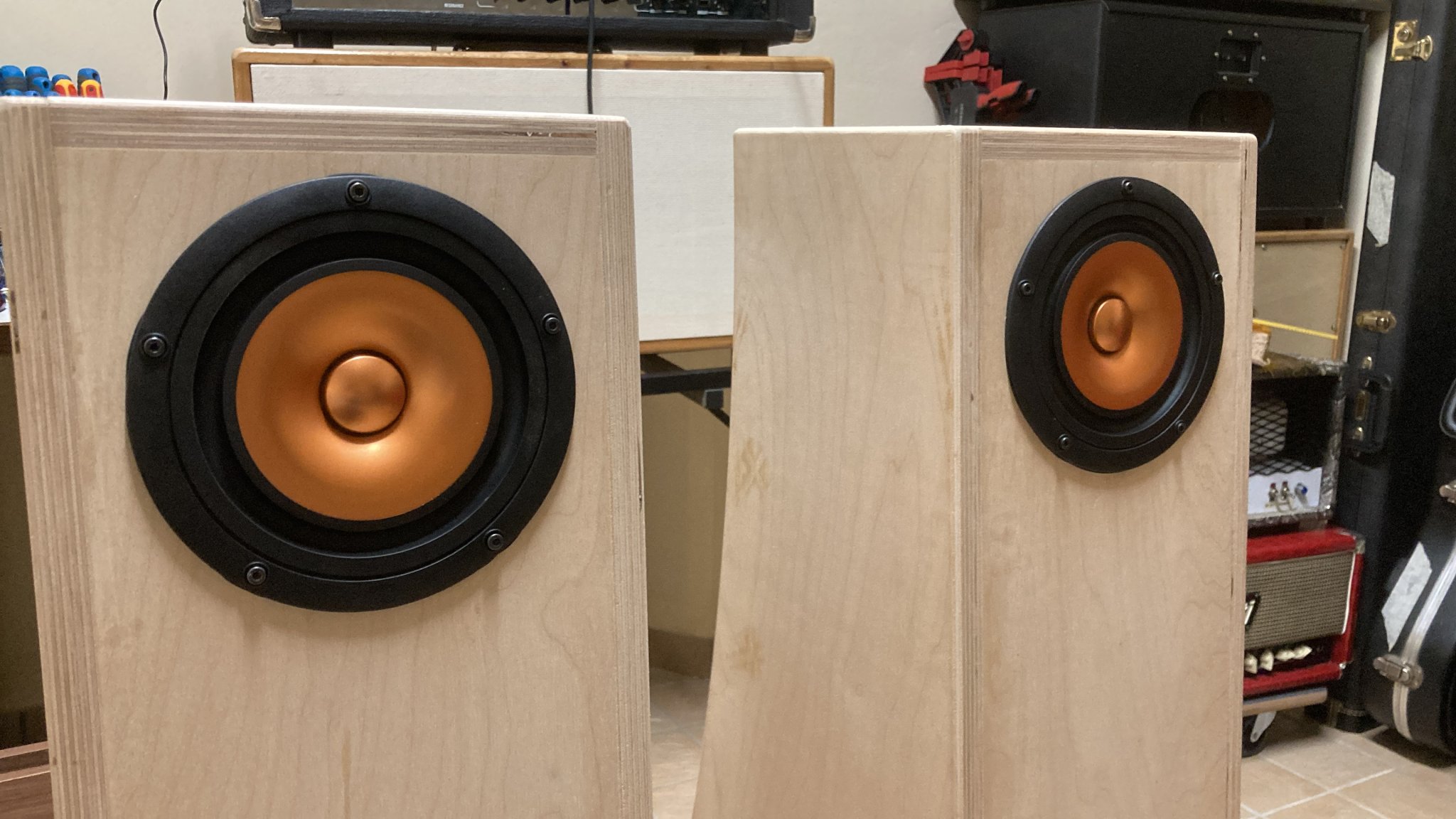

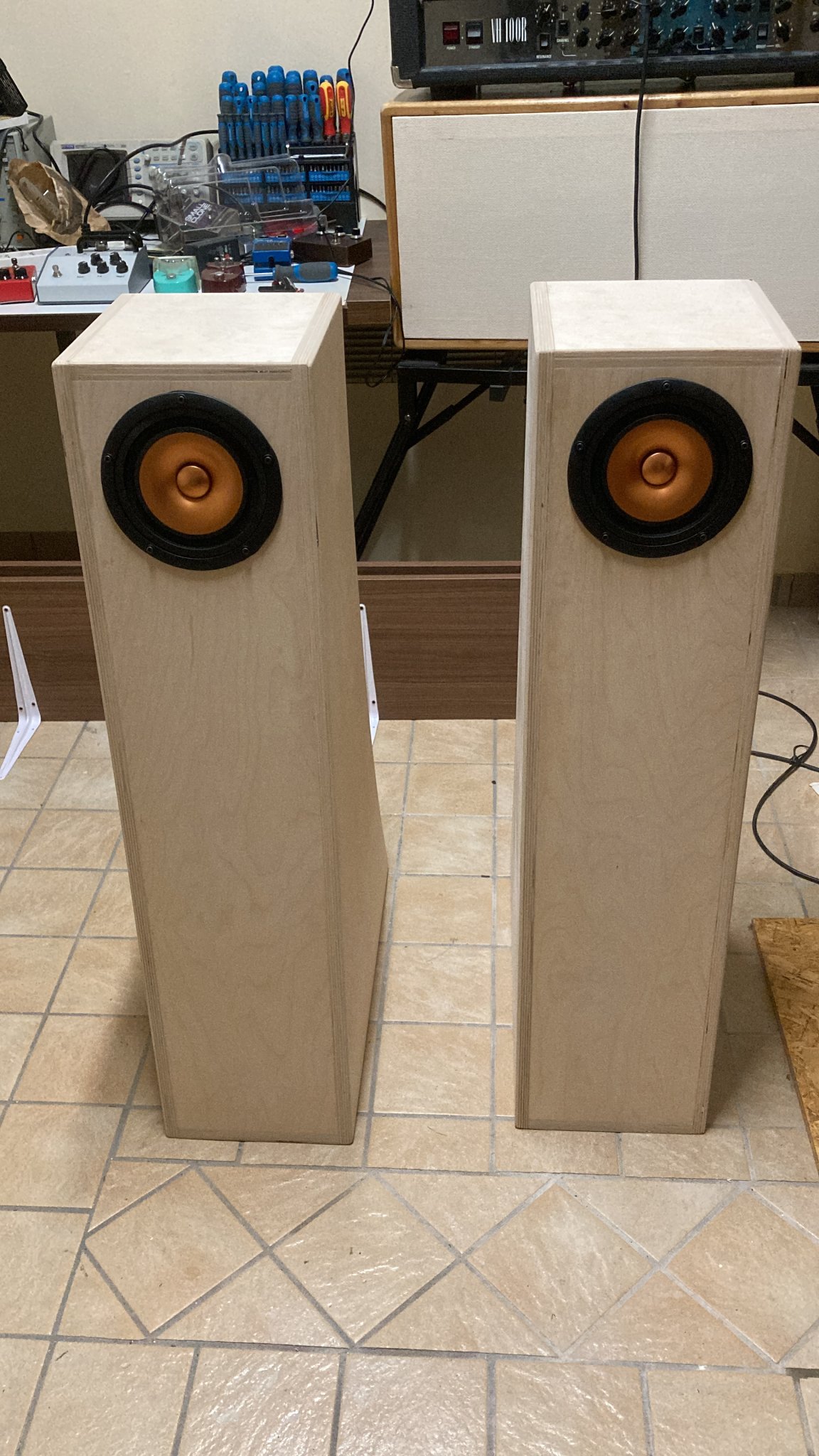

Speakers installed: couldn’t wait.
After dinner I will try them!
First time I ear a pair of fullranges, and I know they need to break in, and I also know they they need to be correctly placed and probably adjusted in stuff.
I’m currently using them paralleled with one single channel of a EL34 push-pull with local feedback to triodize their curves and get a DF around 2.
The FHXL sound astonishingly full. No need for any support on lows.
Midrange is also there (a bit more than expected?), probably I need to set my listening position better than now, as highs are the only ones a bit behind.
Overall, a great speaker since the first minutes.
I’ve listened to Sting, Mesolella, Daft Punk, Toto, Muse, Ryuichi Sakamoto, Snarky Puppy, Michael Landau, Maceo Parker.
I tried David Guetta just to check the versatility of those speakers, and it sounds sublime.
Thanks @planet10 @Scottmoose for these marvellous speakers, can’t wait to optimise the full chain.
