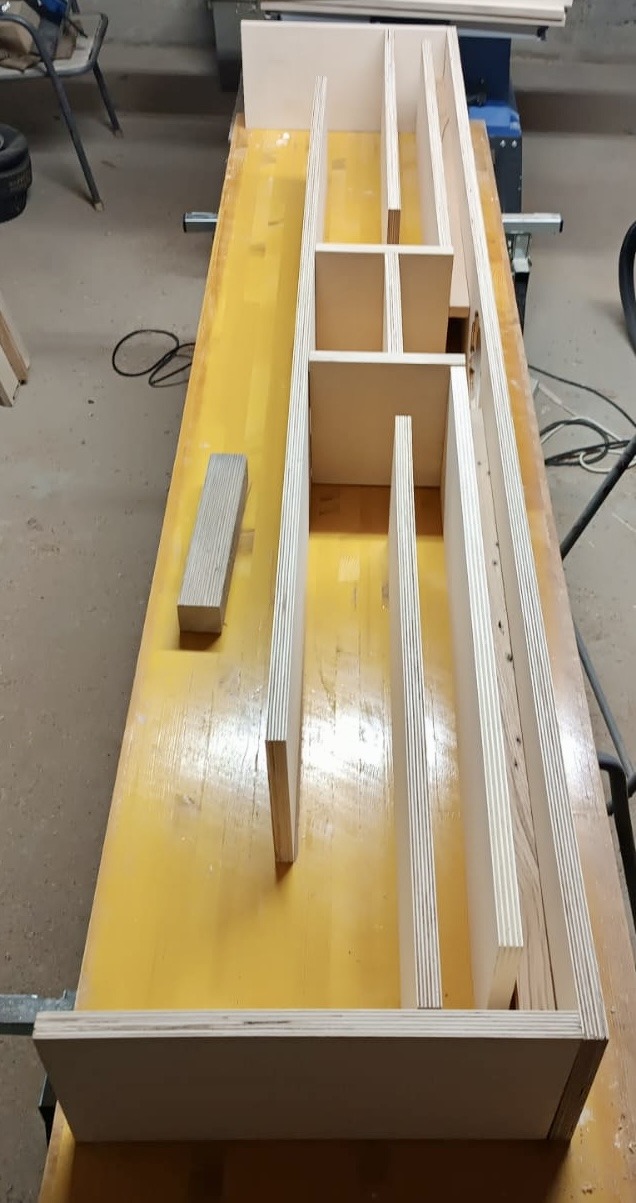

@Scottmoose I had an old version of the Silbury files and noticed few days ago that baffle bracing was indicated with a shorter measure. I have four seasoned pine-wood pieces that I can adapt to the needed dimensions for bracing. Can I use it?
The shorter works more or less as well, but the longer was introduced more 'for completeness'. 'Short' version is sure. And seasoned pine should be fine -although I'd suggest it's sealed to ensure consistency.

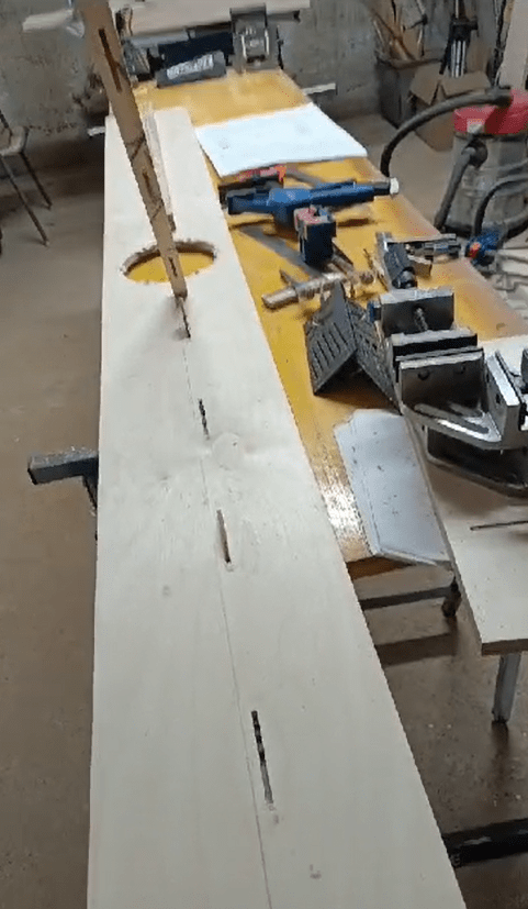

Thanks! I will use wood bisquits to fix it to the baffle and the other surface. The same I’m using for the rest of the cab.
I will drill a circle on the back of the speaker, with a small hole in the central panel to let the ethernet pair of cables to pass through, hole filled then with glue.
I’m lining the chamber behind the speaker, everything else is naked wood with no lining nor stuffing.
Good start. You may (by design) find depending on system & room characteristics that you will need to add a little extra damping in the final stage of the horn expansion -they're a high-gain type by intent, since it's always easier to get rid of excess than increase what doesn't exist in the first place.
This brace was added after the first build (Victor) showed they were required.
as long as the brace is more or less continuous you will be fine. It really matters little if you make it out of 1 or 2 lengths. Do add some glue to the ends so the 2 shorter pieces essentially become one.

Thanks,
FHXL cabs are in 18 mm birch plywood. I added some glue to be sure the V-shaped panels were properly sealed, and I will add some bisquits as well.
Silbury is in 18 mm birch plywood except two small panels inside the cabinet that are in poplar plywood, and those four braces that will be in seasoned pine-wood (here below).
