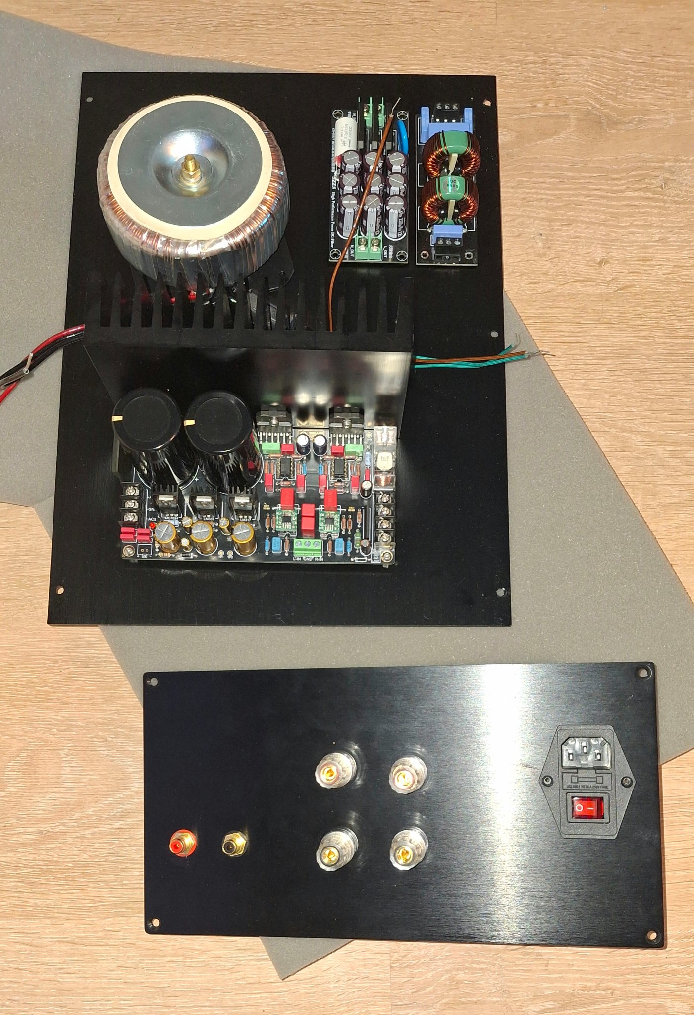

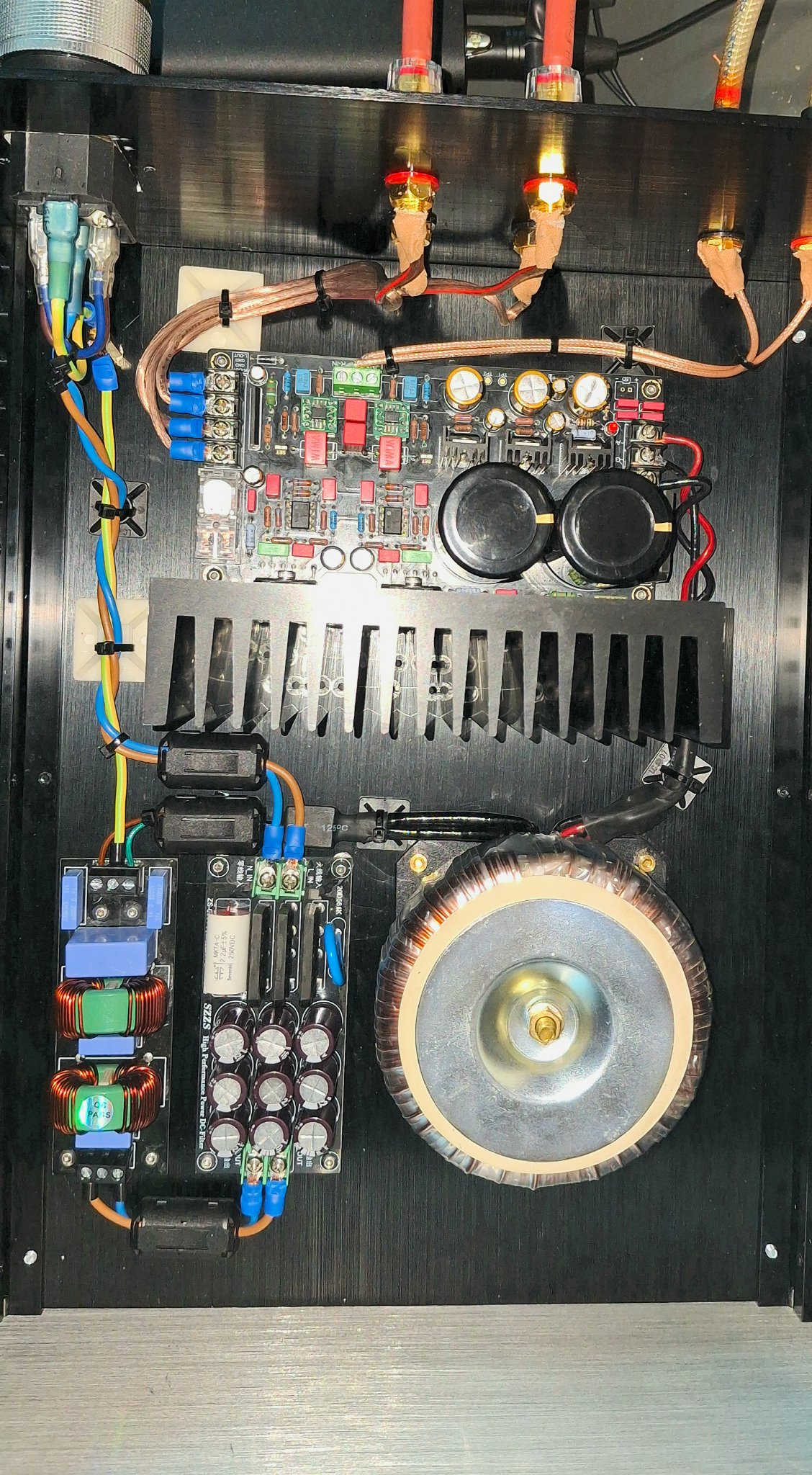

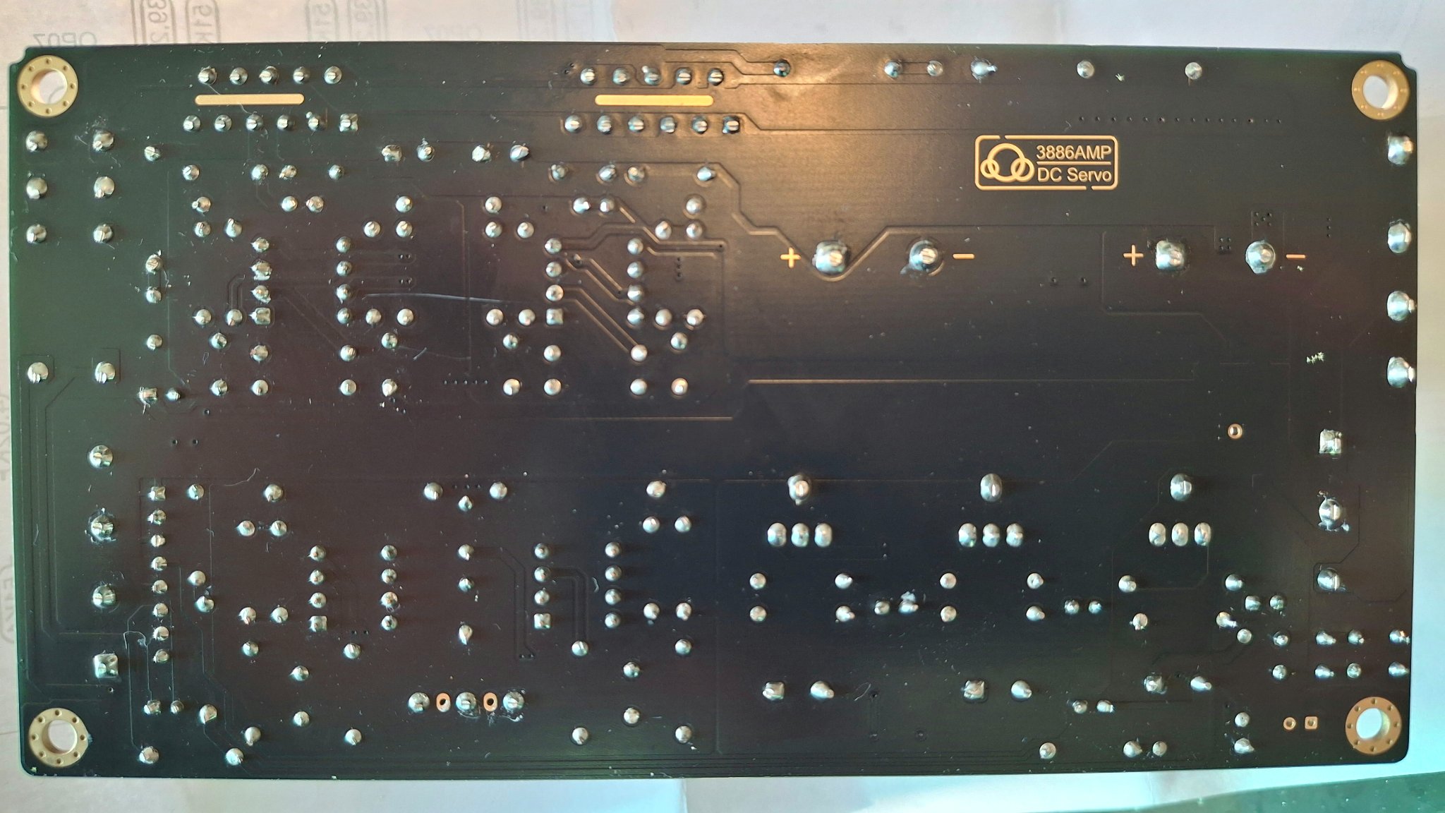

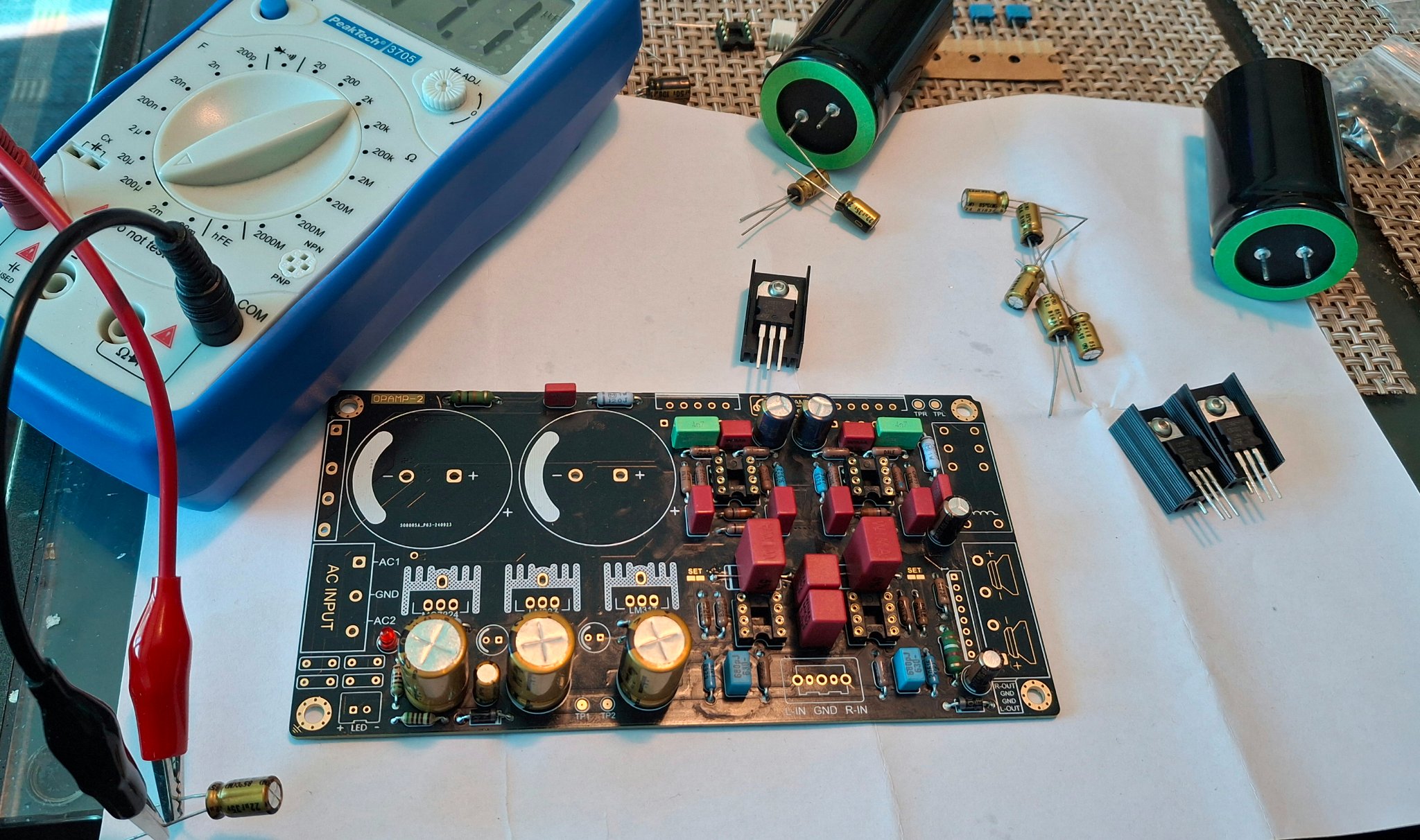

I've been building chip amplifiers and even simple discrete circuits for over 30 years, albeit with only a limited knowledge.
I'm actually a qualified restorer of paintings, sculptures, and murals. Because of my love of audio electronics, I sought another apprenticeship in 2003, but unfortunately, I only found one as a mechatronics engineer for automation technology. It was better than nothing, and I thought I'd definitely be able to build my own CD player after the apprenticeship, but that wasn't the case. In the end, after my apprenticeship, I knew a bit about PLC programming, milling, turning, motors of all kinds, and hydraulics. Electronics, especially analog circuits, weren't covered in any of the learning areas, so I've continued to be self-taught to this day!
I've always been satisfied with my self-built devices, but I've always used purchased devices as my main system.

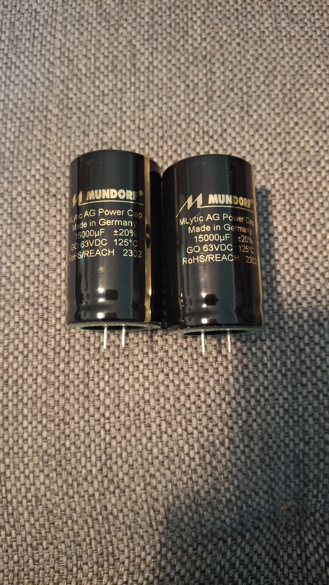

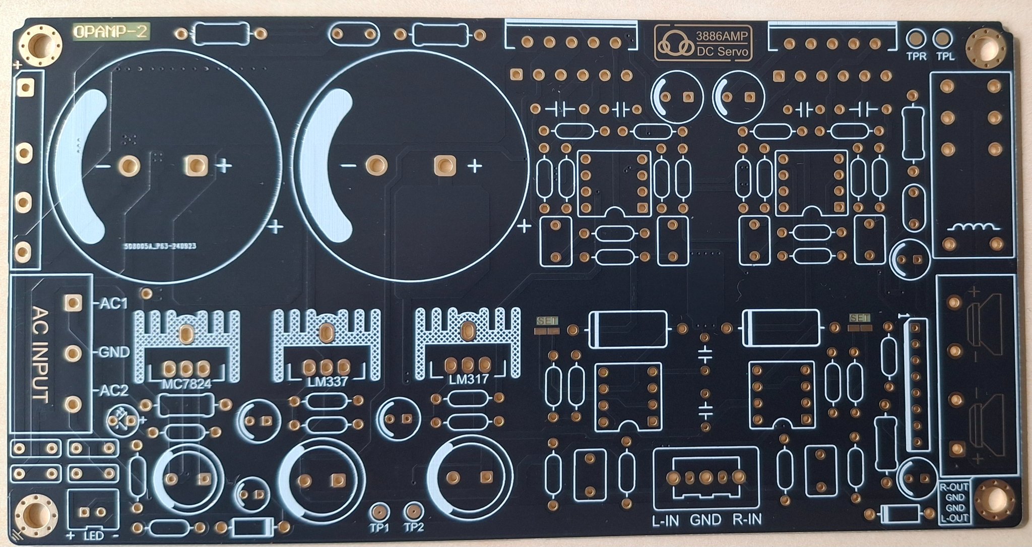

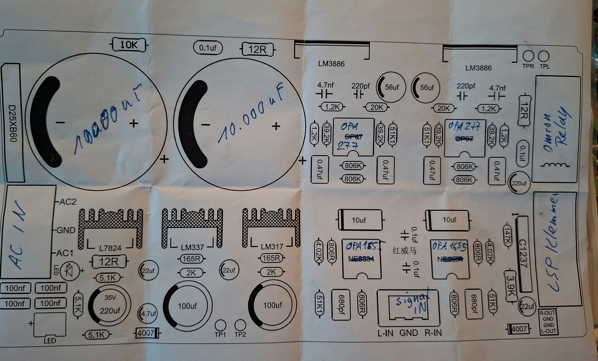

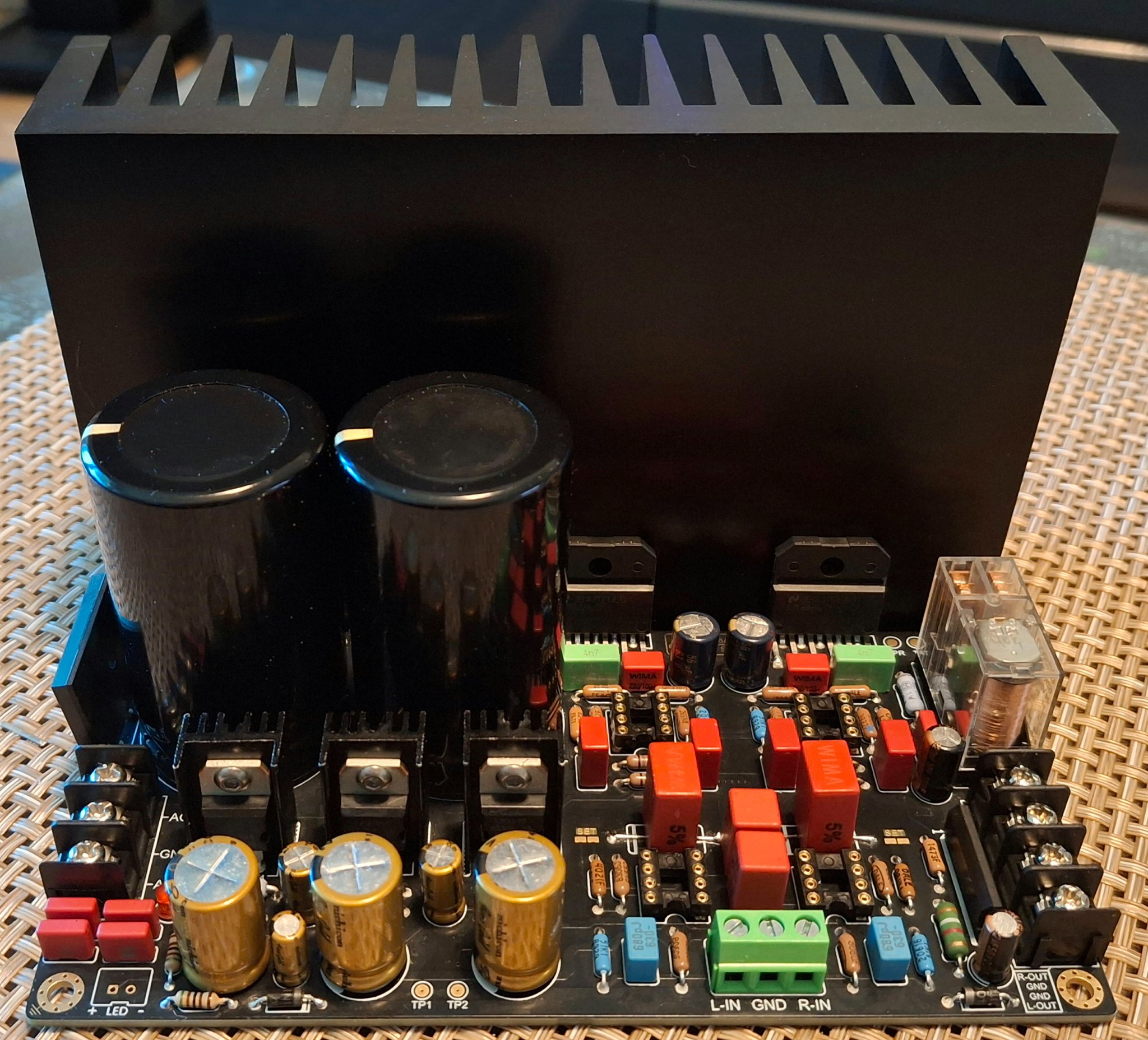

That's changed, though, since I built my last amplifier with the LM3886. By chance, I got a circuit board called DC-Servo from a private seller. It looks very similar to the boards with the Cirmech logo that are sold on eBay and AliExpress. After weeks of research, I acquired a component layout plan, which differs considerably from the one shown on Alibaba for the Cirmech boards. I got all the components and measured them to an accuracy of less than 1%. Because it is a stereo amplifier, I paired the components for the left and right sides exactly. I used two OPA1655s as operational amplifiers and the OPA277 for the DC servo. I had soldered DIP adapters onto the board from the start so that I could test different operational amplifiers. I soldered in two Mundorf Mlytic 15000uF as the main electrolytic capacitors in the power supply, and Nichicon fine gold electrolytic capacitors for the voltage regulation for the operational amplifiers. All resistors are Vishay CMF55, CMF60, or Wellwyn metal film resistors. I used 10uF Wima MKS electrolytic capacitors for the operational amplifier. All small high-frequency filter capacitors in the signal are either Wima FKP or Roederstein KP capacitors. I also replaced the small 100nF capacitors used for noise suppression on the operational amplifiers with 1uF Wima MKS capacitors. Below the circuit board, I connected a 100nF X7R capacitor in parallel with all the capacitors in the circuit. I'm attaching photos of the amplifier and the component diagram to this post. Can anyone explain exactly what I've built and why it always sounds better than my Naim Nait 5si when used with several different speakers? The sound is just as dynamic and solid as the Naim, even at higher volumes, but much more transparent, spacious, and natural.

I tried the following op amps:
OPA1655
OPA1641
OPA1611
OPA1611+ClassA (China, AliExpress)
OPA134
Sparkos SS3601
Burson Audio S7vivid pro single
Burson Audio V6
OPA627 single version
NE5534
The OPA1611+ClassA has by far the best sound, but because several op amps in the shipment were defective, I decided against it.
The second best is the OPA1655, although the OPA1611 sounded a bit more natural, but lackluster.
