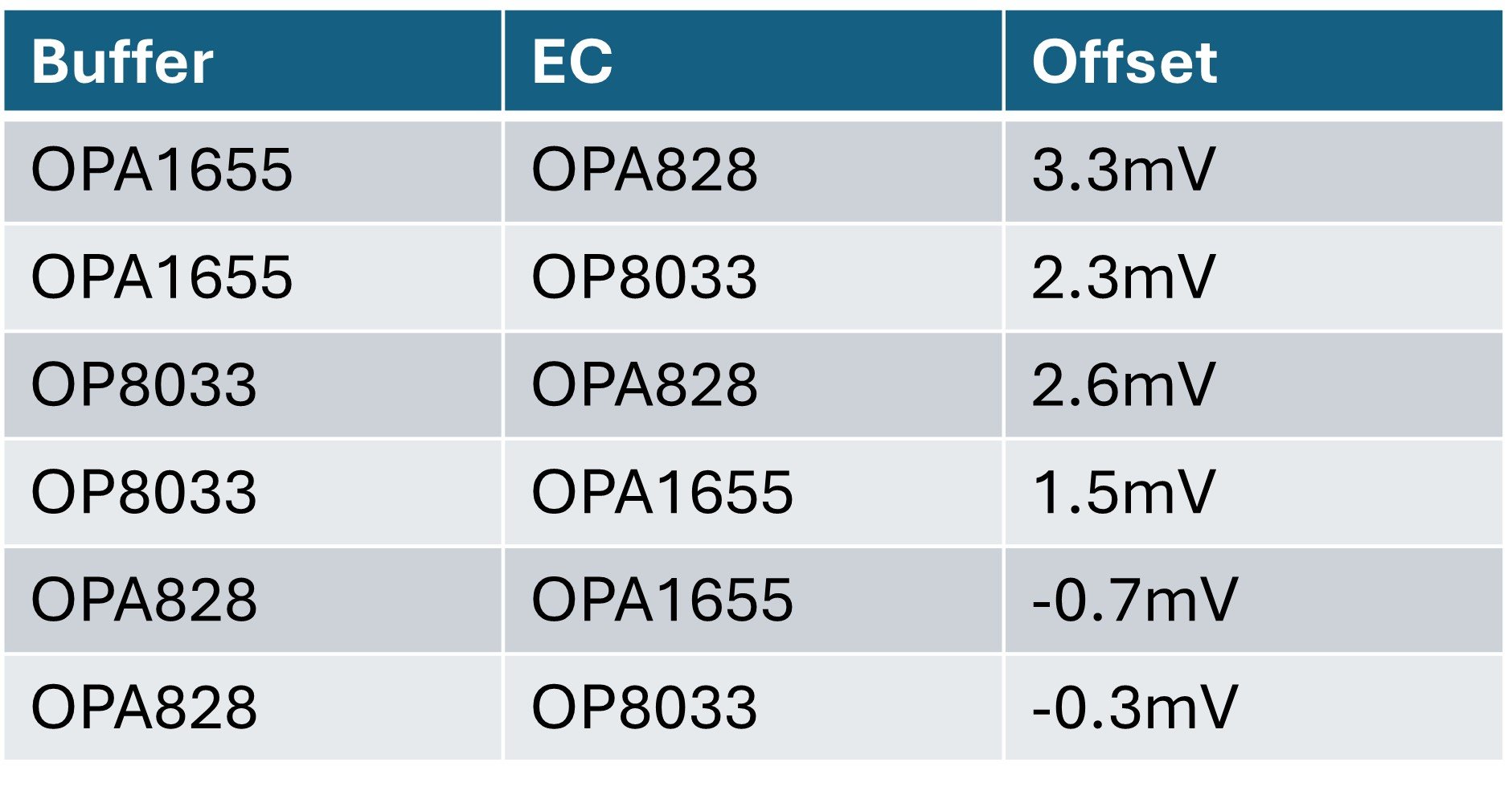

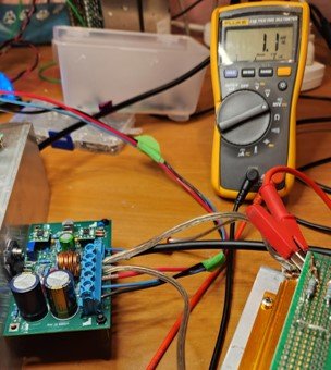

DC Offset
With capacitor C7 in place, the DC offset baseline is approximately 1.1 mV.
By bypassing C7, the amplifier becomes fully DC-coupled.
However, op-amps with BJT inputs are not suitable for this DC-coupled configuration due to unbalanced resistance and higher bias currents. For example, if C7 is bypassed, the OPA891 at the error correction (EC) stage produces about 0.1 V of DC offset. When used as a buffer, this offset can approach 1 VDC.
The best DC offset performance is achieved when using the OPA828 in the buffer stage.
If a few millivolts of DC offset are acceptable, the EC LM3886 can operate as a DC-coupled amplifier. This approach can be especially appealing to DIY enthusiasts who prefer signal paths without capacitors.

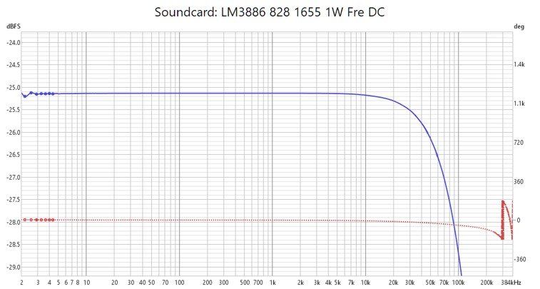

Frequency Response
There is no noticeable difference at high frequencies. However, at the low-frequency end, a difference becomes apparent — indicating that the amplifier now operates as a DC-coupled amp.

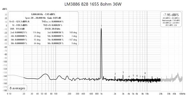

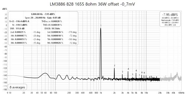

THD+N at 36W into 8Ω
(OPA828 as buffer, OPA1655 as EC op-amp)
The THD+N of the DC-coupled amplifier (0.00039%) is slightly higher than that of the capacitor-coupled version with C7 (0.00028%).
Surprisingly, the distortion becomes even harmonics dominant in the DC-coupled configuration.

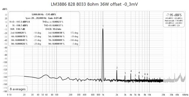

(OPA828 as buffer, OP8033 as EC op-amp)
The THD+N of the DC-coupled amplifier is 0.00037%, which is nearly the same as the capacitor-coupled version with C7 (0.00038%).
Distortion still isthe even harmonics dominant component.

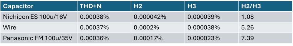

Bypassing a coupling capacitor shifted the distortion from being dominated by odd-order harmonics to even-order harmonics — completely unexpected.
The same audio source, the same ADC, the same signal line, and the exact same position... nothing changed, not even the environment.
I can't figure it out!
... completely unexpected ... I can't figure it out!
Fundamental question ...
How many cycles of the sinusoidal output are you analysing in the FFT and what is your sampling frequency ?
In order to get a proper FFT result, it is absolutely necessary to have an integral number of cycles. It may also help if the sampling frequency is an integral multiple of the test frequency, so that the above condition is easily satisfied.

With ~1k total load, the time constant is 100ms (1.6Hz). For lowest distortion you may want to go lower 10 times.
As for AC coupling, only the master OpAmp needs it, so you could try that, increasing load to 2k, should shift the harmonic profile a bit.
Personally I'd replace the 1655 buffer with a 1/2 2156 (basically the same OpAmp, but with rail-2-rail and more robust input, and much lower offset) and place the DC-blocker in its input where a few uF of film capacitor will do. And always to a reference distortion measurement at the buffer output

I think what he see is a macroscopic change, when shorting out the cap, in both configurations. The THD (as in Not THD+N) is jumping 20dB.. The second harm the most.
that means assymmetry somewhere.
A stupid question, but what is the offset in the audio source? If you have a non-negligible amount of offset at the input, in the DC coupling case it could be amplified, and introducing an imbalance all along..🤔
But be aware that the dac should be measured while actively spitting out digital zero, or very small level signal.. many dacs mute when not active.
