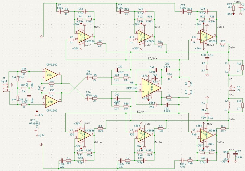

Any suggestions are welcome
This will be my last try with LM3886.

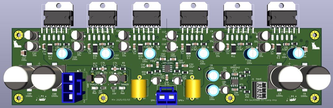

Shortly PCB for the circuit will be designed.

You'll want to rotate the inductors so they don't couple.
That layout sure looks familiar. Gee. I wonder what inspired that. 😉

4 layersis this 2 layers or 4?
It might be possible to connect the dots with a 2-layer layout. But keep in mind that you're trying to tame 21 A of output current while keeping any error currents well below 1 nA. That's likely impossible with a 2-layer layout. If you want performance you have to throw some copper at it.is this 2 layers or 4?

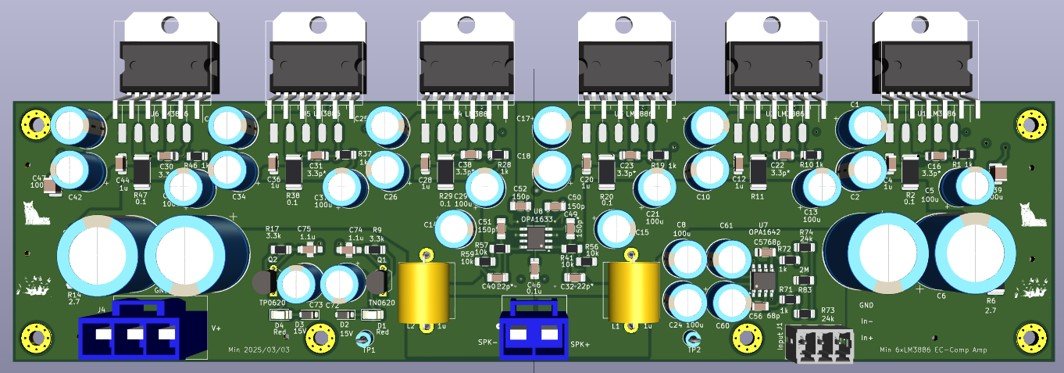

My take is SMD if you want to have the PCBA produced somewhere. TH if you are going to hand-solder them. With TH you can fit slightly larger caps in the same board-area as an SMD cap as well.SMD capacitors PCB and Through-hole capacitors PCB. Not sure which one to make yet.
I also did a version with mixed components. All Aluminum Electrolytic Capacitors are through hole.
For hand soldering, the smallest SMD components are 1206. All pads are designed for hand soldering, too.

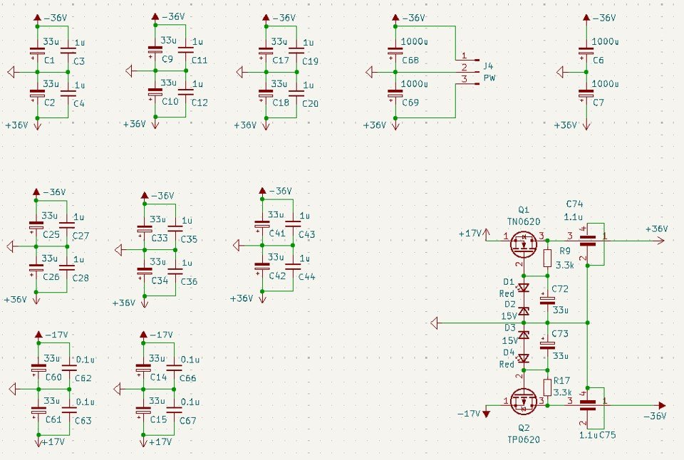

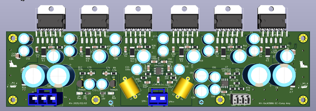

Another revision. 3 terminal linear regulators replace the cap multiplier. A power connector is added for some other uses, like speaker protection etc.
Not sure if you need any more miniaturisation, but 0805 / 0603 may also be hand soldered without consequence.For hand soldering, the smallest SMD components are 1206. All pads are designed for hand soldering, too.
