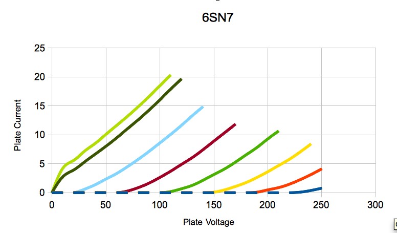

First trace
Collected using the hand wired test regulator, 10V plate steps, 2V grid steps, CSV output, serial capture, spreadsheet plotting.

Congrats!
How long did it take to collect the data (not counting spreadsheet import/plot)?
Jaz
Jaz
Congrats!
Jaz
That set went from -28 to 0 volts on the grid by 2V steps and 0 to 250V on the plate by 10V steps. 15 * 26 = 390 points in about 6 seconds. A lot of the time is in serial output at 9600, which can speed up a lot, and there is an extra 1-2mS per point delay. Conversely, there will need to be more stuff in the loop eventually but I'm greatly encouraged by this result. 100 points per second is my rough expectation for pentode plate curve generation, with about 1000 points needed for a good set of curves.

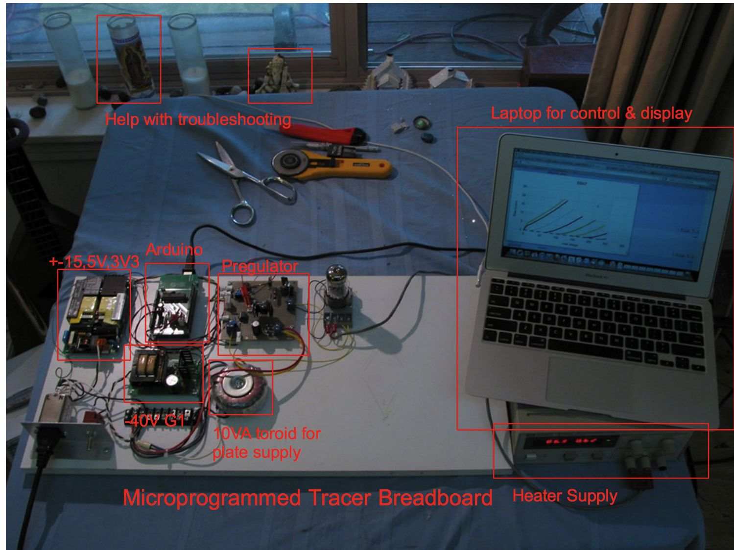

Here's the breadboard setup. I wired a programmable regulator with floating output and return path sensing, plus a simple grid driver consisting of a level shifted opamp. There is a small SMPS for the 3V3, 5V, and +-15V, a little 40V DC power supply for the grid drive, and a 10VA toroid for the 300V plate supply. Since the measurement only takes a millisecond, I can use a tiny plate supply with a storage capacitor to supply practically any plate current needed.
