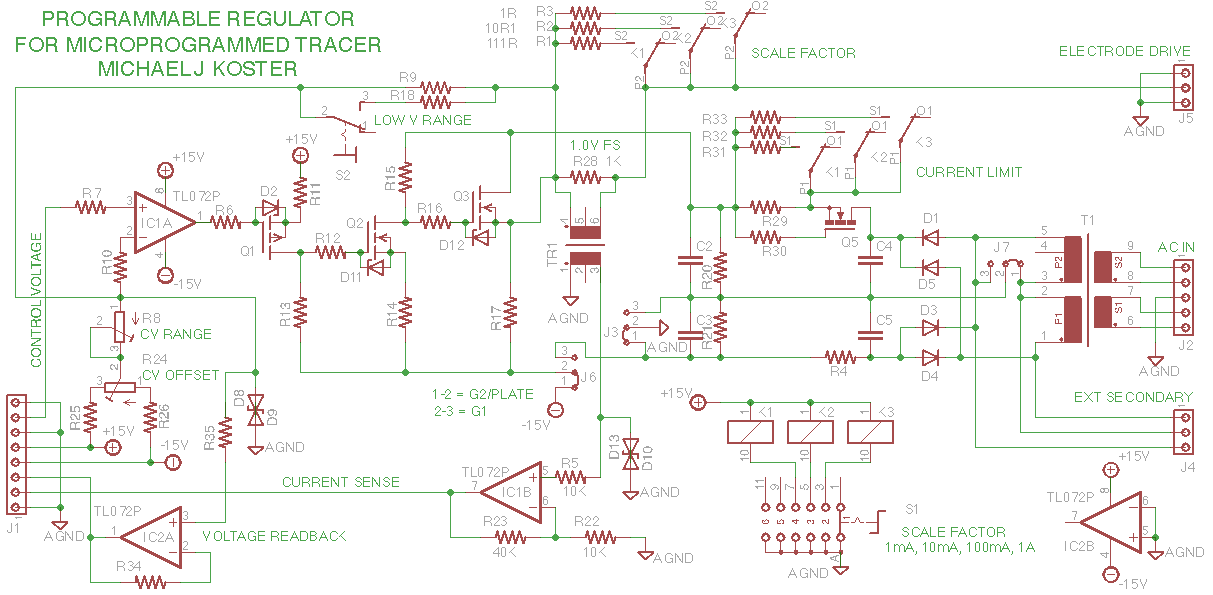

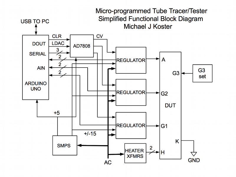

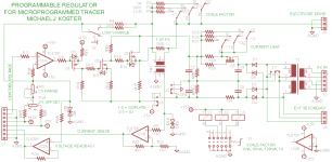

Here is a brief specification, updated block diagram, and HV regulator schematic. This is pretty much the state of the design as I build the first prototype.
Michael
Micro-programmed tube tester/tracer
Functional Specification
What is it?
A piece of test equipment used to measure the characteristics of vacuum tubes.
The tester is AC line powered and attaches to a PC via USB or Ethernet.
Internally the tester consists of a microcontroller and a set of programmable power supplies (see the attached block diagram) which apply test voltages to the electrodes of the tube being tested, and which measure the resulting inter-electrode currents.
The tester sends measurement data back to the PC for analysis and plotting. Simple functions can be implemented on the tester itself as needed e.g inter-electrode short circuit checking.

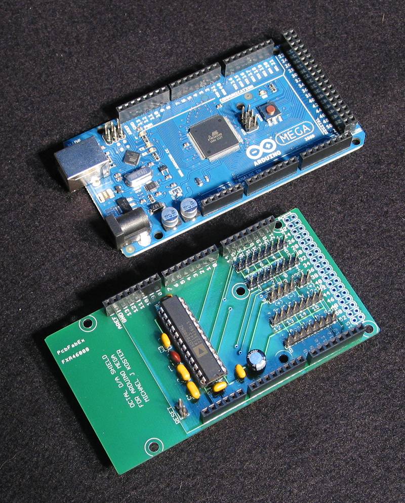

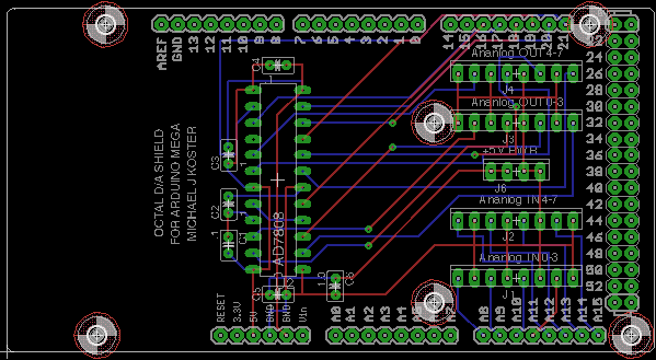

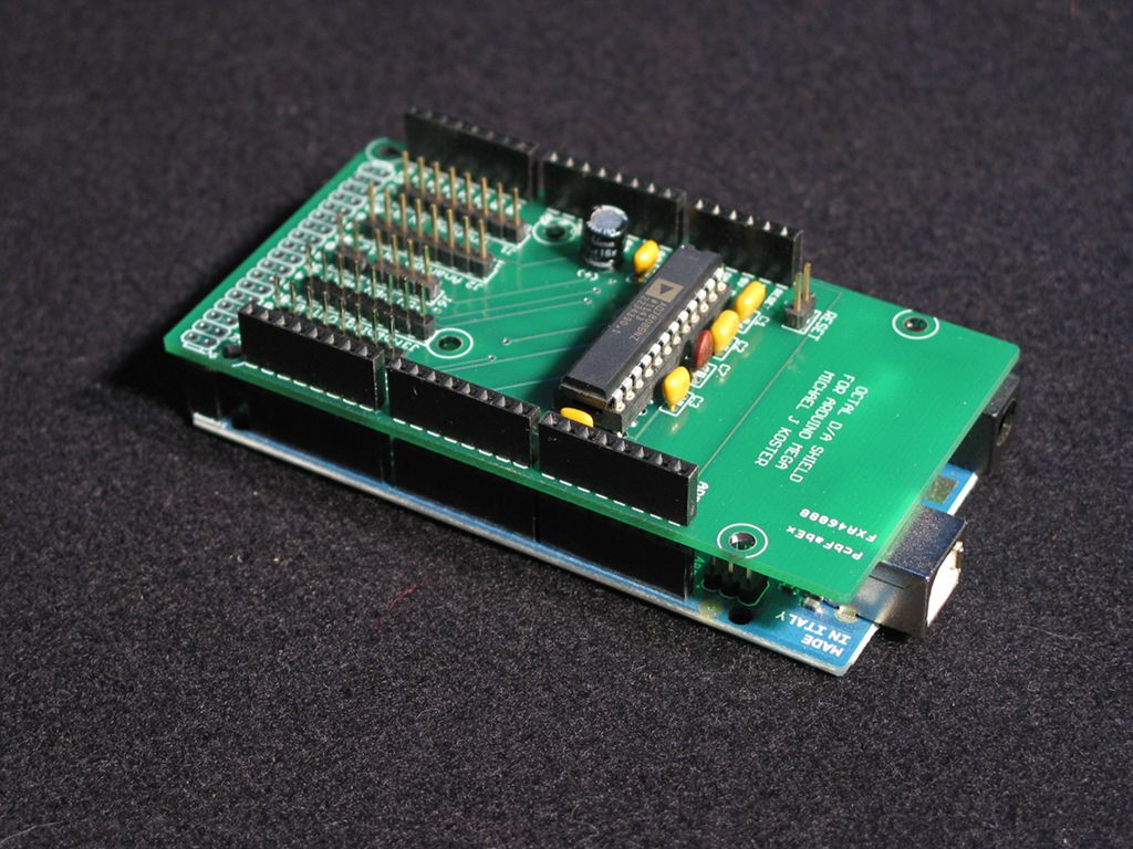

Microcontroller:
An Arduino Mega 2560 will be used for the initial prototype and reference design.
Arduino doesn't provide true analog outputs (only PWM is on-board) but has good support for serial I/O.
The AD7808 will be used to provide synchronized analog outputs to control the electrode voltages during testing. An Arduino I/O Shield will be constructed to carry the AD7808 and provide I/O connectors to the high voltage programmable regulator modules.
High Voltage Programmable Regulator modules:
Electrode voltages are driven by a set of programmable regulators, one for each electrode (plate, g2, g1). A control voltage from the D/A converter is scaled to either unipolar (0-600V for g2and plate) or bipolar output (-200V to +100V for g1). Each programmable regulator module carries it's own power supply including a small transformer and rectifier, energy storage capacitors, and voltage and current sensing circuits with protection.
The energy storage capacitors are sufficient to provide the rated electrode voltage from the regulator long enough to make a measurement (typically less than 1mS). The power supply is sufficient to charge the capacitor between measurement cycles ( ~ 1 to 10 mS ). For high current measurements, the measurement cycle time may be increased to allow the capacitor to fully recharge between measurements.

Hardware for initial embodiment:
Microcontroller:
System enclosure:
The initial prototype will consist of a metal enclosure containing the Arduino and D/A shield, three programmable power supplies, small SMPS for logic and analog circuits, and the following external controls and interfaces:
Rear panel:
Fused switched AC input module
USB interface for connection to PC
External heater supply input
Top panel:
Octal DUT socket wired for EL34
Test plugs for rerouting DUT pins and add-on socket adapters
Front panel:
Power switch
Power indicator
g1 current range selector (1mA, 10mA, 100mA, 1A)
g1 voltage range selector (-20V to +10V, -200V to +100V)
g2 current range selector (1mA, 10mA, 100mA, 1A)
plate current range selector (1mA, 10mA, 100mA, 1A)
Heater voltage selector (2.5V, 5V, 6.3V, 12.6V, EXT)
g3 voltage control (0 to -30V)

D/A shield
Here is a first cut design for the D/A component that plugs on to the Arduino board (called a shield in Arduino-speak). I provide a +5V power input, 8 D/A outputs, and break out 8 A/D inputs.
The connectors are amp MTA and break the signals out into twisted pair or coax.
Michael
Michael
I would recommend adding a 1nF cap on the Refout/Refin pin (Spec says 1-10), change the 1uF bulk storage to 10uF and add a 1nF to VDD as well.
I looked at the app note again and made the changes you suggest; thanks.
Here is the first PCB stuffed and ready to test, with the Arduino MEGA board it stacks onto.
I'll need to create some library code for the basic setup and operation.
